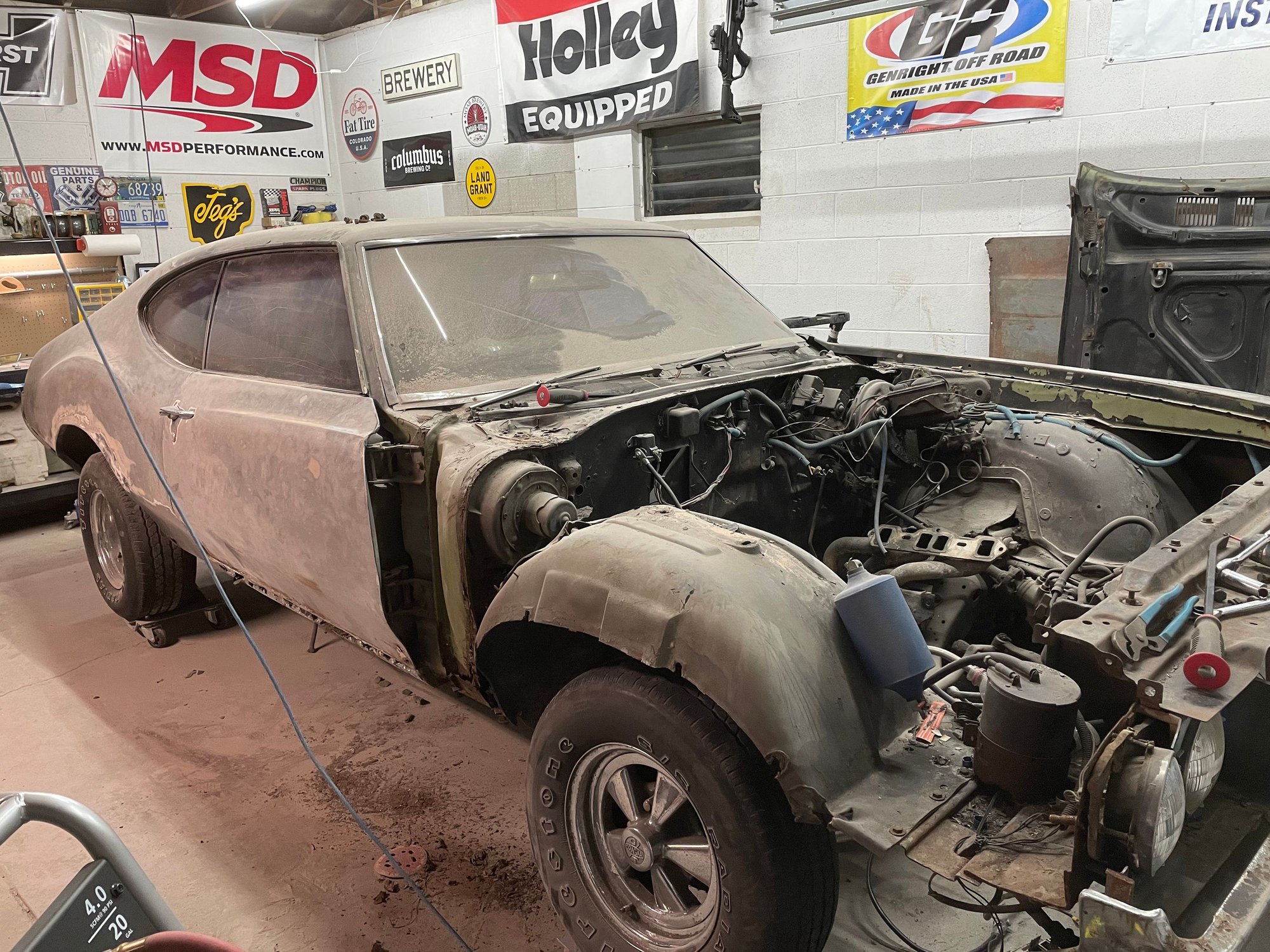

Hey guys picked up this 1972 cutlass has a 455 in it. Looking to bring it back to life. The car has been sitting for 20 years. This is my first project like this so I’m sure I’ll have questions.

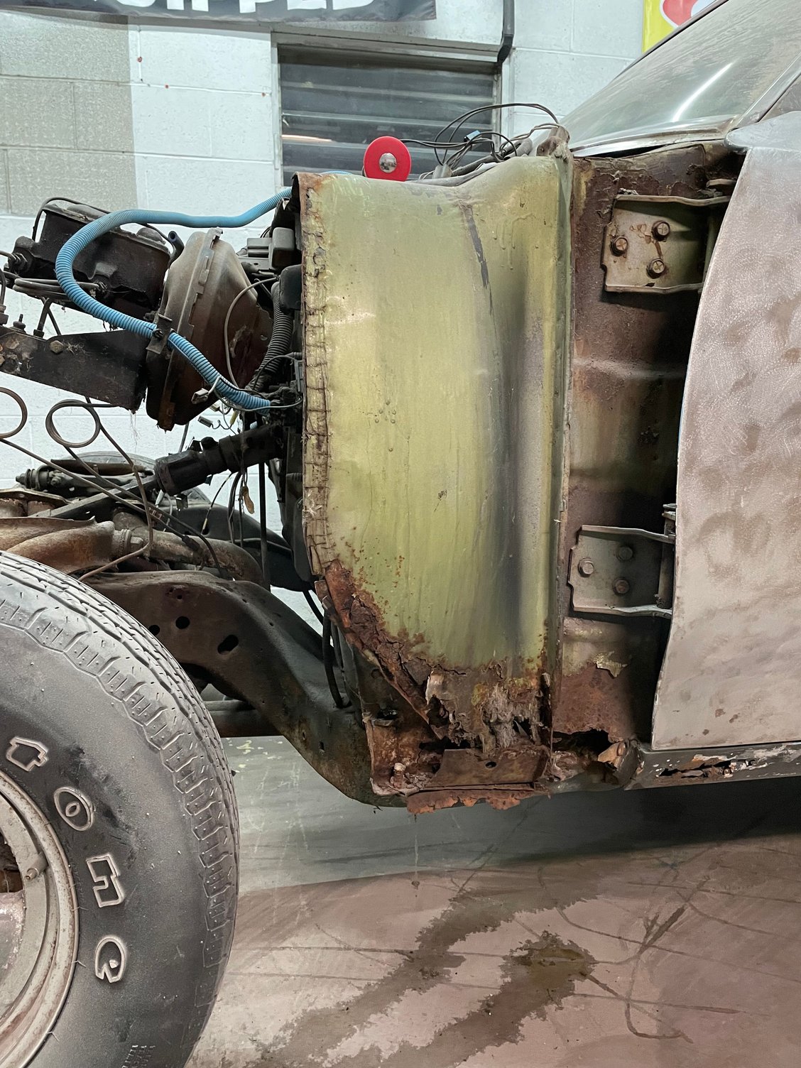

Was wondering what the name of this would be and if there are panels available to replace them. Would this be considered lower cowl panels? And also the door jam where it’s rusted out.

Welcome... I have not seen those offered as a reproduction piece, but that doesnt mean it is not out there.

You will probably need to make your own pieces to fix what you are looking at. Guessing you are good with a torch? I think you have a decent starting point. Frame good? I am digging the Cragers. What are your plans? Colors etc etc? I will be watching your progress.

Looks like a similar starting point to the car I got with my vista cruiser except mine was a 350/350 car before I made it a 455/ 4 speed.
Here is a link to cowl side repair panels:
https://www.opgi.com/sheet-metal-bod...h27102-pr.html

Nice will be keeping up with your build. And thank you for link that exactly the part I need.

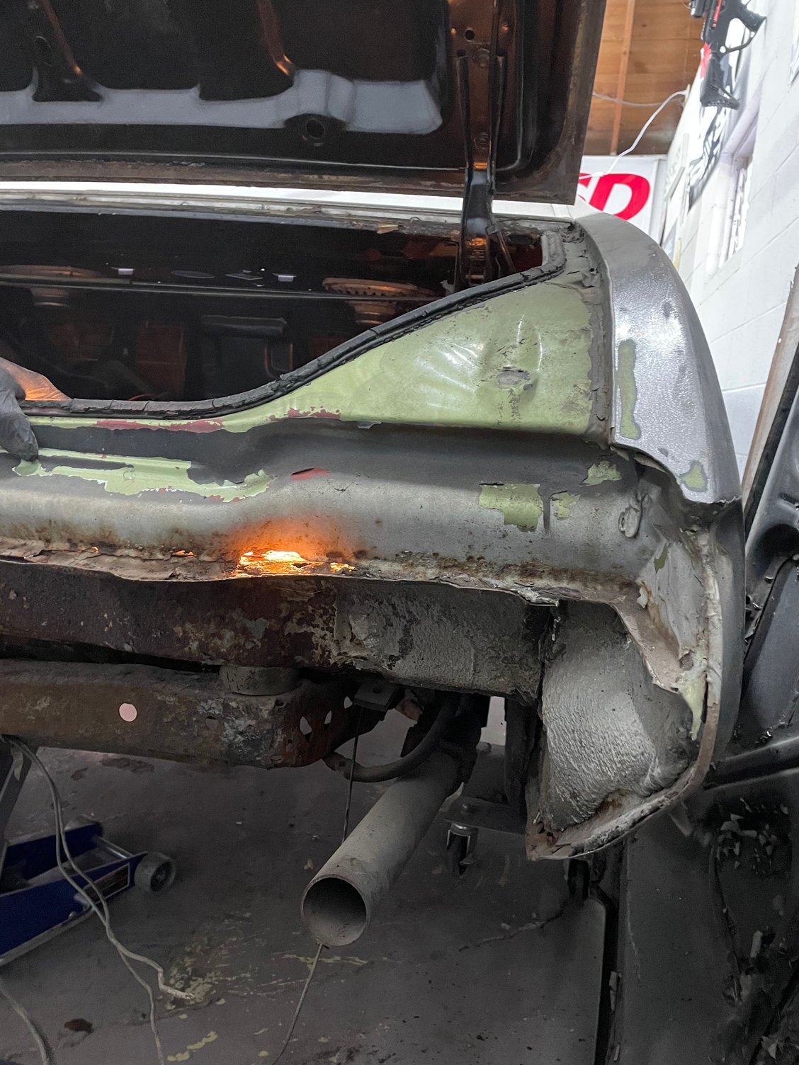

Help guys
What panel would this be is this considered trunk floor? Tail light panel?. You can see in the picture I am shining a light so you can see the light through the rust holes I’m referring about

the front firewall and cowl pieces are readily available multiple places, I know OPGI carries most of it, I have never seen a reproduction of that rear area though, you will have to find a donor car or hopefully your good with metal, i had to make patches for my car in that area. I had to replace both shoulders on the cowl like you are showing, i also had to replace the inner structure which was also available. Good luck looks like a good project!!!
