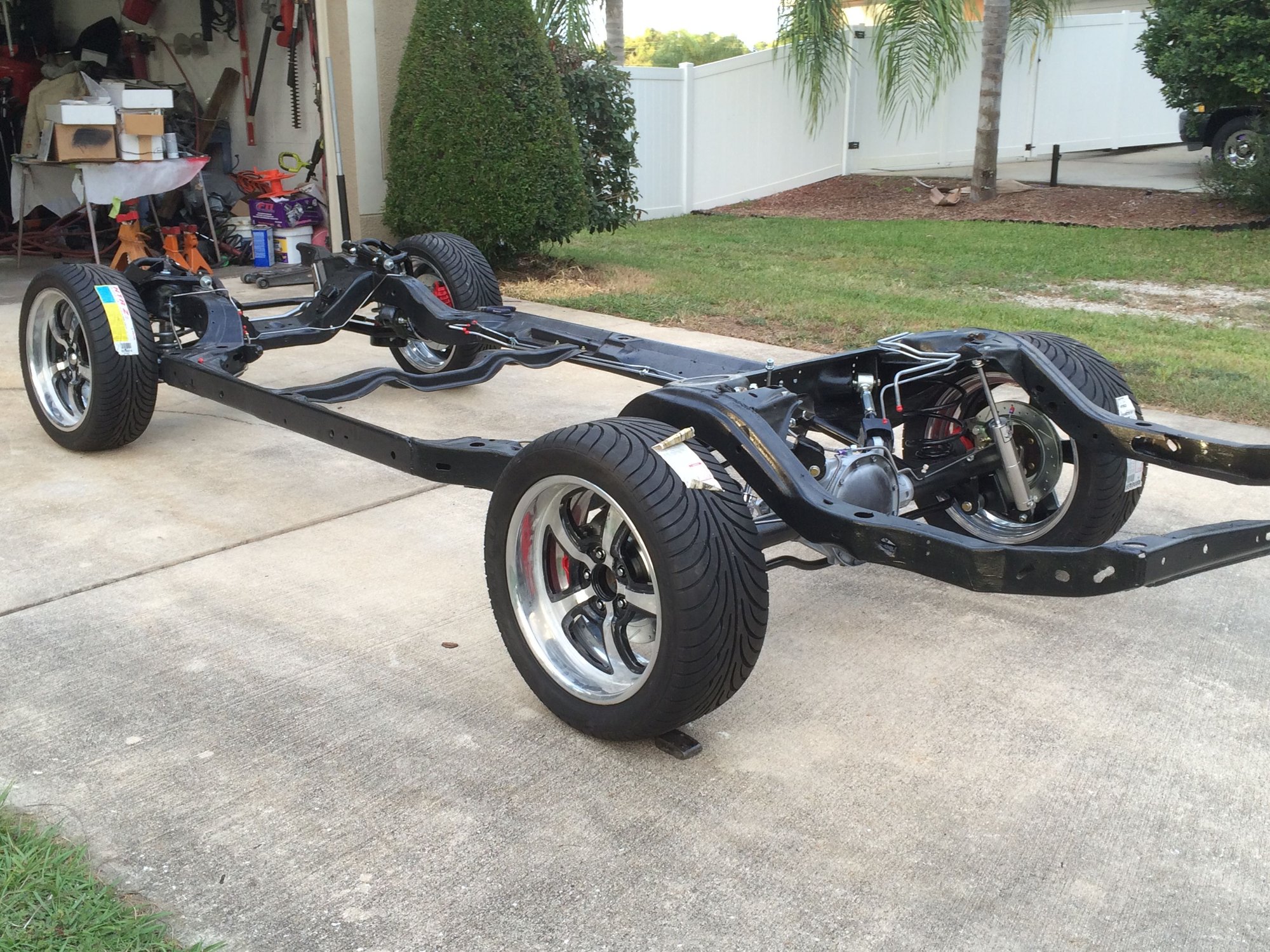

The build is as follows...
Stock 1970 low mile Toro 455 iron E Heads home ported. Mark Remmell helped with the hydraulic roller cam and head work. Stock bore. Sean Murphy stage 2 Quadrajet
Performer intake, Headers
Vintage Air
Turbo 400 with FTI 3000 stall and GV overdrive
3:42 Posi
C5 Disc brakes Kore 3 brackets
UMI rotojoint upper and lower adjustable control arms 1" sway bar
Viking adjustable shocks with front coil overs.
Hotchkis control arms 1.25 front sway bar
Iroc steering box
18x7 front 18x9.5 rear Intro Wheels
235-40-18. 275-40-18

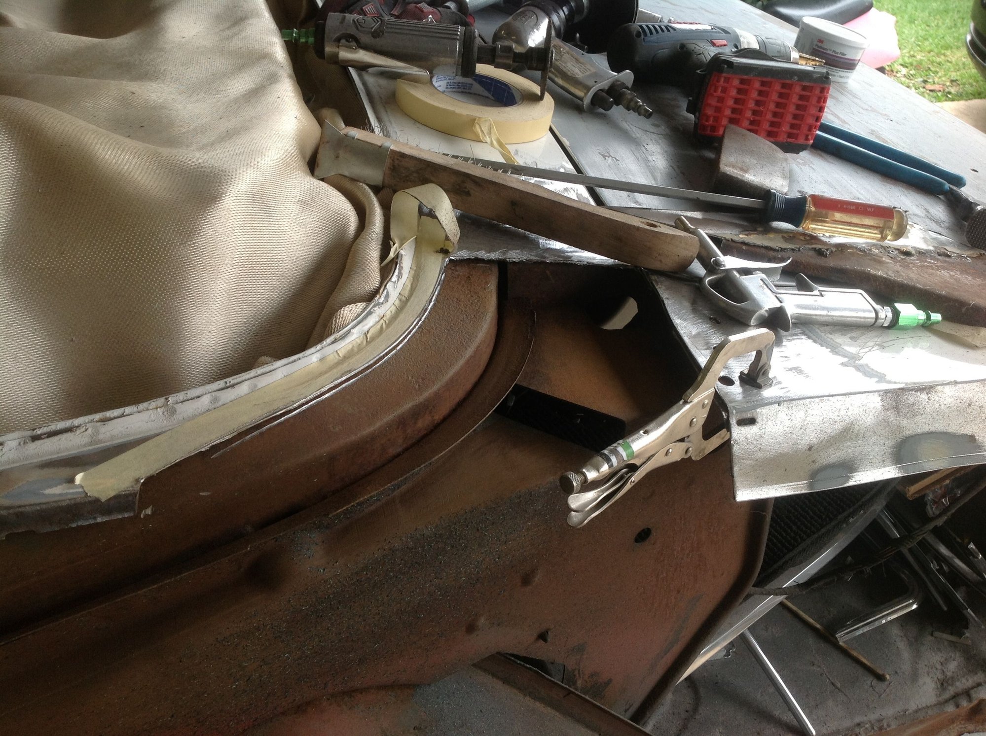

Doors looked like they got run over with a Delta 88
After a whole lot of metal work and a skim coat of filler.

wow great work so far love the HO and resto mod combo.
wheels look really nice too all parts choices seem well thought out
what advantage does the coil over up front offer over the traditional shock in spring ?

Thanks guys! RetroRanger, I lowered the rear 1" when I get it all together the coil overs give me the ability to set my ride height and stance easily.
ahh i see very nice then. Do / did you need to reinforce the shock mount area on the LCA or is it stronger on the after market arm ?
Old Nov 20, 2015 | 02:46 PM
ctosiflying's Avatar
Joined: Dec 2009
Posts: 223
From: Enterprise , Florida
No. It's stronger on the AM arm. It's plate not stamped steel.

Waiting for the spring ps to settle.
I know...w27 on a 1969? Hell Yeah!
Finally going back on the frame.
