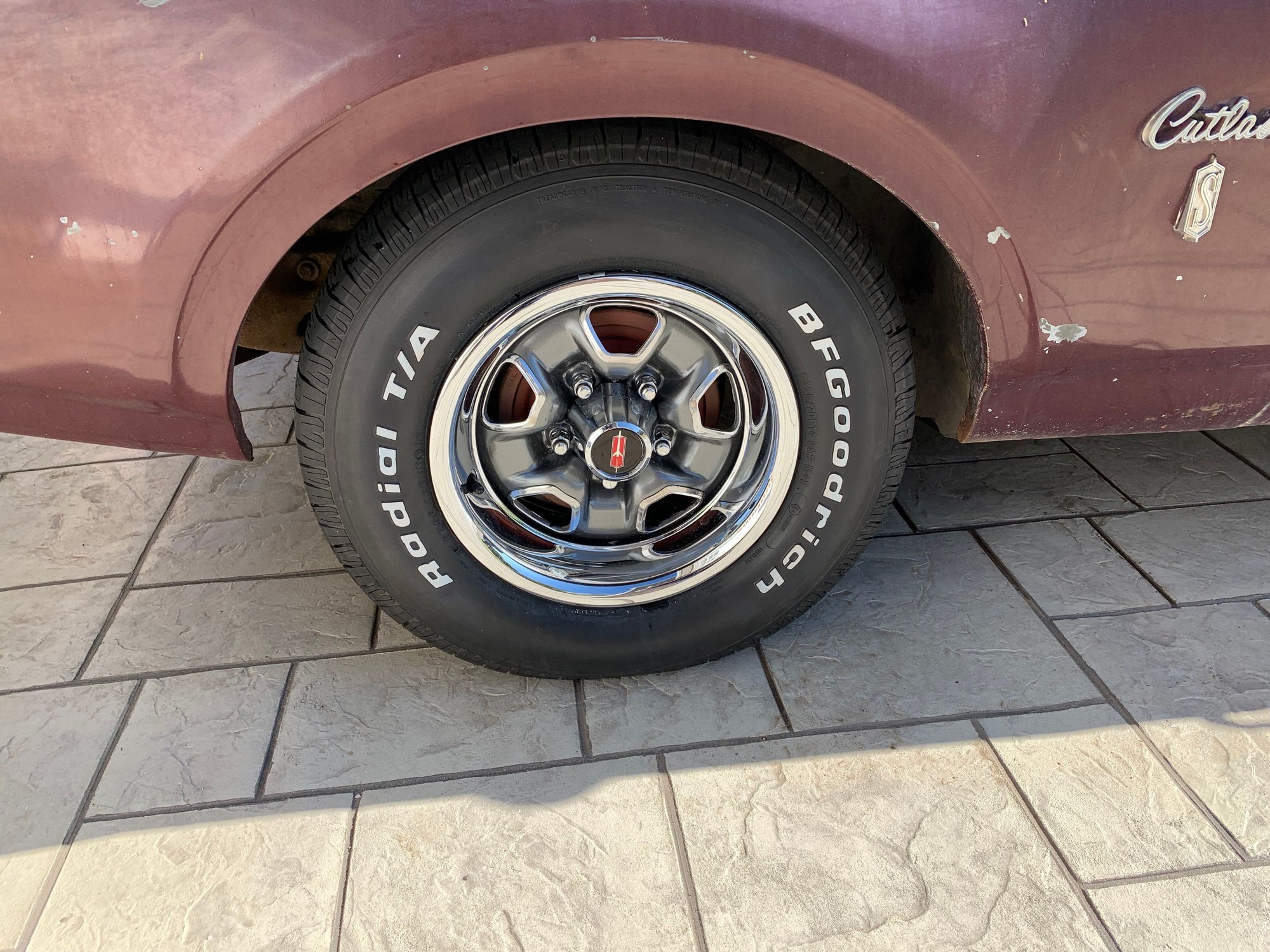

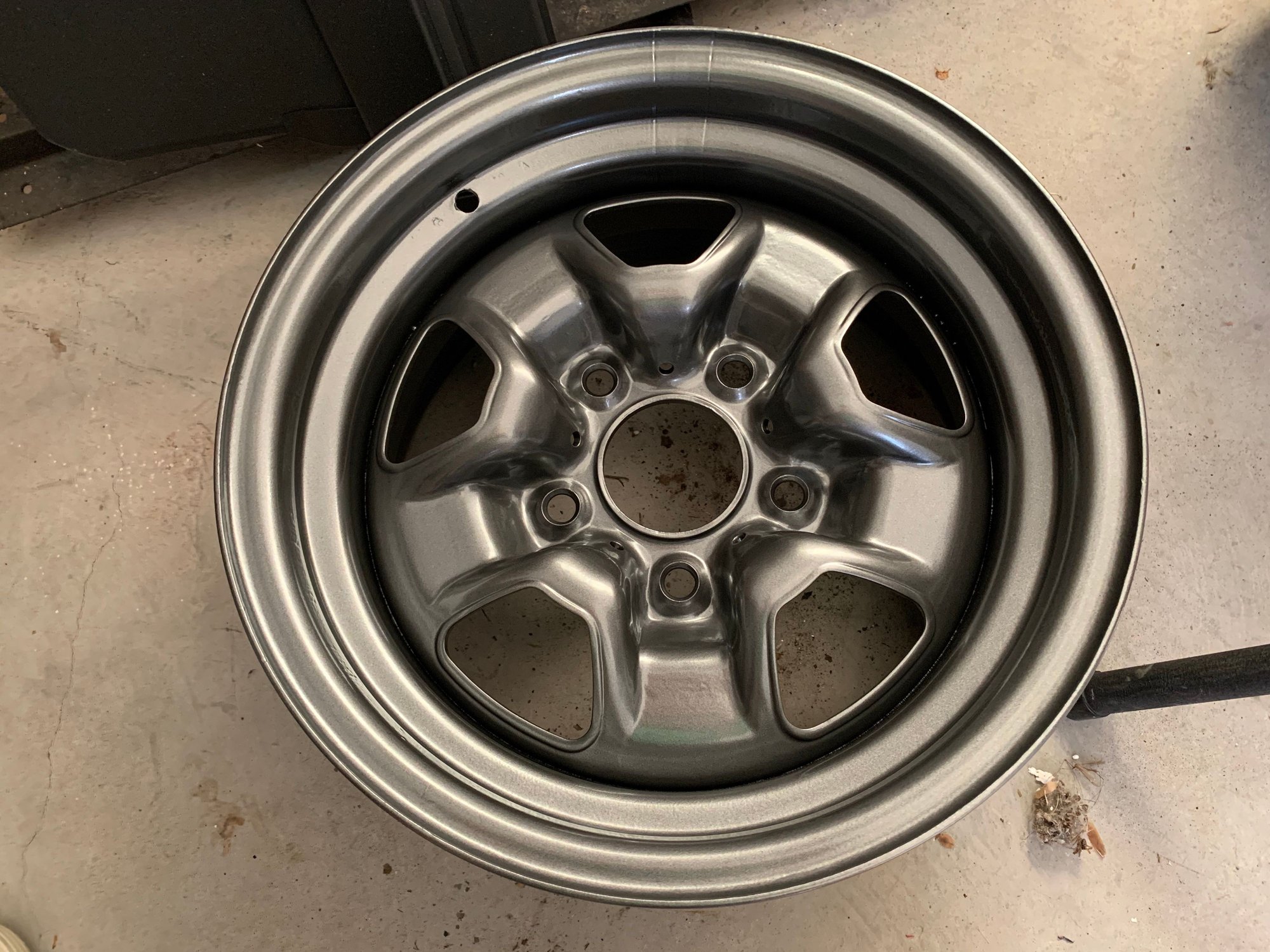

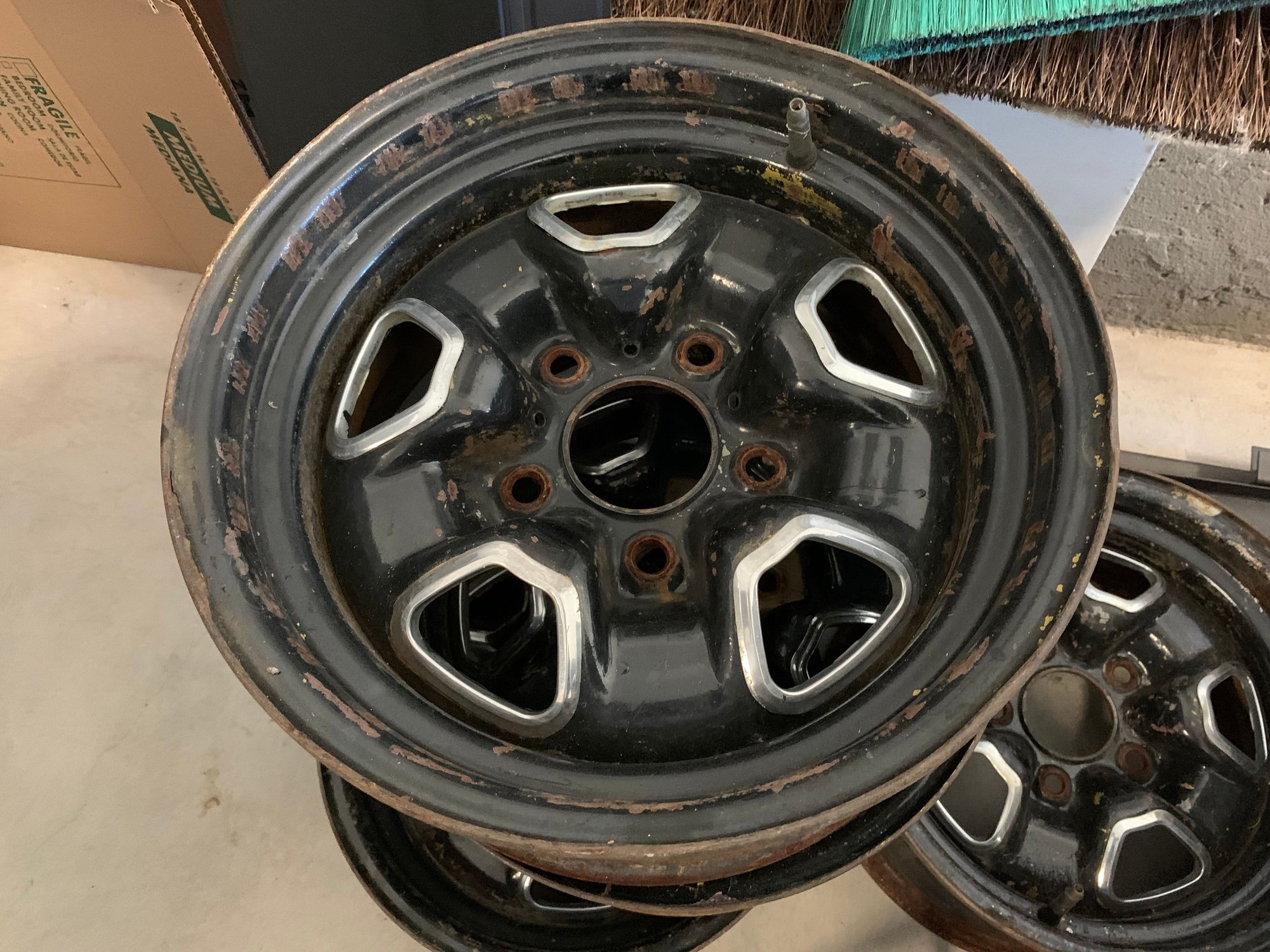

First order of business was to restore the set of 14x7 SSII wheels that I also bought from Dave442 and get street worthy tires on the vehicle.
I took the wheels to Unit 14 Powder Coating in Plano, TX, to have the wheels stripped, blasted and powder coated. I am not sure of the brand of powder coating that they use, but the color was called "Argento" and seemed to match the "Prismatic Powders Forged Charcoal" sample that they had on hand which I found mentioned in another thread on here. Since the Prismatic Powders would have been $50 extra per wheel, I went with "Argento" in their standard brand, and I am happy with the results.
I had to order new center caps and a few replacement trim rings from eBay and beauty rings from OPGI, but I think that the new BF Goodrich Radial T/As in 225/70-14 look pretty good on the car now.
Before
"Argento" powder coated

Old Oct 5, 2020 | 11:54 AM

The wheels turned out very nice and is a big improvement to the car. I like the current color of the car with the tan top. Would look great with a tan interior. But it is your car and money and you should do as you like.

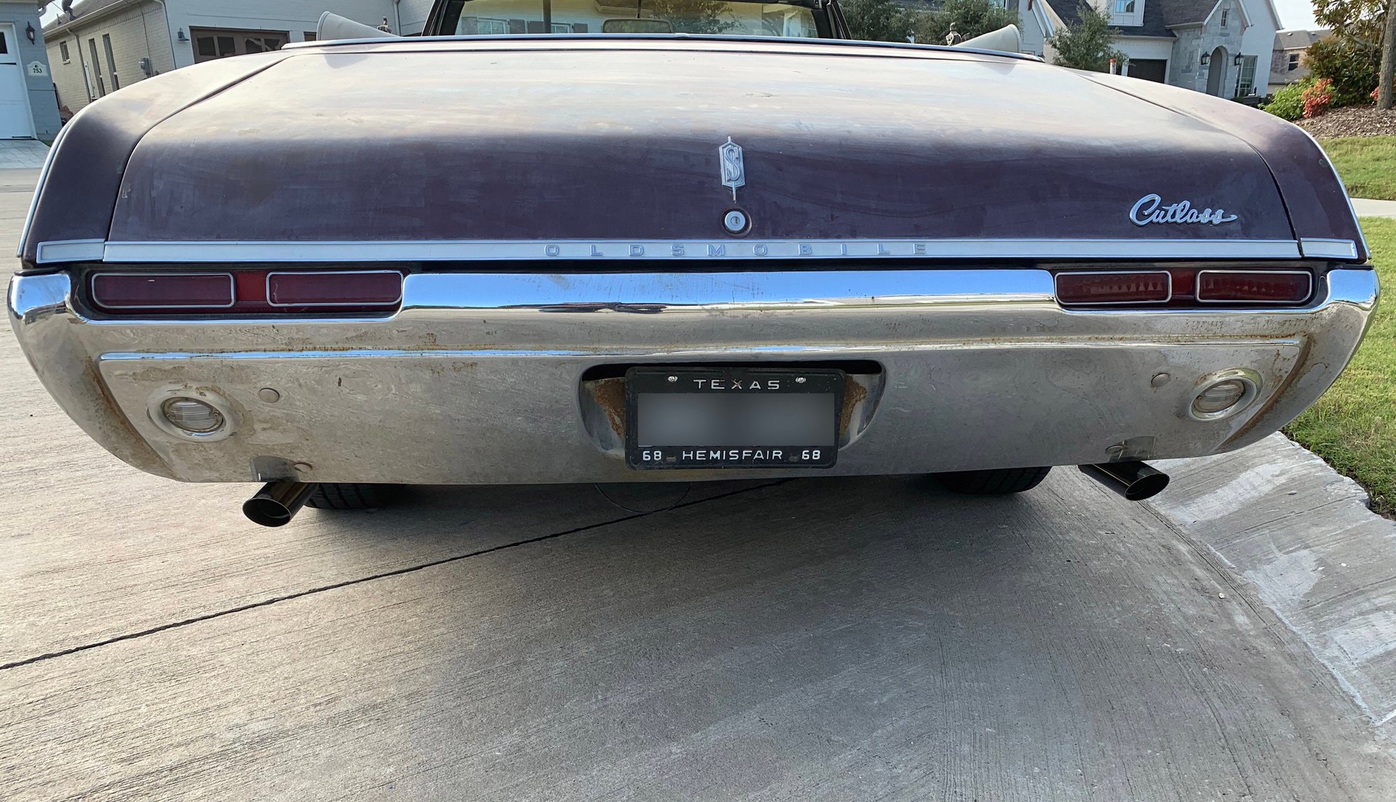

Alright, it may not seem like much, I passed a major milestone - my Cutlass is now street legal and fully registered and tagged. I found a nice set of classic 68 Texas tags, and I upgraded the exhaust to duals and went with Flowmaster FlowFX mufflers and short chrome tips. The car has a proper, dual exhaust rumble now. I would say that there is very little droning at cruising speed, but it is probably loud enough under hard acceleration to annoy my wife. Haven't confirmed that yet.
On the engine side, I replaced all of the plugs, wires, cap, rotor and points. The car is running pretty well most of the time, but every now and then it will die at a light and require me to crank it with my foot to the floor to get it restarted. I know that the 2bbl carb really needs to be rebuilt, but I hate putting any time, energy or money into that carb when I plan to swap it in the near future for a 4bbl. I may have no choice, though.
I also changed the filter and gasket on the Jetaway, but it is still puking fluid from the front seal. Luckily I have an appointment next Monday to get a TH350 installed.
1968 Texas "Hemisfair" tag

the argento looks great on the wheels
