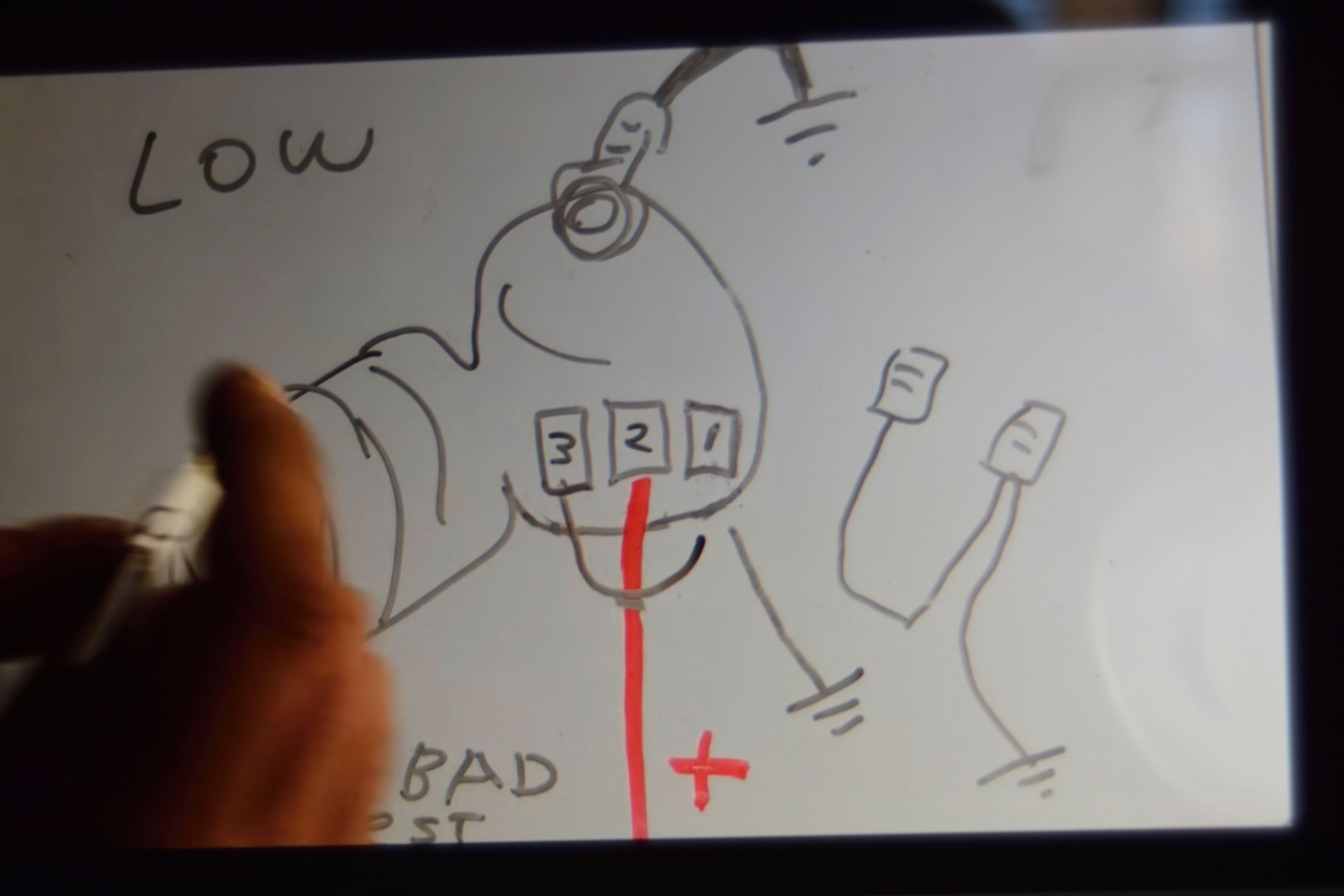

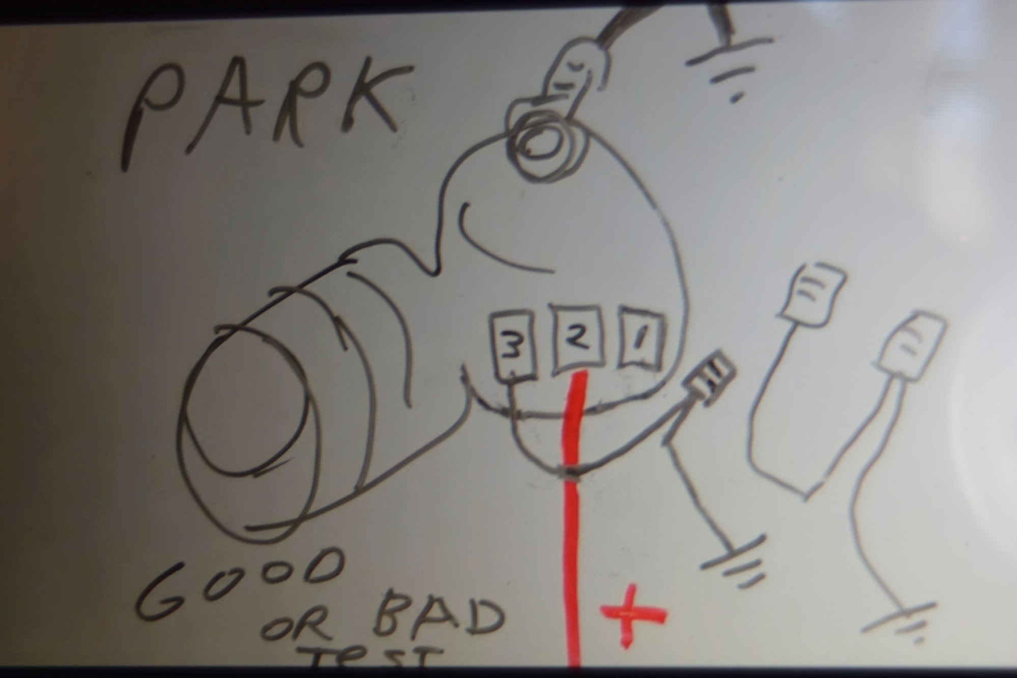

The starter seemed to be on its' way out. When I turned it over I got the clank miss and after a couple of clicks it would start up. It did it for a couple of days when I was moving it in and out of the garage. After awhile it stopped doing it and has been starting fine since. I think the bendix spring was getting stuck from not having been used for a long time and eventually freed itself up. I still might give it a good spraying with brake cleaner and clean all the connections.
The second day I had the car my neighbor came over to check it out and when I opened the hood to show and hear the engine the wipers started working on their own and wouldn't shut off, I had to pull the fuse to get them to stop. (I'm not really good with auto electric especially when it comes to tracking down a problem but I'm learning real quick with owning this car.) I went on the web and researched to try and figure out what was wrong with it. I found a couple of videos that showed how to test everything and downloaded a diagram of the electrical system. The **** on the switch came off in my hand when I turned it and saw what was broken, I tried to fix it with some JB Weld but it wouldn't hold so I ended up getting another switch.
After doing all the testing of the wires and motor it looked like I was going to have to get a new one because the motor failed the test. I took it out and did a bench test and it failed that too. I wanted to exhaust all possibilities before I gave up on it so I took it to an armature place that fixes motors. The guy asked me what it was and as soon as I said it was from a 61 olds he said "forget it, I don't work on that old stuff anymore". I thought it was strange because I looked around the shop and all I saw was motors on shelves, alternators, generators, starters etc.. The replacements are pretty costly even for a rebuilt one as many of you know, so I took it home and took it apart figuring maybe I'll get lucky and figure out what was wrong with it and if I couldn't oh well at least I gave it a try.
There was nothing jammed up in it and the solenoid worked when I put power to it. I dug in further and took the motor case apart and discovered one of the springs that hold the brush in position had split in half and one half was floating around inside. And that's all it was. I replaced the spring and gave everything a good cleaning while I was in there, cleaned out all the old grease, put in new grease and oiled the mechanisms. If you remove the plastic gear inside the motor housing for cleaning or whatever be sure to make note of its' position.
I didn't have good luck with the washer pump though, the bellow was shot and a replacement was nowhere to be found. Rather than go nuts trying to find one I decided to go with an electric one. I removed the spring and bellows and closed it back up.
I put everything back together, painted it and reinstalled it in the car. Later when the electric washer pump showed up I installed it and wired it into the wiring for the washer in the wiper motor. (the instructions that came with the pump weren't helpful) I replaced all the hoses. When I tried it out it was so powerful that the nozzles were shooting the fluid up and over the back of the car. I discovered the tips of the nozzles can be turned to change the location of where they hit on the windshield. A helpful tip if someone needs to take there's out, the vent cover slides out from under the stainless trim, there's no need to remove the trim. The mounting screws might be covered over with undercoating so you might have to poke around to find them.
I was going to upload some photos but it seems that my computer is throwing my pictures away or I did by accident. There's a photo of the motor opened up on the web but I didn't want to place it here in case of copyrights. Some diagrams a guy made for testing the motor and he said feel free to copy them.
Different motors for different models.
Wiring for bench testing with a switch. Although for a chevy it's basically the same for Olds. When I wired the electric pump I spliced the red wire into the yellow wire and the black into the purple wire.
He made a jumper wire as shown to the right and has it connected to the motor in this position to test for low speed. Leads are on #1 & #3
He made a jumper wire as shown to the right and has it connected to the motor in this position to test for high speed. Removed the lead from #3
He made a jumper wire as shown to the right and has it connected to the motor in this position to test for park (bringing the wipers to their stop position). Put lead back on #3 and remove it from #1

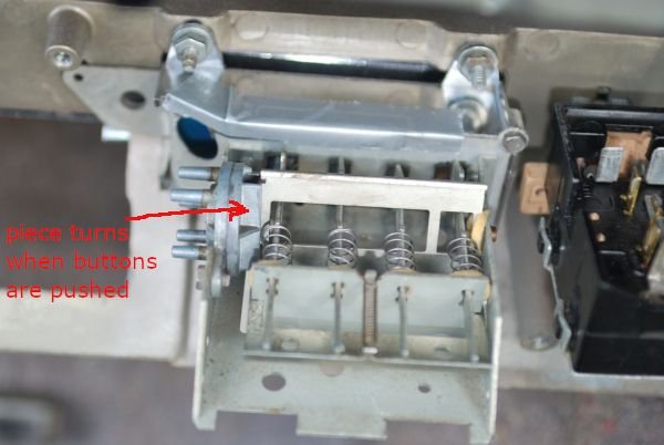

The summer ventilation buttons wouldn’t push in except the off position. Later when I had the dash apart I found where the vacuum hoses go into it and the mechanism was frozen. I pried on it a little and it freed it up. There is a felt pad held in by a clip that is I believe is supposed to be oiled. It’s the first oil that thing has seen ever. I did the same thing to the heater side and it made that work much better.
Routing vacuum tubes.
I replaced all the vacuum lines just to be sure there will be no leaks.
