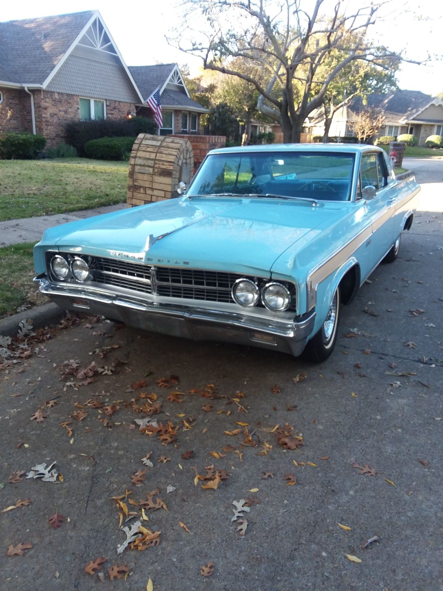

This is my new thread to follow along with and learn. I recently purchased a 63 Starfire with factory AC that appears to be an original 36K mile car. Although some components maybe a bit different than a 64. My car could be a resource for pictures or certain things...for you and others. Let me know if I can help.

No private acquisition. I had the car shipped from the owners dry storage unit in California.
