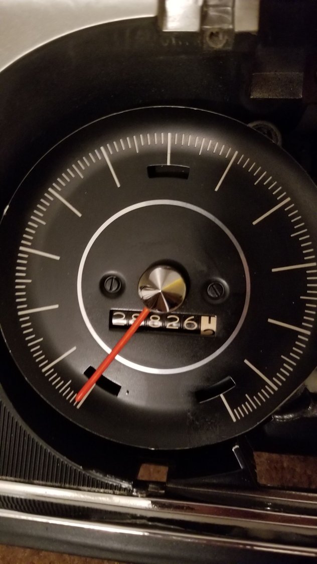

Even the tiniest tiny paintbrush was too big to fit into the grooves. I had to lay the paint on top, let capillary action draw it down, then wipe the top off, only doing a couple lines at a time so I could wipe the paint off before it dried. I took a picture of before and after side-by-side, but the picture didn't come out as well on my computer as it did on my phone.
My dash badge didn't come out as well as I had hoped. I probably should've gone with flat black instead of gloss.
Transmission needle came out well after a couple of thick coats. Still not sure if I want to try the needles for my speedometer and gas gauge.

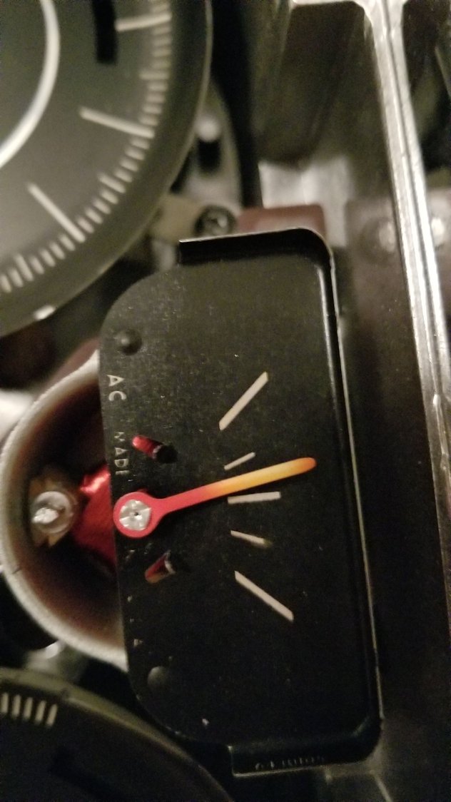

The needles in the instrument cluster shouldn't be difficult in general because I can just put paper behind them to keep excess paint from falling on the faces. It's keeping paint off of the hubs that worries me.

You did a great job on the letters. Tape the center hub on the instrument cluster needle with Scotch Magic Tape to protect them and give a sharp line. Don't pull the tape too soon or it might not give a sharp line between paint and hub. Practice with just half the needle and time how long to pull the tape..

Fuel gauge needle only needed one coat.
Speedometer needle needed two. Got a little bit of overpaint on the hub and had to scrape it off with a sewing needle.
I touched up some scratches on the faces of the speedometer and idiot light panel while I was at it.
