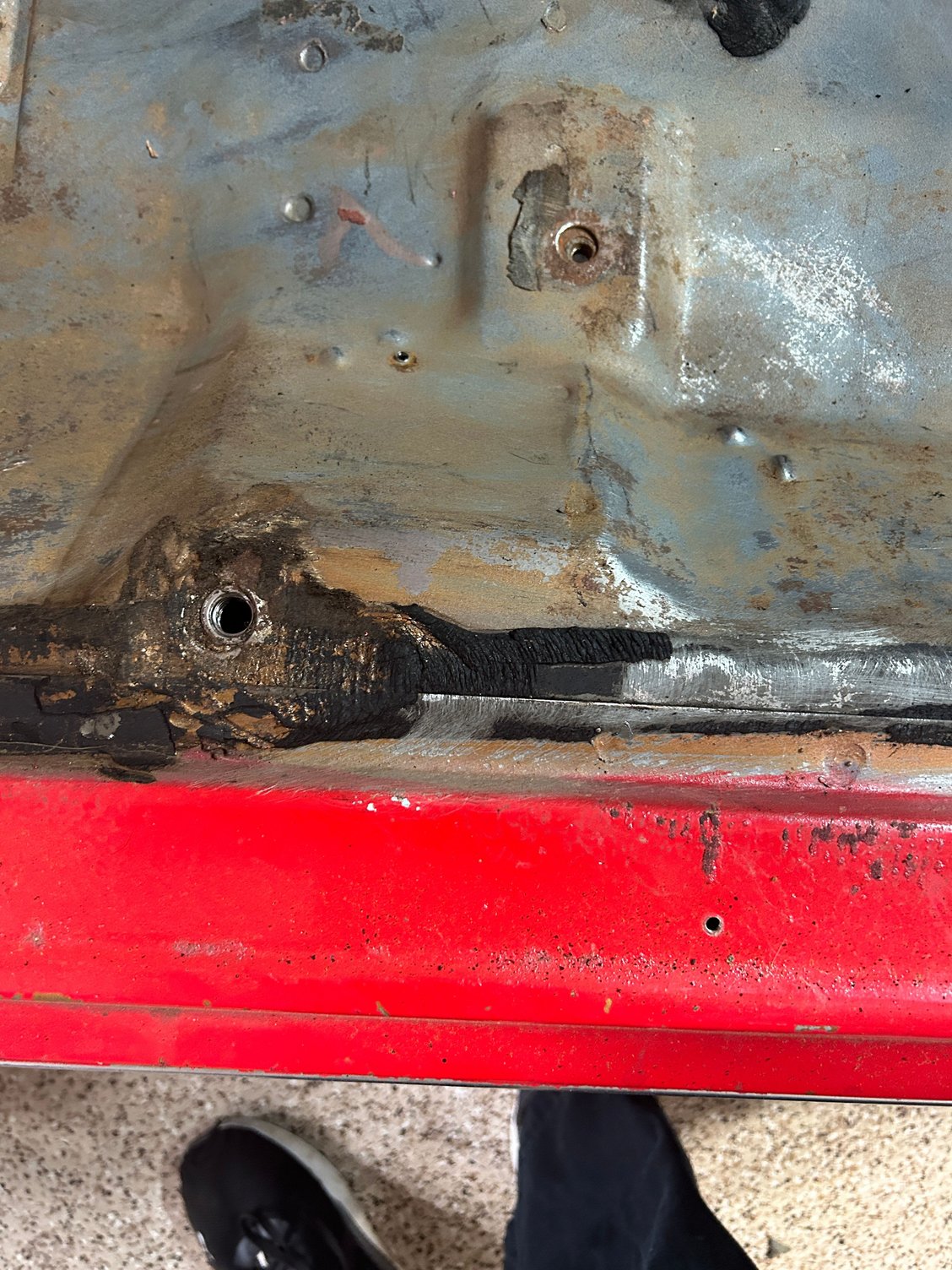

What started out as a "simple" project to replace the center speaker in the dash has turned into a full-on interior makeover. I mean pulling out the seats, carpeting, dash, heaterbox and A/C unit, and replace the original wiring harness on my 1972 Cutlass Supreme Convertible.

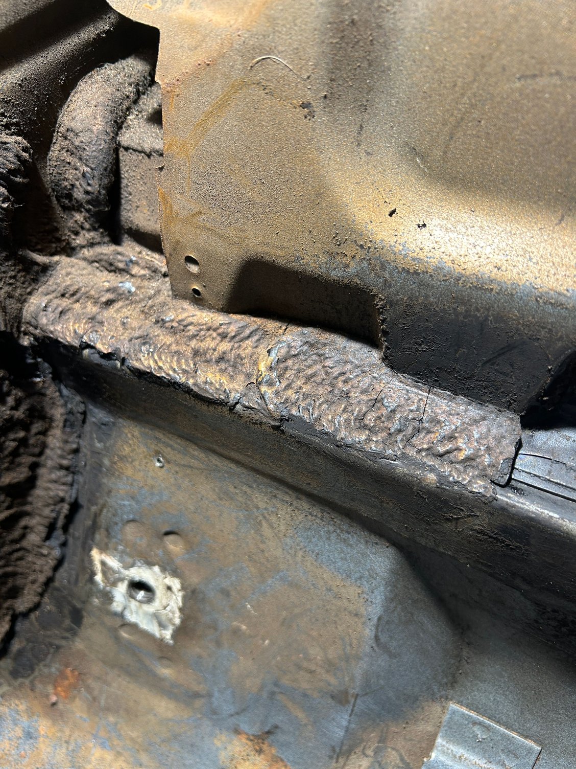

As I start to prep the floor pan for paint I have this black sealant material that is used to seal metal seams and my guess, prevent moisture from entering the interior of the car. Please refer to the attached photos.
What is this stuff and where can I get it to replace the old and cracked material I'm removing? Is there a modern version of this material that I should use? Thanks for the help.

I used the Eastwood Brush on Seam Sealer.

Please don’t be offended, but I laughed at this. It’s a convertible. Moisture has other ways of entering the passenger compartment. But as Norm said, seam sealant is the stuff.
