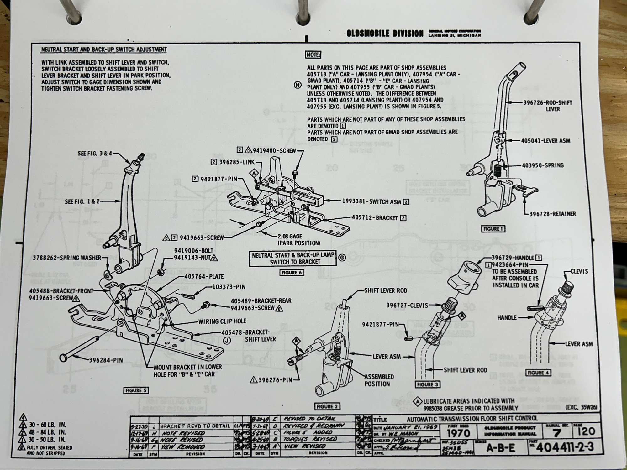

Where can I find the diagram on how to tear down and reassemble my shifter for cleaning?

Year and model would help. Automatic or standard?

1970 Cutlass Supreme, Automatic
