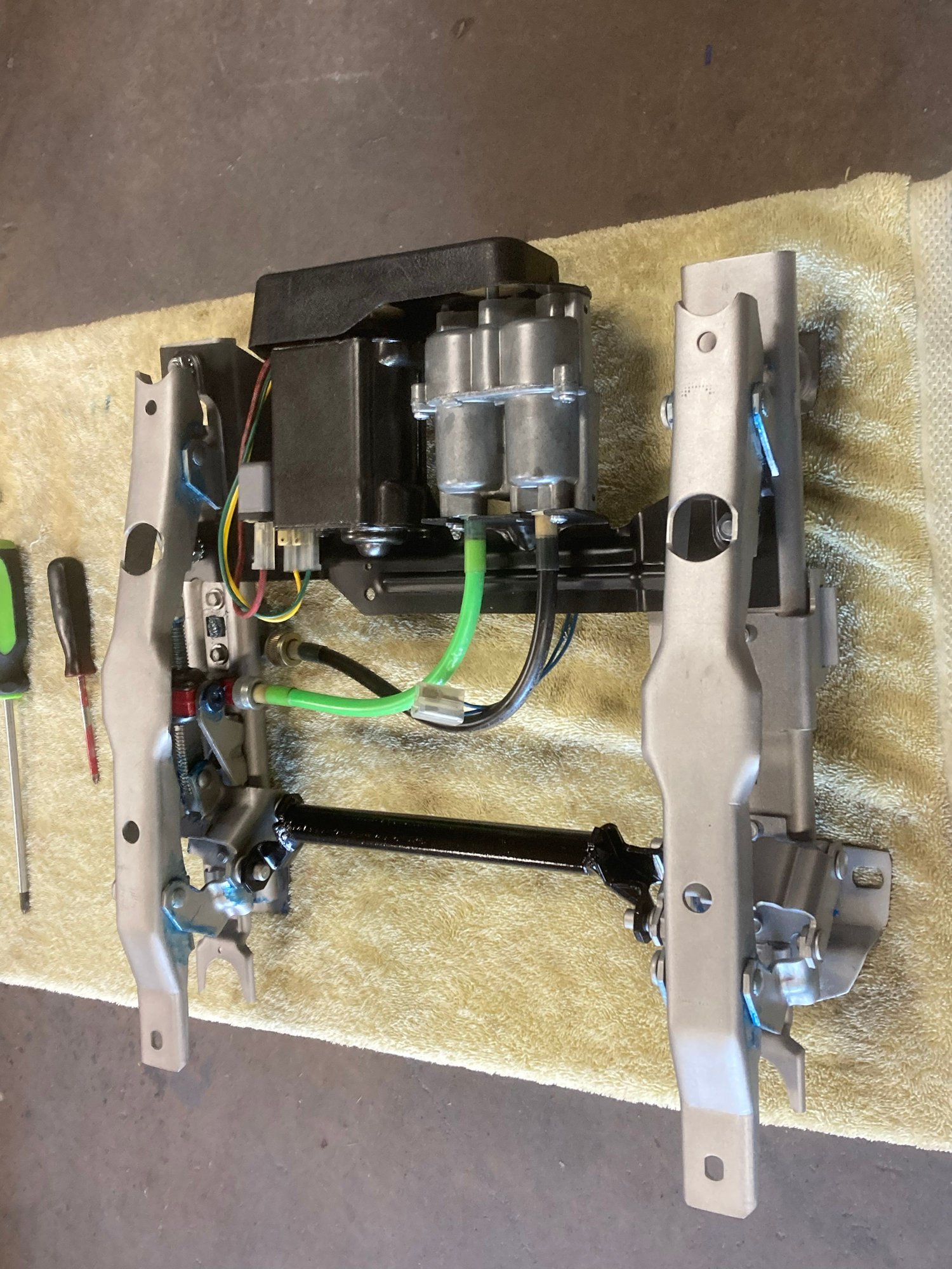

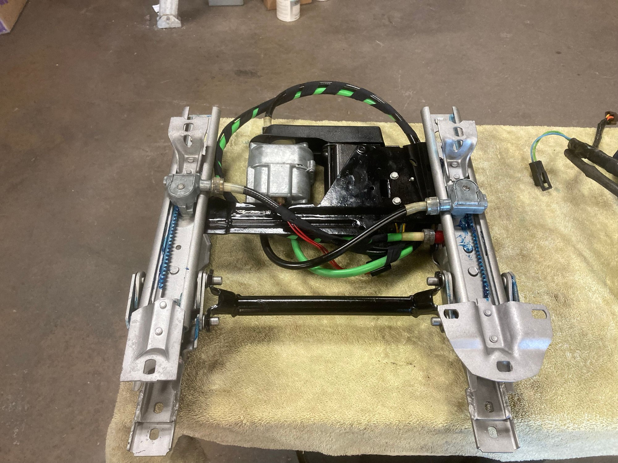

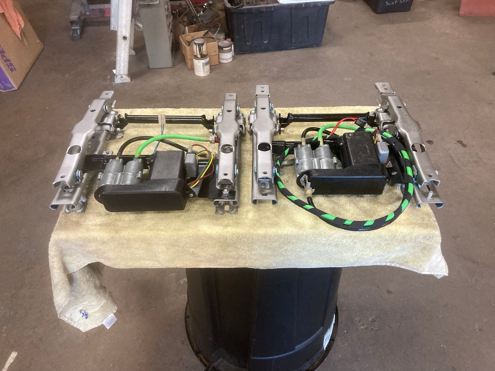

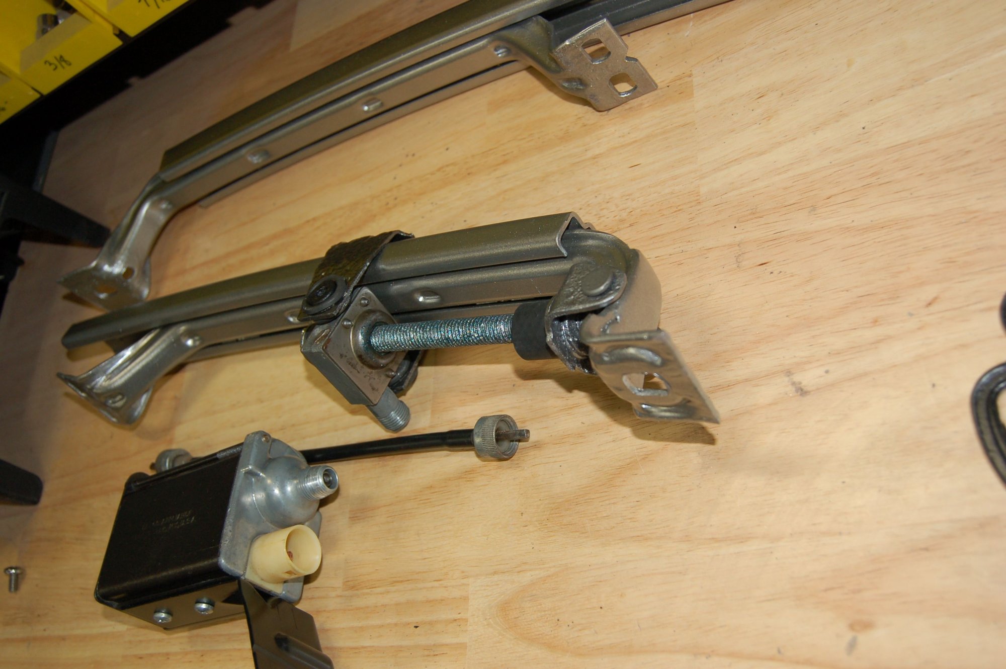

For comparison, here are photos of a set of B-body power seat tracks from a 66 Impala I restored for a buddy a few years ago:

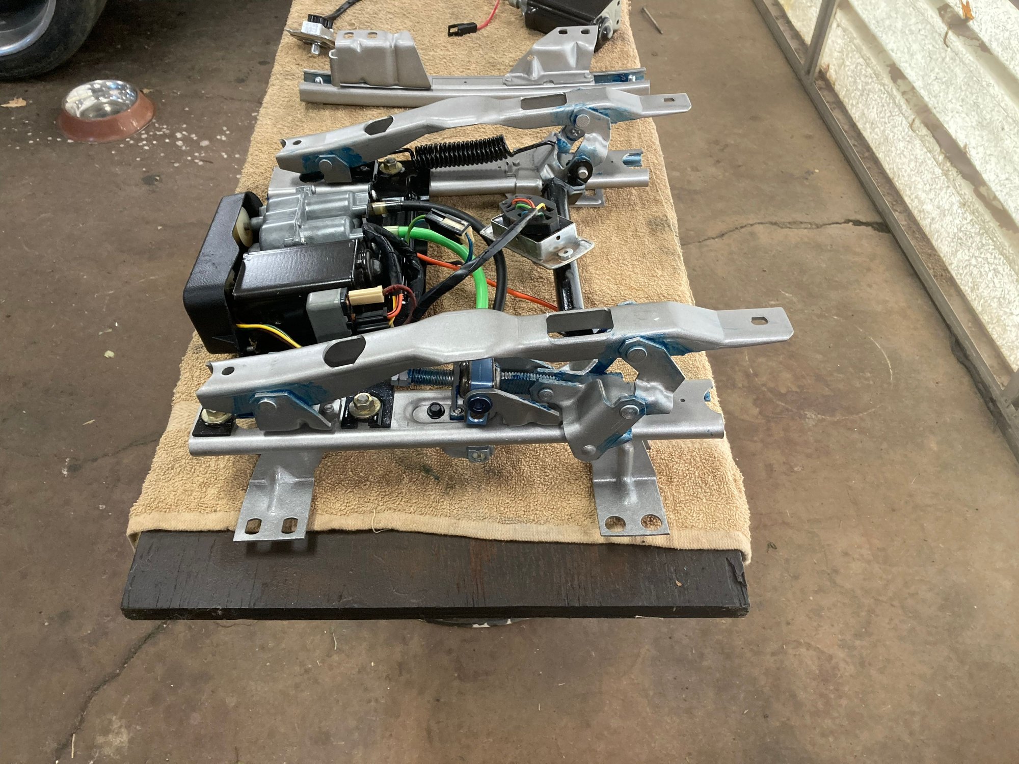

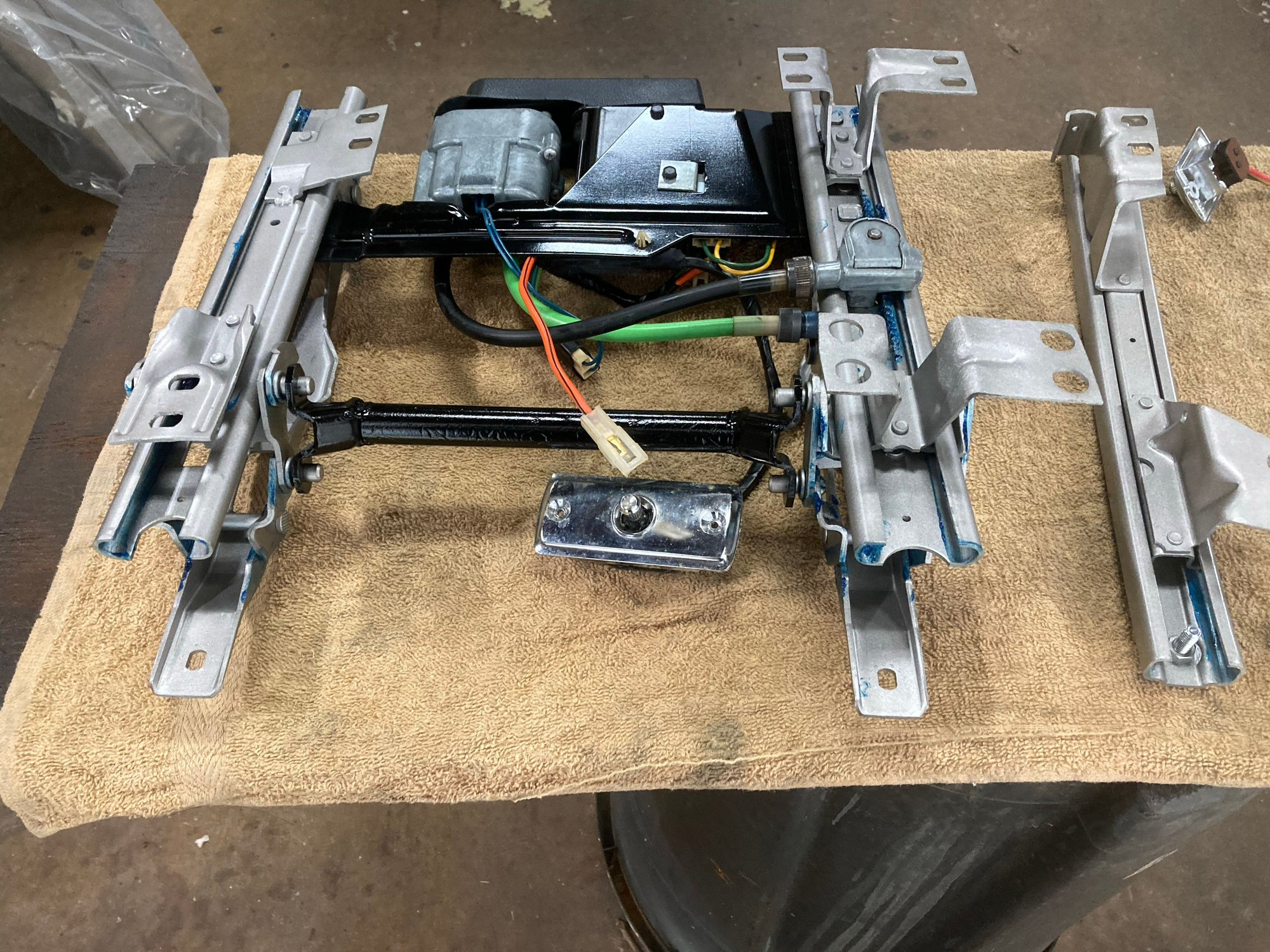

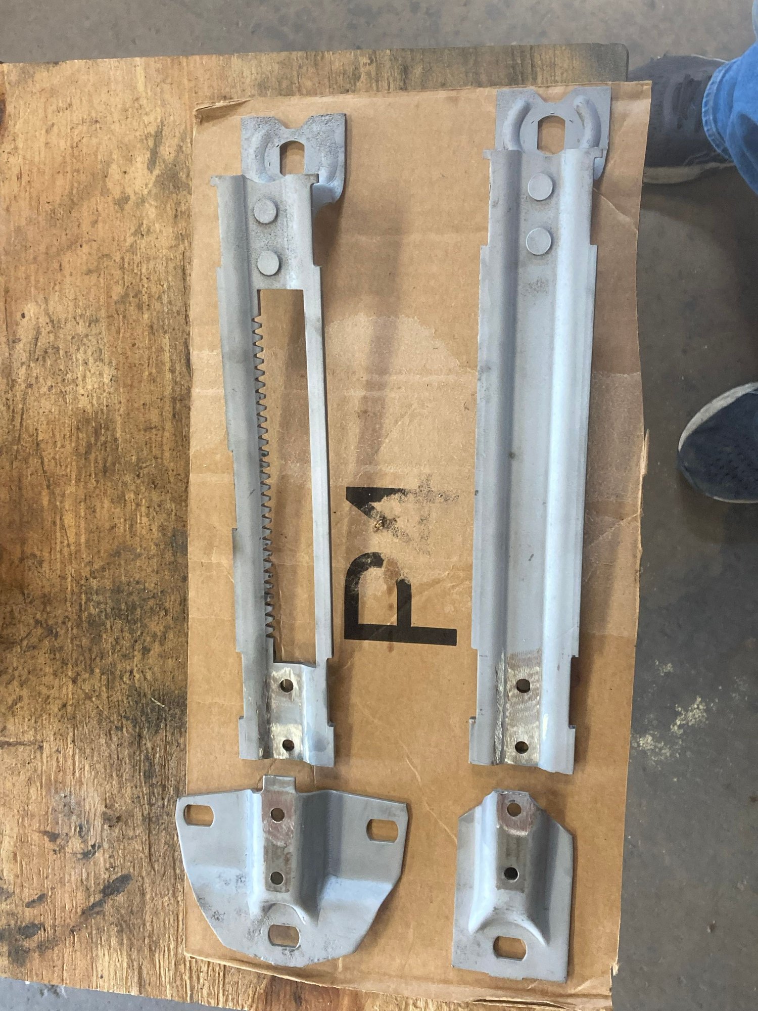

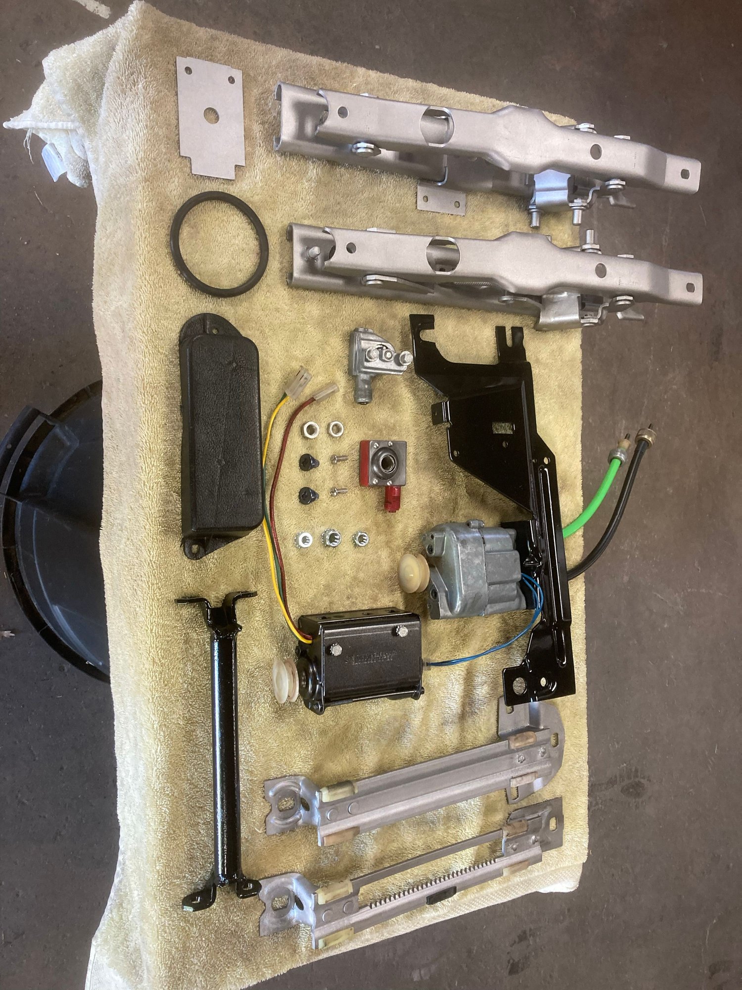

Here are A-body tracks I restored for his 442:
As you can see, while much of the track is the same, the feet on the A-body and B-body tracks are completely different.
$400 is a decent price if it is a set of driver and passenger power tracks (like the 66 impala tracks in the first set of photos above) in good shape. If it is just a driver power with manual passenger tracks, that is still okay, but not great. Ether way, they are not going to fit in your car without serious fabrication and modification to the feet.

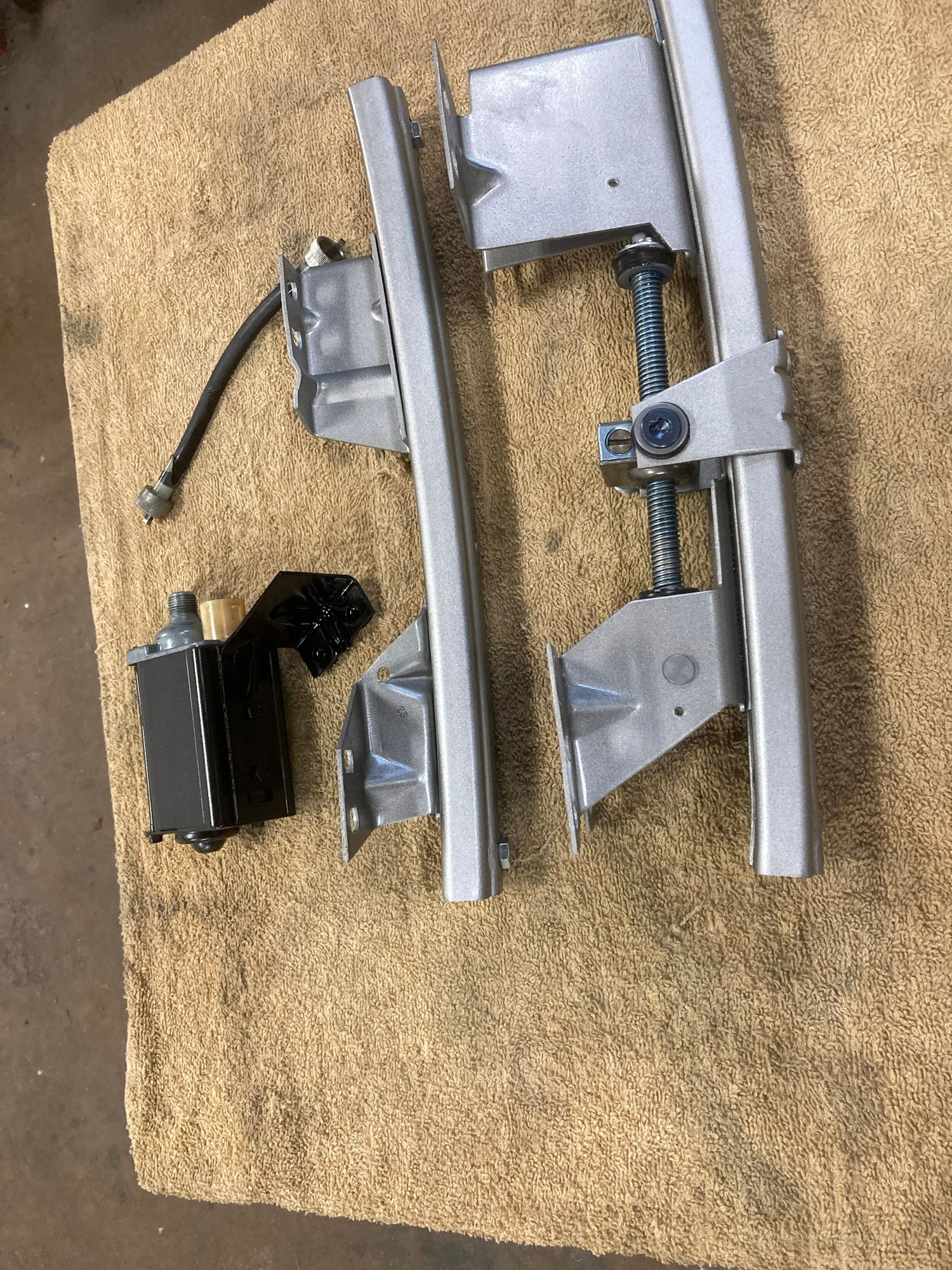

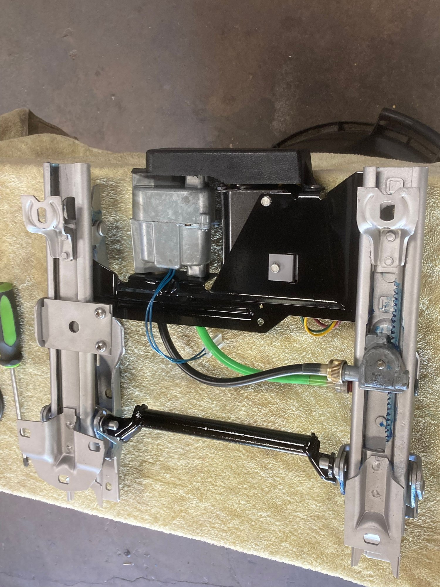

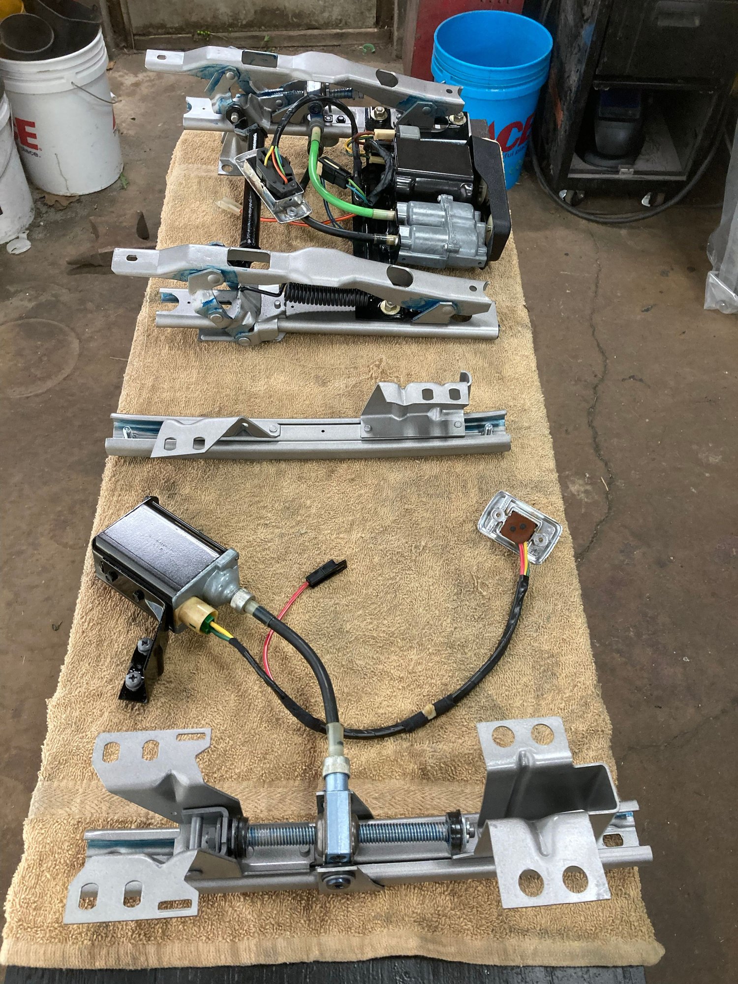

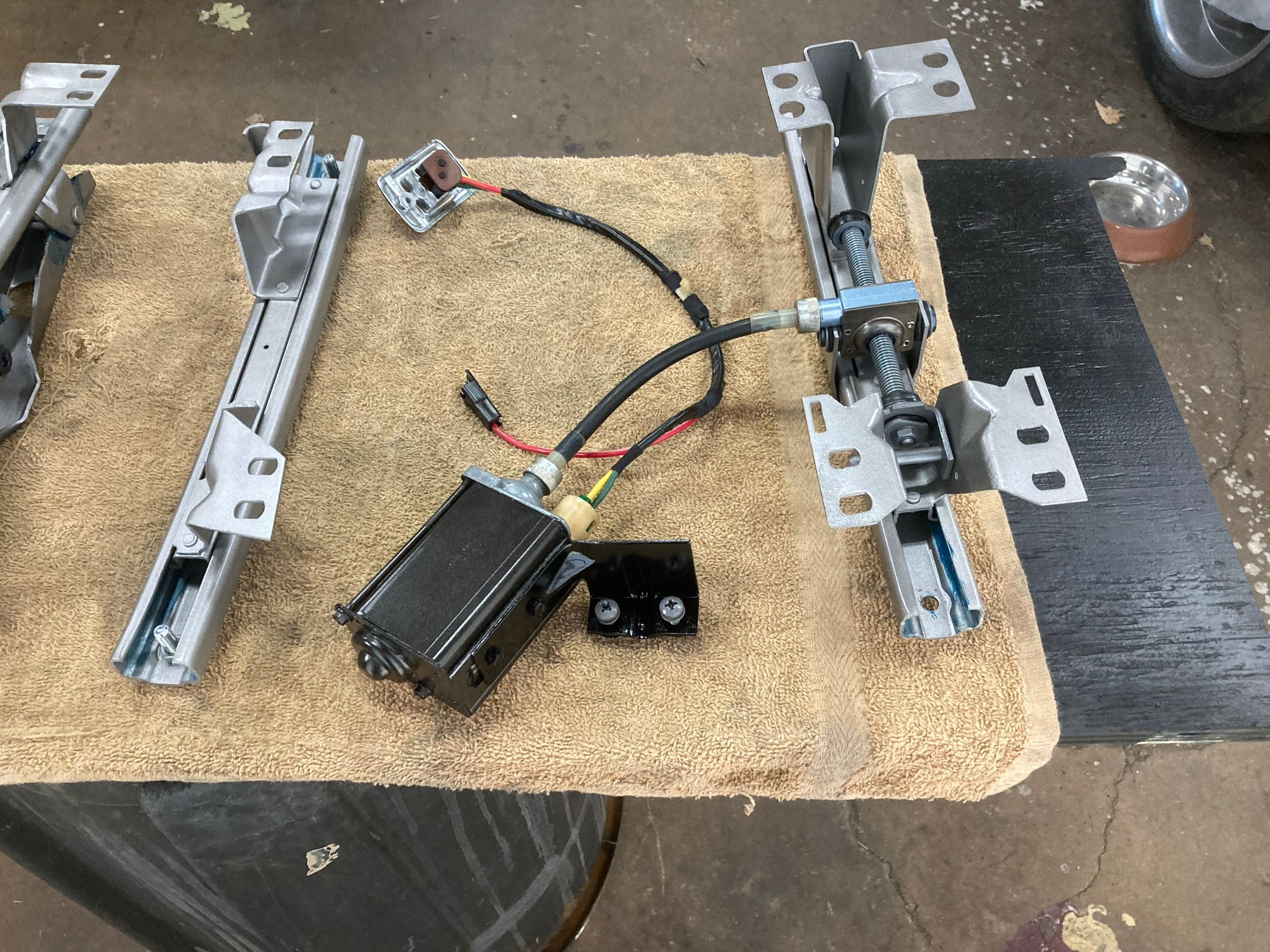

B-body cars could be ordered with a power passenger seat, but it was only available as a 2-way track like the first set of photos in post #14. The last shot in the second set of photos in post #14 shows a driver and passenger 4-way track for an A-body, but I made the passenger track by swapping the rear feet on a driver side track and re-wiring the switch to work properly on the passenger side. A passenger side power seat was never an available option on an A-body from the factory.

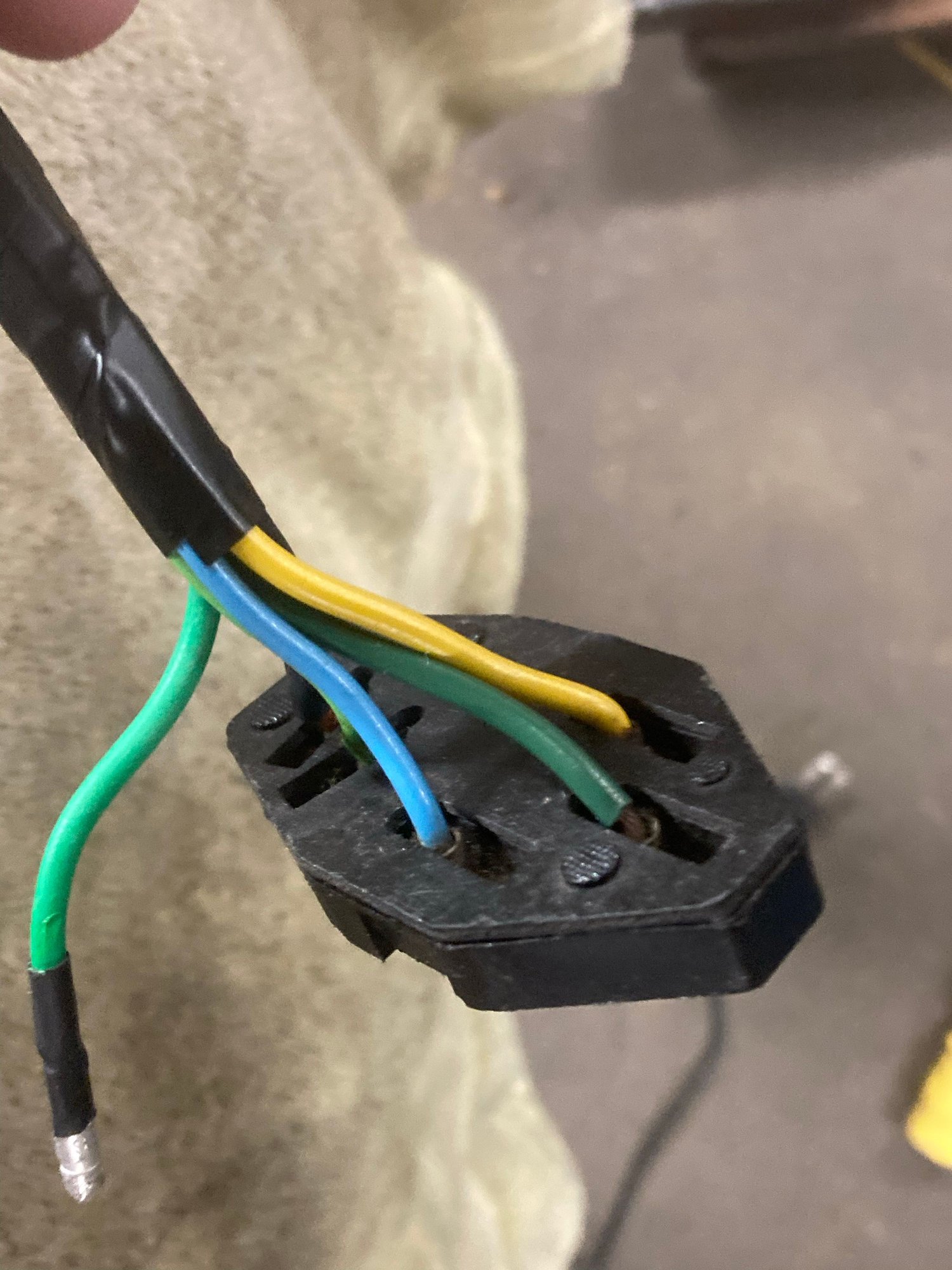

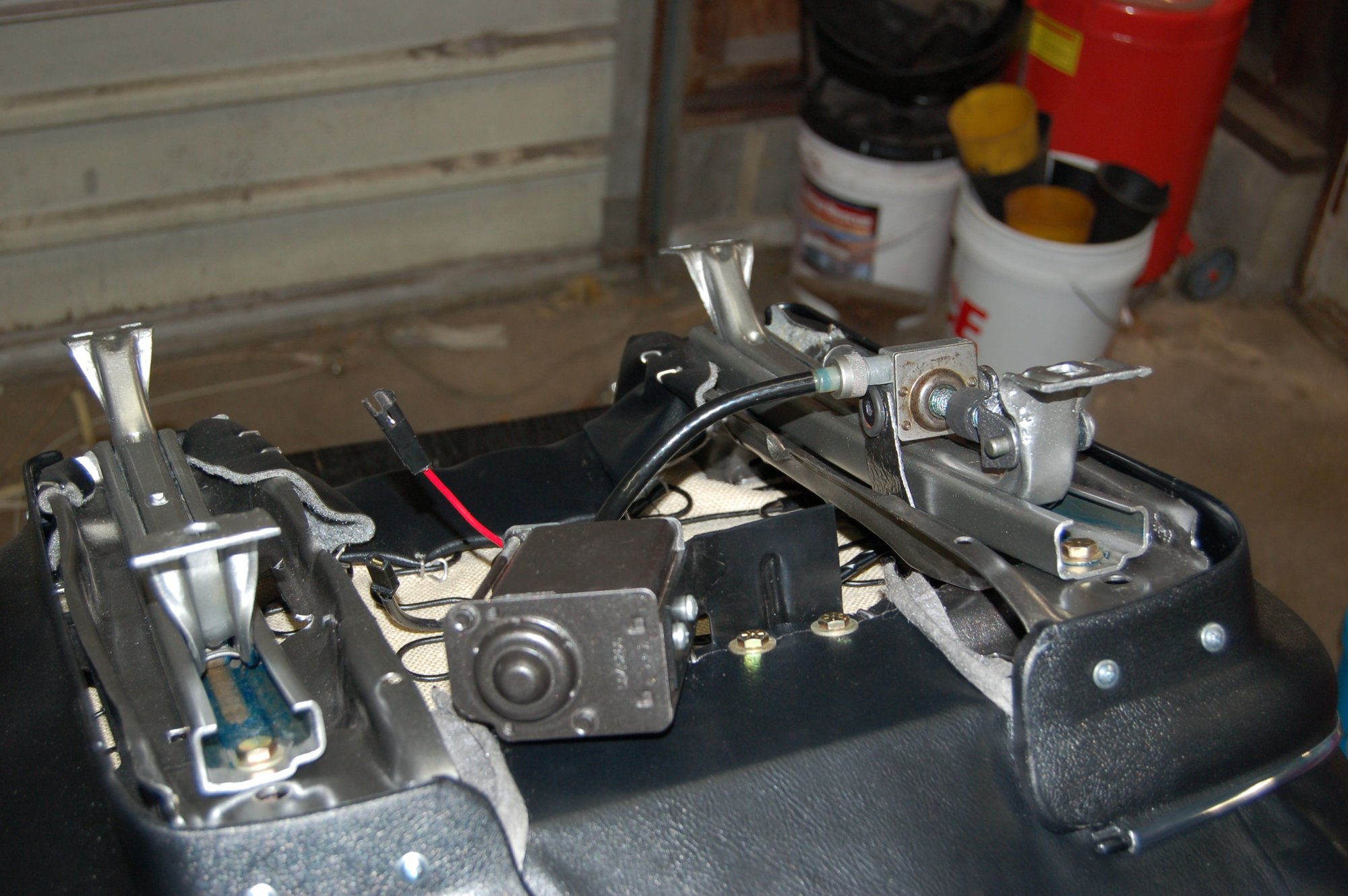

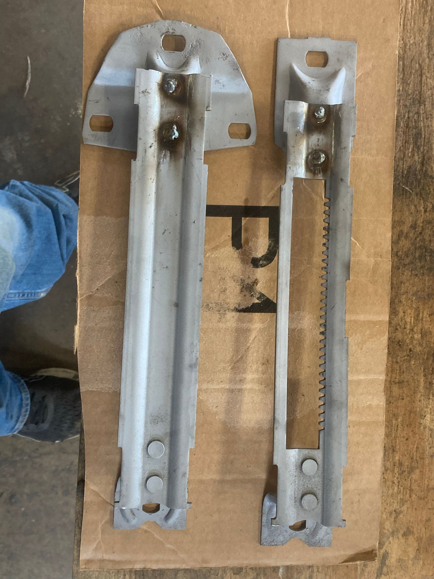

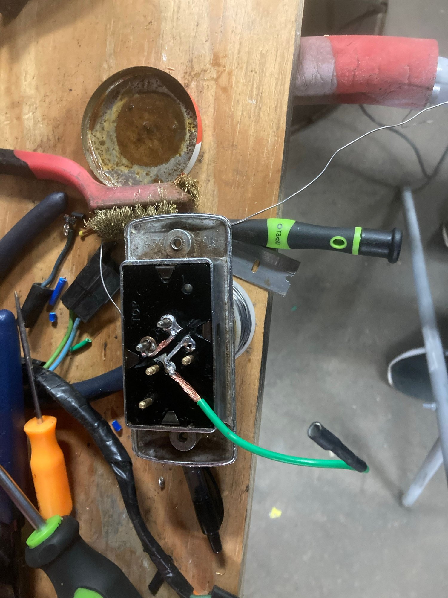

Here are shots of what I do to make a driver-side track work on the passenger side:
Swapping the rear feet:
Re-wiring the switch to work on the opposite side:
Driver-side feet placement:
Passenger-side feet placement:
Also, the seat brackets on the floor are different between power and manual seat tracks for an A-body. So, if you install power tracks on both sides, you need to weld power seat mounts to the floor on both sides as well. The power seat mounting brackets are reproduced, so you can buy those new.
I have also used 2-way B-body passenger seat tracks and A-body manual tracks to make 2-Way passenger power seat tracks for an A-body (again something never offered by the factory). I have this set on the passenger side on my 72 holiday coupe.
