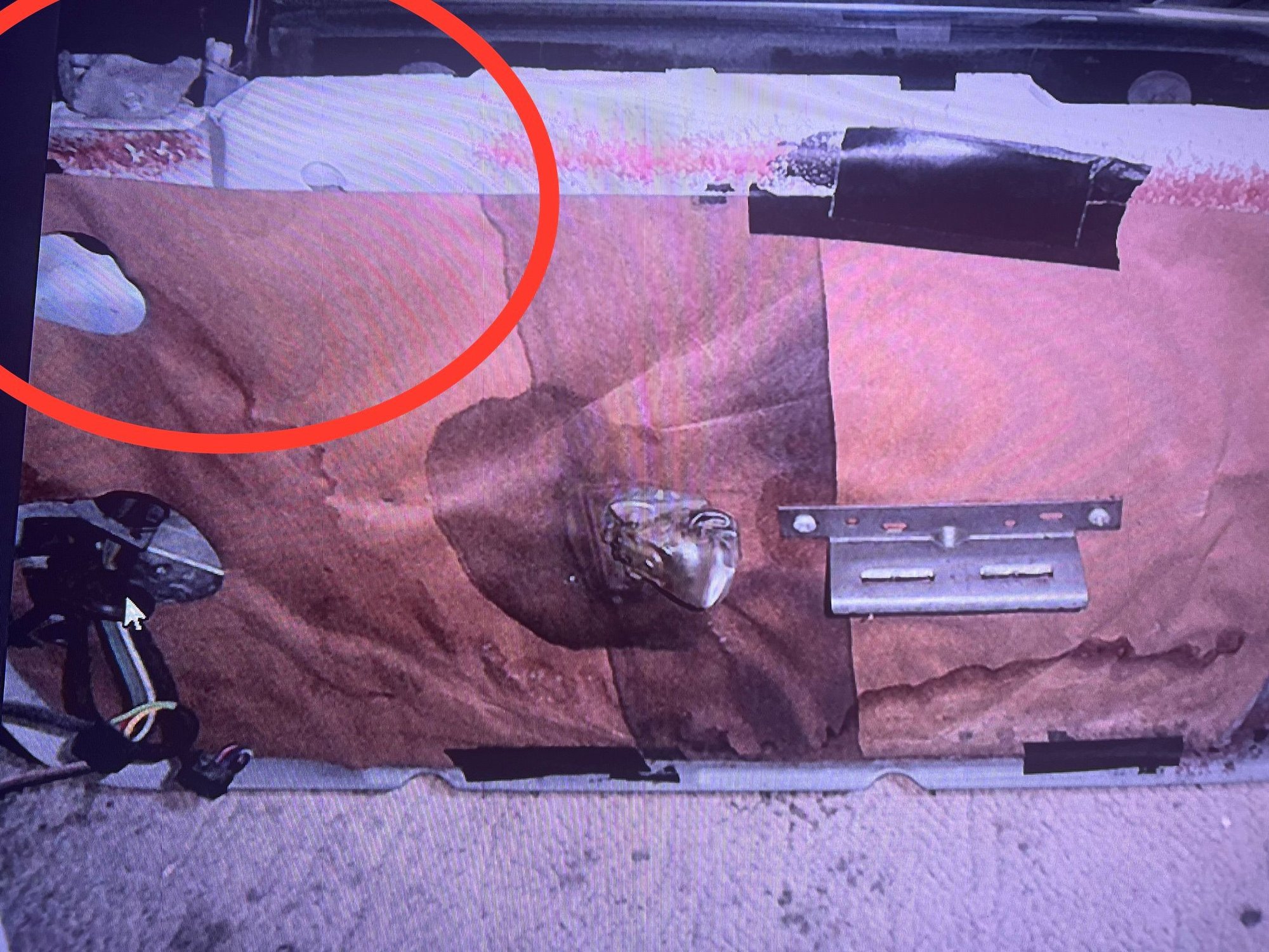

Hello everyone,
I need a little help. Does anyone have a picture of the inside of the door on a 67 delta 88? During the restoration I documented everything as it later comes together again. Due to a data loss, I unfortunately need help. Can someone tell me where the one in the picture is mounted in the door? And generally a picture without door board would be great so I can see that I haven't forgotten anything.
Thank you all
René

You need to get a scanned picture from a Fisher assembly manual from that year. The piece you have, is for the Vent Window to door shell, most likely. A similar part is used in '68 A bodies and El Camino/Sprint along with Sedans through '72.

As noted, installs at the rear bolts of vent window. These are the only shots I have… it is the PASSENGER Side (Right Side)… hope this helps, Dave
Thank you for the picture. I'll take a look later if it works but that's exactly what I was looking for. Many thanks ❤️
