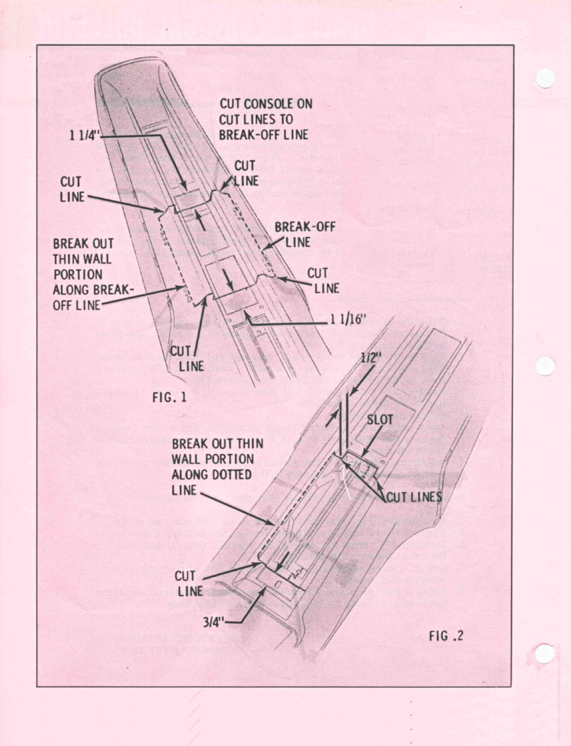

Greetings. Does anyone know where I can find some instructions with video and/or pics on converting console from automatic to manual?
I saw one post that mentioned the factory assembly manual as a source. Anything else?

Ah, the old get someone else to by the manual so you don't have to...
Actually, the 1970 CSM doesn't even have this info. There was a Dealer Technical Bulletin issued that year. You're welcome.
Note that this document provides the info for both manual trans and dual gate. Be sure you cut in the right place for your shifter.

Wow - thank you Joe! I knew you would know. Usually, I find the service manuals too difficult to follow..... This dealer bulletin is extremely clear and easy to follow. I would be glad to pay for this help. Let me know. And thank you again

Those same diagrams are in the 1971 and 72 CSMs.
