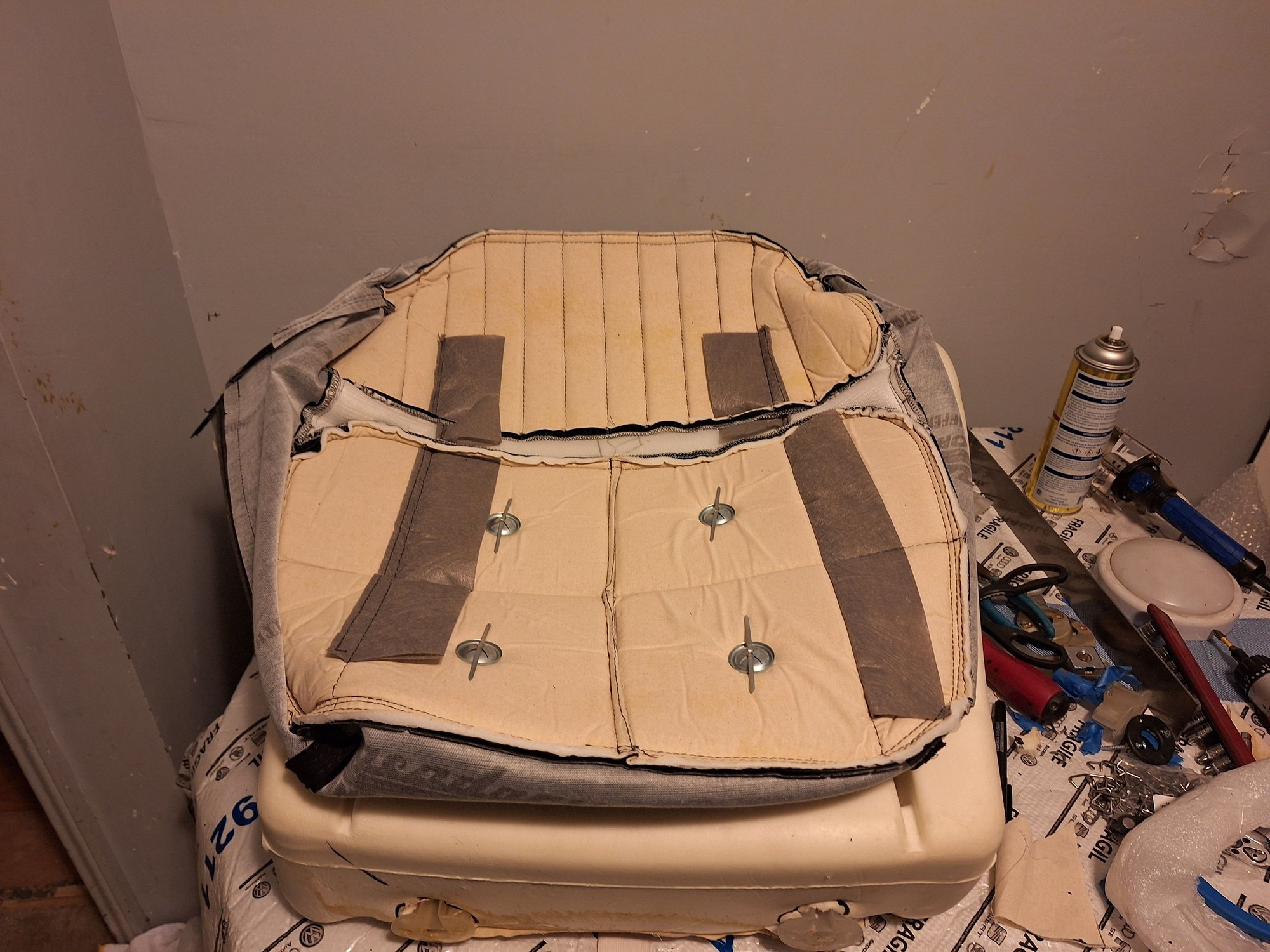

Went to install the upper rallye seat cover and something doesn't seem right with the listing pockets.
Not sure if someone had a tough day with the sewing machine.

Holy $hit...what a debacle.

With some strategic cutting, I think I can make it usable.
Sent an email with pics to Legendary let's see what they come back with.

Quote:
Originally Posted by
tkcutlass
This is really not a big deal and pretty much expected- it's just more obvious on these because of the center band sewn across the pattern.
Just snip the sleeves where they are sewn down at the center band so that they can stand up, and then install the listing rod across the gap.
