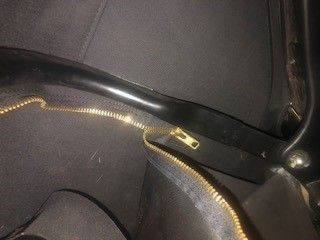

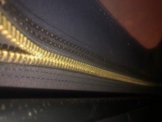

The forum just helped me get my top to go up and down by telling me about the circuit breaker issue. I listened and the top now works. BUT. in so doing and being that the top had not been used in several months and cold and stiff and when I was through testing the top for operating properly i now see that the zip in plastic back glass has come unzipped about halfway from the closed end of the zipper. So before I go any further has anyone been there done that repair and if so what is the trick? See pics. Thanks as always, Mike

I have no experience with the zipped in rear window on a Cutlass. My Jeep Wrangler has them on its soft top, though. You may be able to pry the “Y” part of the zipper open slightly so it can be moved to the opposite side of the open area, then pinch it back to original using pliers. I have successfully done this on luggage zippers.

found time to try and I think your idea will work. the main problem is the way the plastic glass is mounted into the top. You (or maybe it is just me) can not get to both sides of the metal zipper puller tab in order to pry apart and slide up to the unzipped area to reattach as suggested in your post. So what I did was to cut the metal stops off of the closed position of the zipper and removed the metal zipper puller off and pried both sides to allow access to both sides of the zipper teeth in order to close the gap after placing the zipper in position. I then was able to squeeze close the part of the zipper that attaches to the roof half of the zipper then inserted the window part of the zipper and was able to zip together about 3 inches so as to get an angle on the metal zipper in order to tighten the window half of the metal zipper and when I squeezed the clamp it broke being that it is potmetal. But the idea works just be careful when prying and opening the metal part that ties the zipper together. Now I just need to find a zipper that works with the top zipper teeth. I will report back either way. Thanks Mike

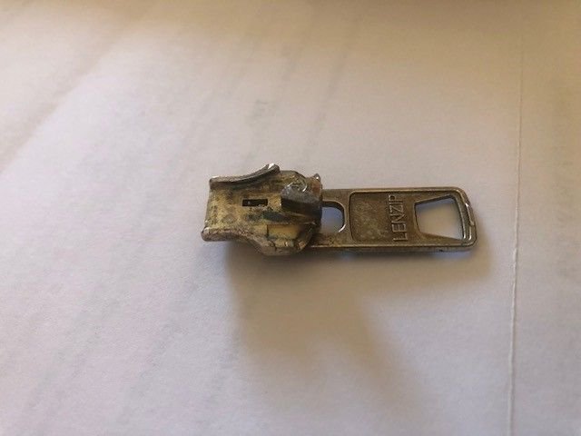

I have learned more about zippers that I ever wanted to learn. Your idea will work but as stated my slider broke and going through the hassels of trying to find one that fits and learning that my slider is a Lenzip #10 and making the mistake of thinking that all #10's should be the same I ordered some thinking it is a standard industrial unit of measuring the size needed but as with other China stuff their #10 is not the same. So back to work and later found the correct manufacturer and size #10 that matches the one on my convertible and it will pry apart in order to try the repair. I was able to get it started but due to the cold weather will have to wait to finish. thanks for your input FUN71. By the way the name of the zipper company is Zipper Shipper. Great people to work with. Fast service and customer oriented.

Well Mr. Fun71 your idea about how to replace the broken slider worked like a champ. It finally warmed up to 70 degrees so the plastic glass assembly and the top were more pliable. Once i got the correct slider and with correct size (as they say size matters) I was able to pry apart the 2 sides so as to fit over the teeth of the zipper and once on the starter side (the convertible top side) of the zipper I squeezed that side back into position then inserted the glass portion of the zipper into the slider ,just like zipping up a jacket, and at that point I squeezed that side of the slider back together then zip it. Again the company Zipper Shipper had the correct slider. Worked Great! Thank you forum, Mike
