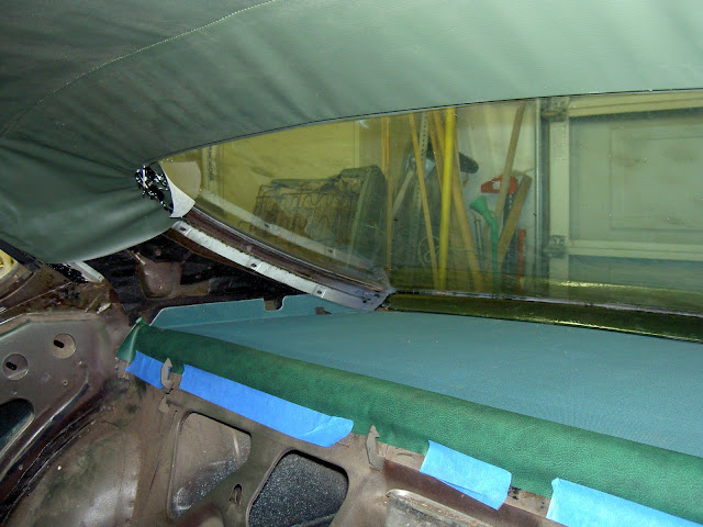

Yes it went in without much problem... and I did not need to take out the back window....I did use the old one to use as s template to get the side creases/bends at the right spot. I did take the end molding pices off the back window but the board slid under hte bottom window frame and then used a lot of the 3M black weatherstriping adheasive on the sail panels (in addition to the small 1 inch squares 70Post mentioned to get the sides to stay inplace. Taped the front along the frame behind where the back seat will cover it up and it looks like new!! Package tray ended up being the easiest part...
