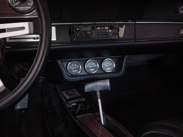

Another idea, but it does require different a/c vent duct that works with the 8 track housing.(not pictured). Yes, its an old pic.

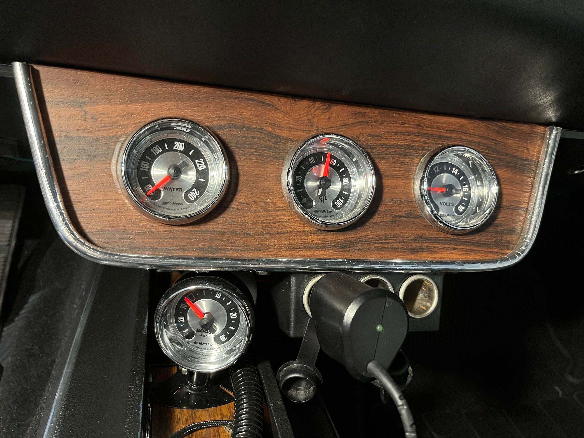

There's a board member who makes these under-dash panels patterned essentially after the 8-track enclosures - he can make them in 3- and 4-gauge length sizes.
You only have to trim out the center section out of your underdash a/c panel to retrofit the panel between the 2 remaining side sections and the gauge panel bolts right up to the underside of the dash. He can trim the panel out in OEM woodgrain to match the year of your car.
