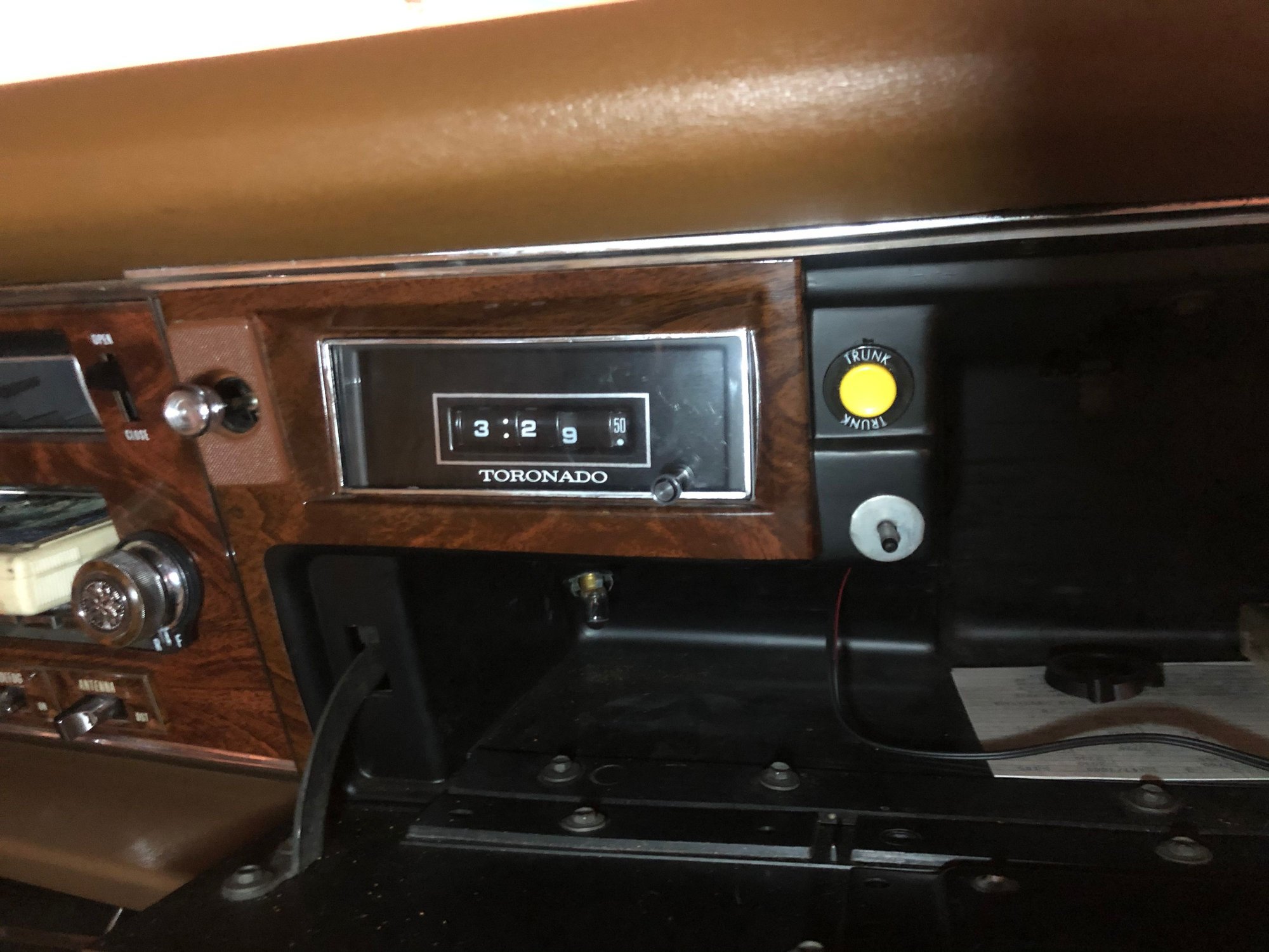

There should be an access hole in glovebox under the clock.
Try pushing the clock toward the windshield. Most 74-76 88/98 and 74-78 Toronado use ribbed studs to mount the clock and if car has these you should be able to push it off those studs and remove it thru the access hole.
If not, and the clock is mounted with screws or nuts, it's simple to remove the glovebox door and liner for better access.

I have a '78 Toronado, and I replaced the clock with an NOS Toro clock I bought on Ebay. Removing it is easy. As rocketraider says, just push in on it. It comes out through the top of the glovebox. You don't have to remove the glovebox or anything.
There is no "top" to the glovebox on that side. If you open the glovebox and look "up" at the location of the clock, you'll see the clock. Removing it is very easy.

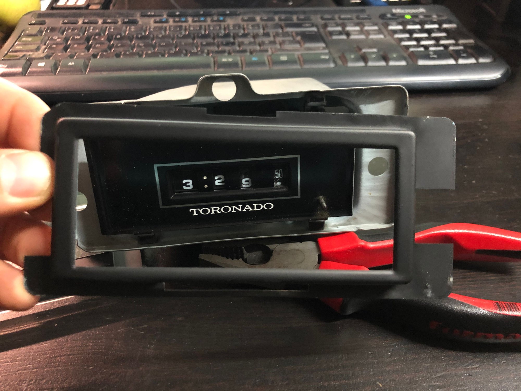

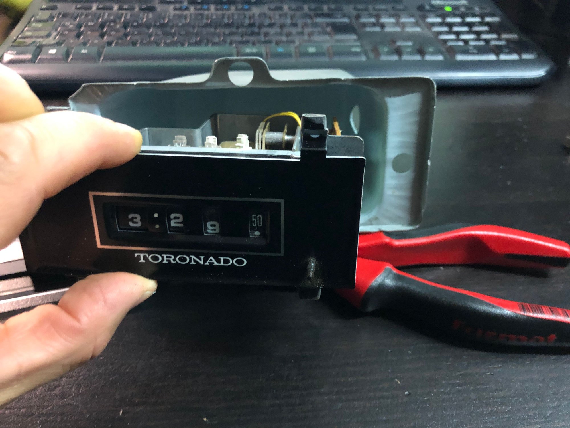

Here's what the clock looks like when it's out. Those three mounting holes just press-fit over knurled studs. There are no nuts to thread on or anything.

I managed to take it apart too. Actually easy as well.
Took some pictures in case anybody wants to do the same.

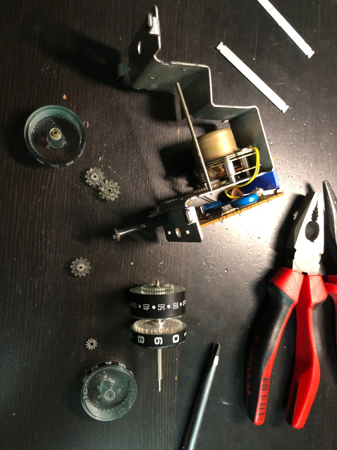

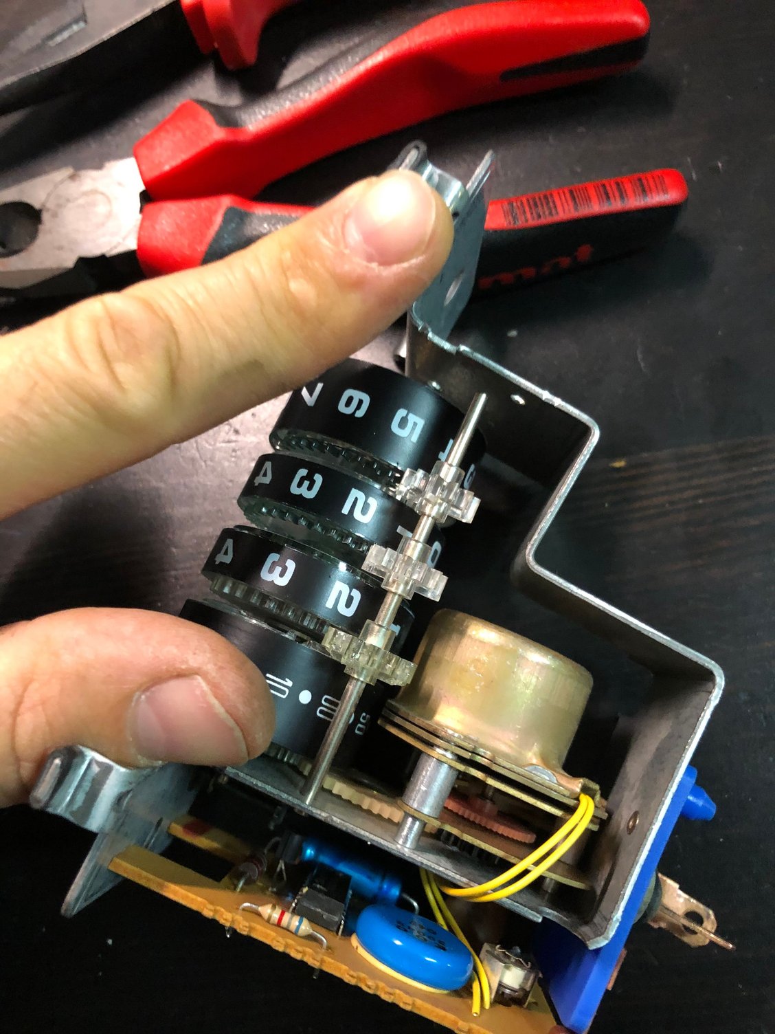

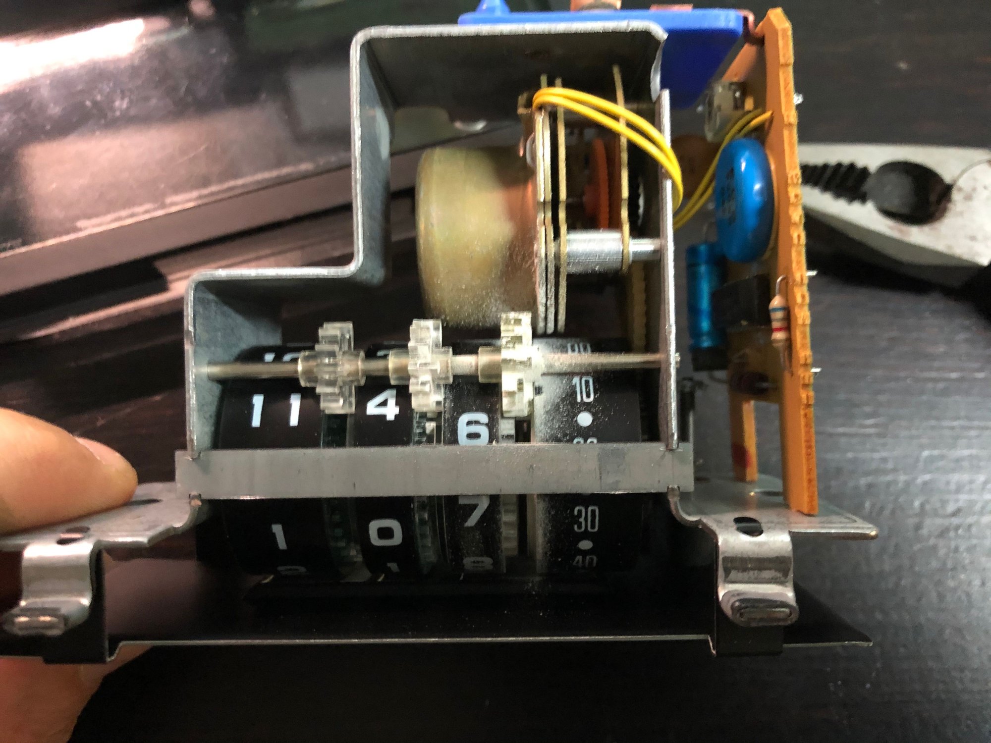

The problem was dirt why it didn’t run. The „seconds“ wheel was kinda stuck to the axle and couldn’t turn freely as it should. The „minutes“ wheel is the only one supposed to be fixed on the axle in order to be able to adjust the time through that stick on the outside.
The „10 minute“ and the „hour“ wheel get turned by the small see through plastic gearwheels on top of the digit wheels.
I took everything apart and cleaned it. Everything moves freely again but unfortunately due to the jam some plastic teeth are broken and one gearwheel cut into the „seconds wheel“.
That means TIME OVER, can’t be fixed and I need a new clock.
I found one on eBay but it’s a 75 without the „seconds“ and I really want the original one.
If anybody has one for sale or knows where to get one, I would be more than happy if you let me know.

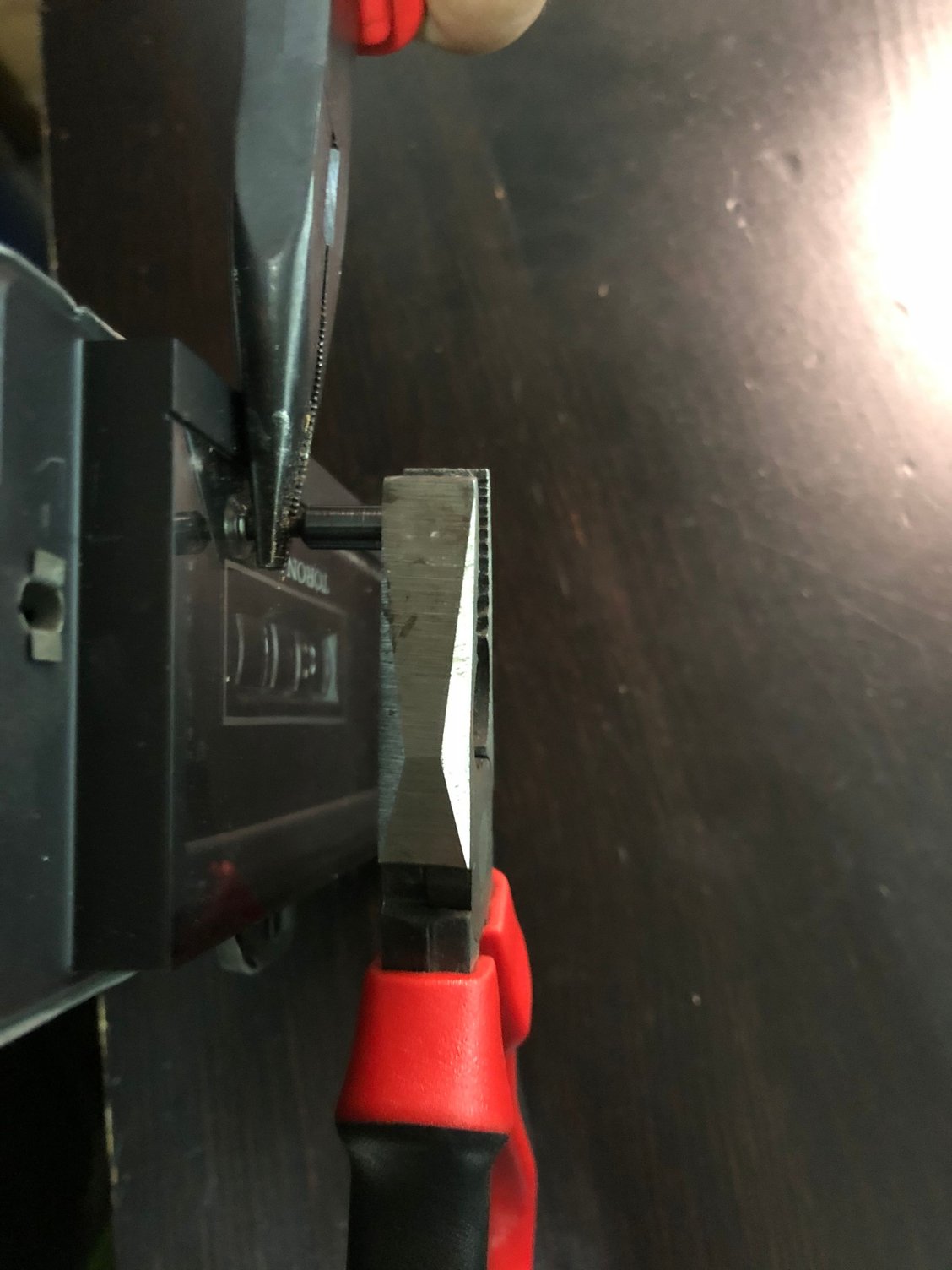

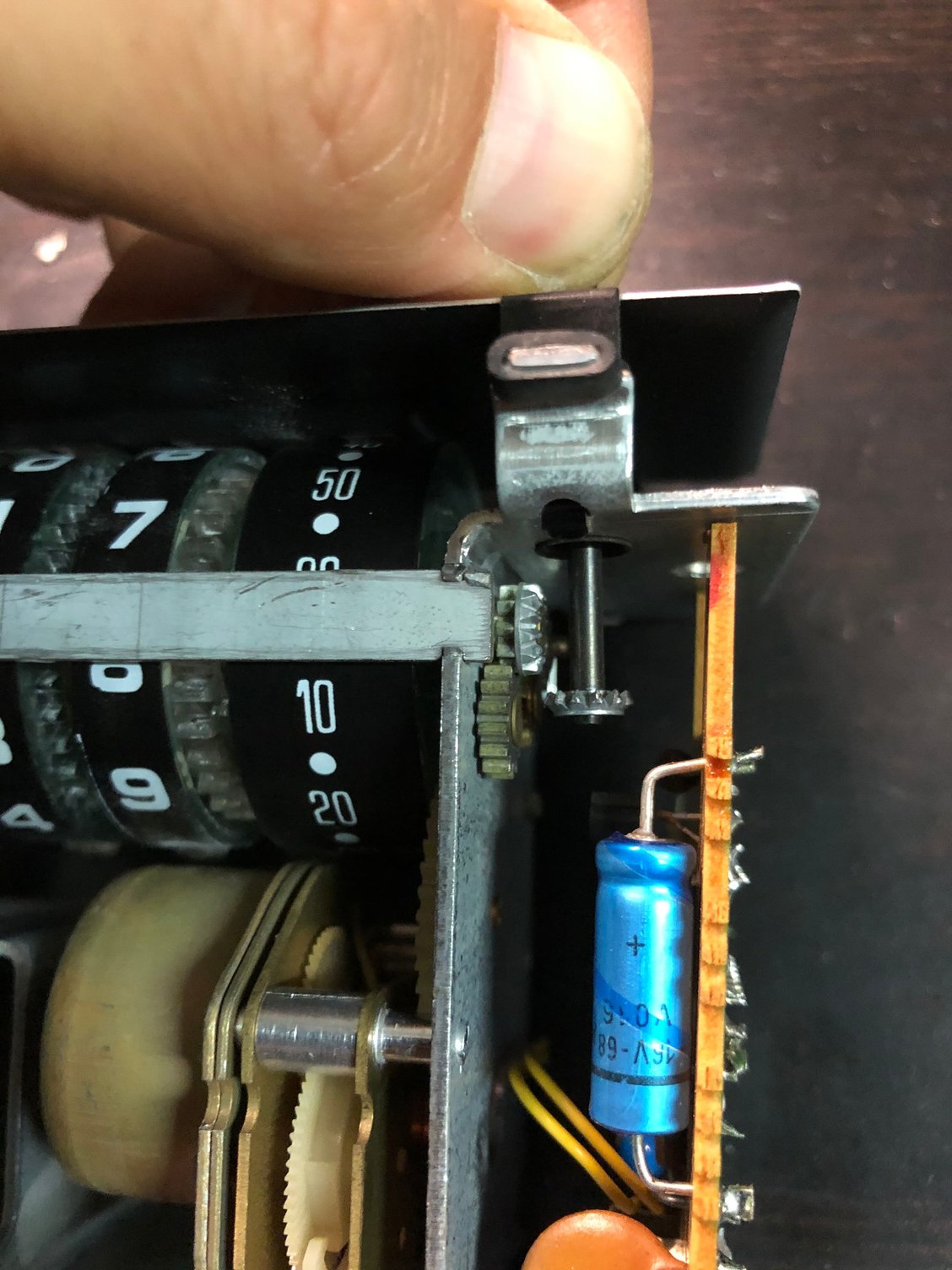

Unscrew pin

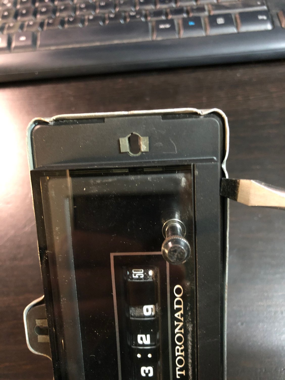

Carefully pry open on all the dents.
You can see the white dust. It’s where the gearwheel kept cutting in the digit wheel due to the jam.

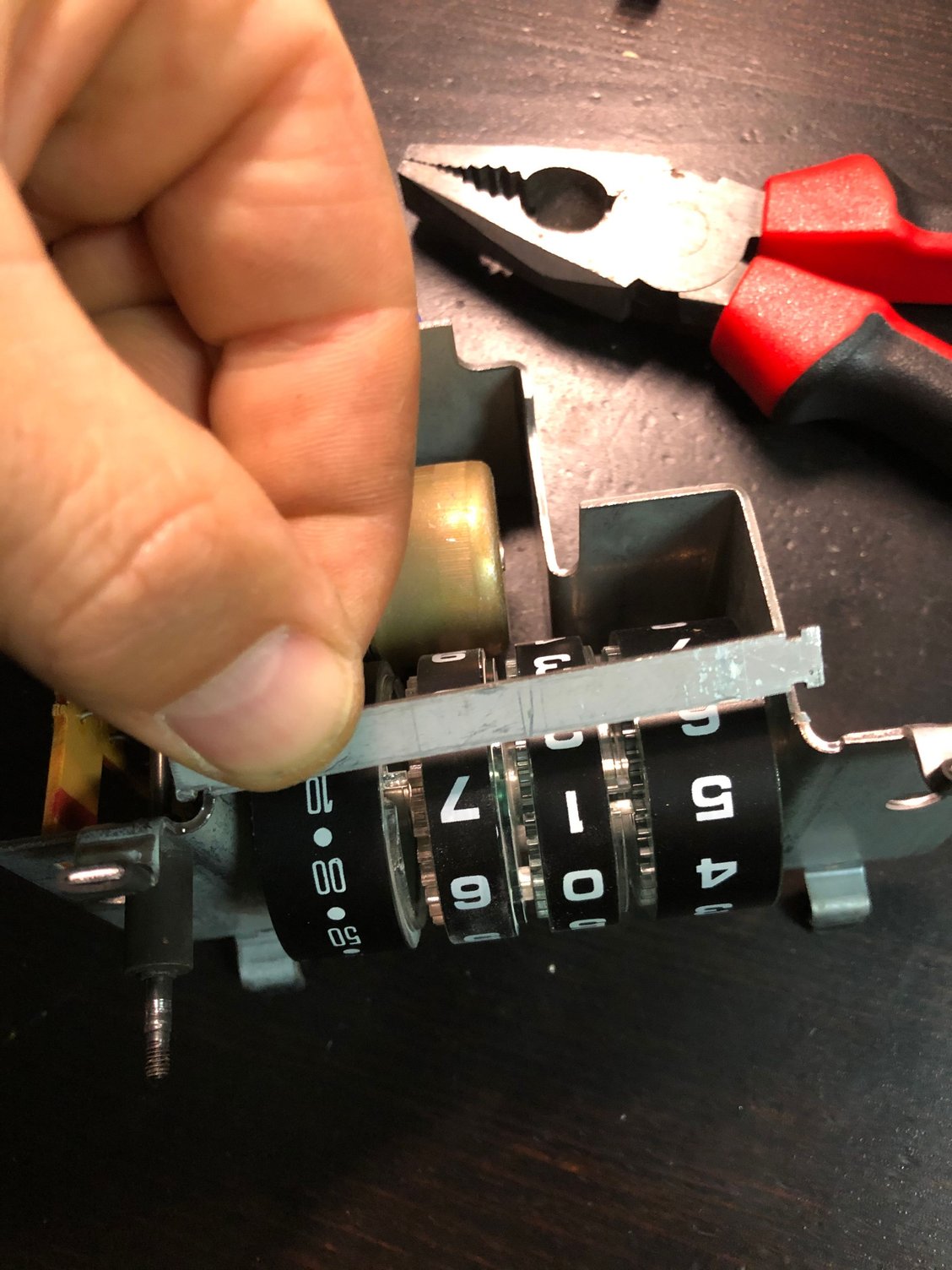

The time adjusting mechanism
Take out metal plates on both sides to take axle and wheels out
Carefully bend open
