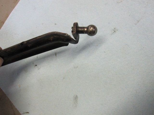

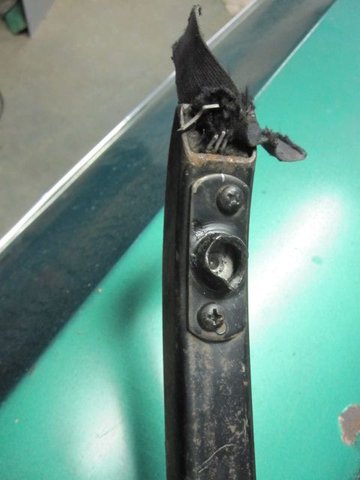

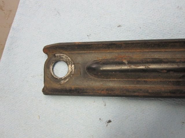

Top on my 72 88 has been working ok, recently top made a pop and would not come all the way down, apparently front left ball joint and socket came apart, arm that holds ball stud bent badly.
Questions, are the right and left side ball arms symmetrically opposite? in case I cant find a replacement, I can straighten and reweld it matching the right side, it's hard to tell arm almost broke thru and bent 90 degs from right side., pic shows it bent back some what after I pried it back some. Socket part messed up also.
I will post in wanted adds for some used pieces.
