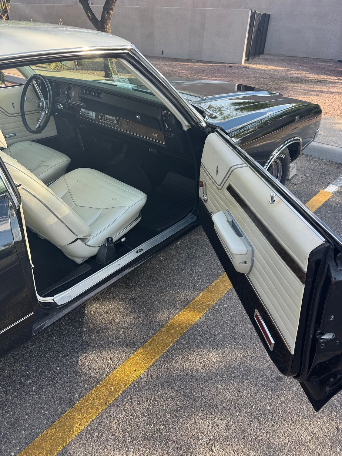

I’m looking for a picture of a 70 without the carpet to see the hole in the floor. I’m thinking about switching from column shift to floor shift and just doing research. Anybody have pictures of their floor without their carpet in it to see exactly where the hole is made for the floor Shifter I’d appreciate it.
