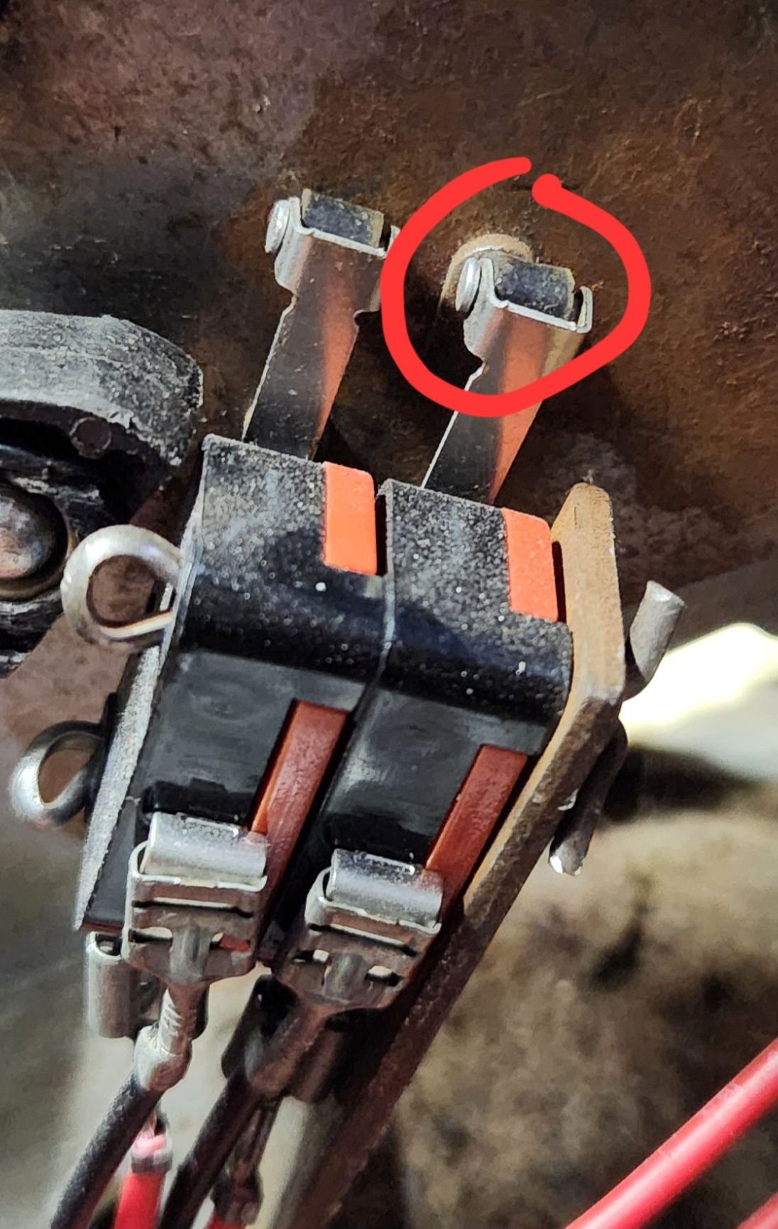

This thread is a bit seasoned, but thought I would add some pics. We all like pics, right. The B&M shifters have provisions for micro switches for the Neutral Safety and Reverse connections. Summitt sells the NSS and Reverse Switch kits for over $40 each. Amazon sells the micro switches 6 for $6.99!
https://a.co/d/8ZmshjP
Add a couple relays for current capacity and safety fuses at 5 for $10.79,
https://a.co/d/1JJX3jU
and you can install the switches for less than $3 each.
There are small bumps on the side of the shifter plate to activate the switches and a small mounting plate to hold them.
As you move the shifter from PARK to REVERSE, NEUTRAL, and DRIVE (forward gears), the bumps activate the proper switch to either enable the starter or the reverse lights. The switches activate the relays which are wired as NO (normally open) so they will only engage the starter or lights while the shifter is in the correct position.
PARK
REVERSE
NEUTRAL
The switches have mounting holes that line up with the holes on the shifter mounting plate. There are screws that can be used, but small zip ties or cotter pins work just as well, and you won't lose the nuts or washers.
For simplicity, the switches are used to connect the 12v neg. side of the relays and the ign switch provides the 12v pos.
