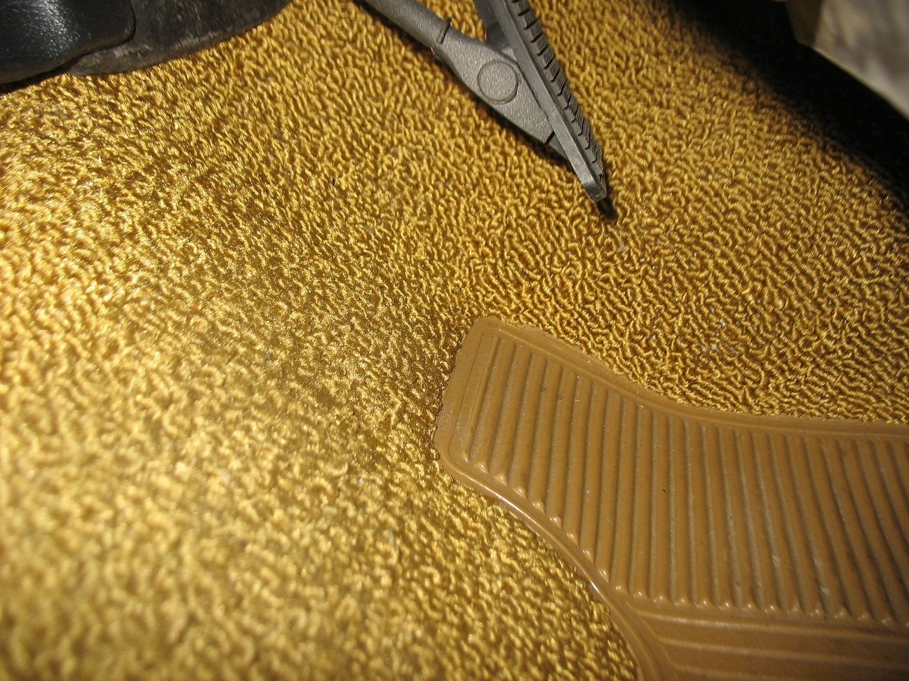

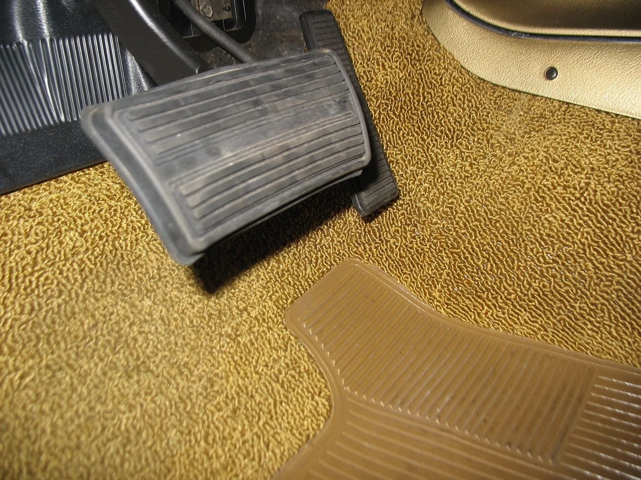

A few carpet/pedal/heel pad pics - '70 442 w/new carpet....
Old Mar 11, 2020 | 09:18 PM
Mossy's Avatar
Joined: Aug 2018
Posts: 126
From: Eastern Washington
Thank you much! Helps me a lot

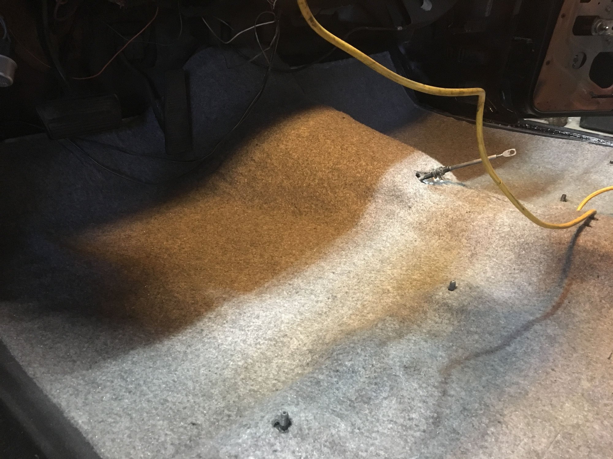

Do I need to cut around the shifter bracket or can the bracket lay on top of the carpet and just work around the shift cable?

Old Mar 22, 2020 | 05:02 PM
classicmuscle442's Avatar
Joined: Sep 2012
Posts: 1,413
From: Water Wonderland MI.
Carpet goes over the top of seat mounts.

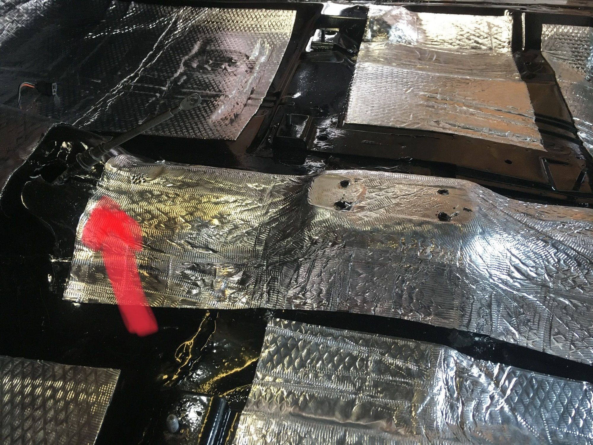

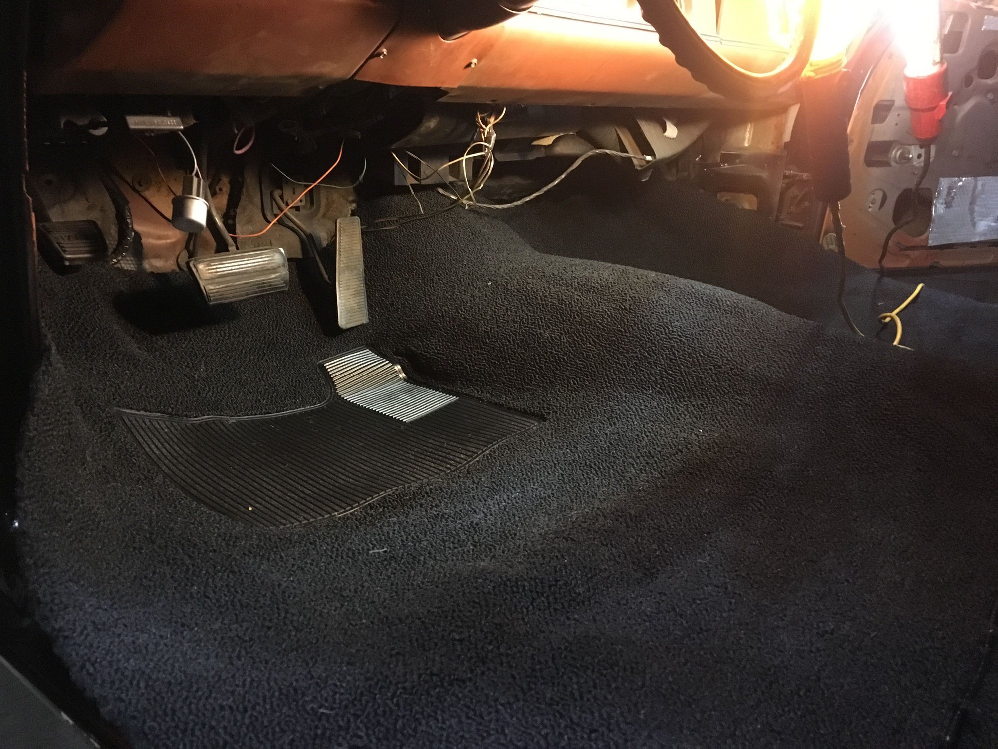

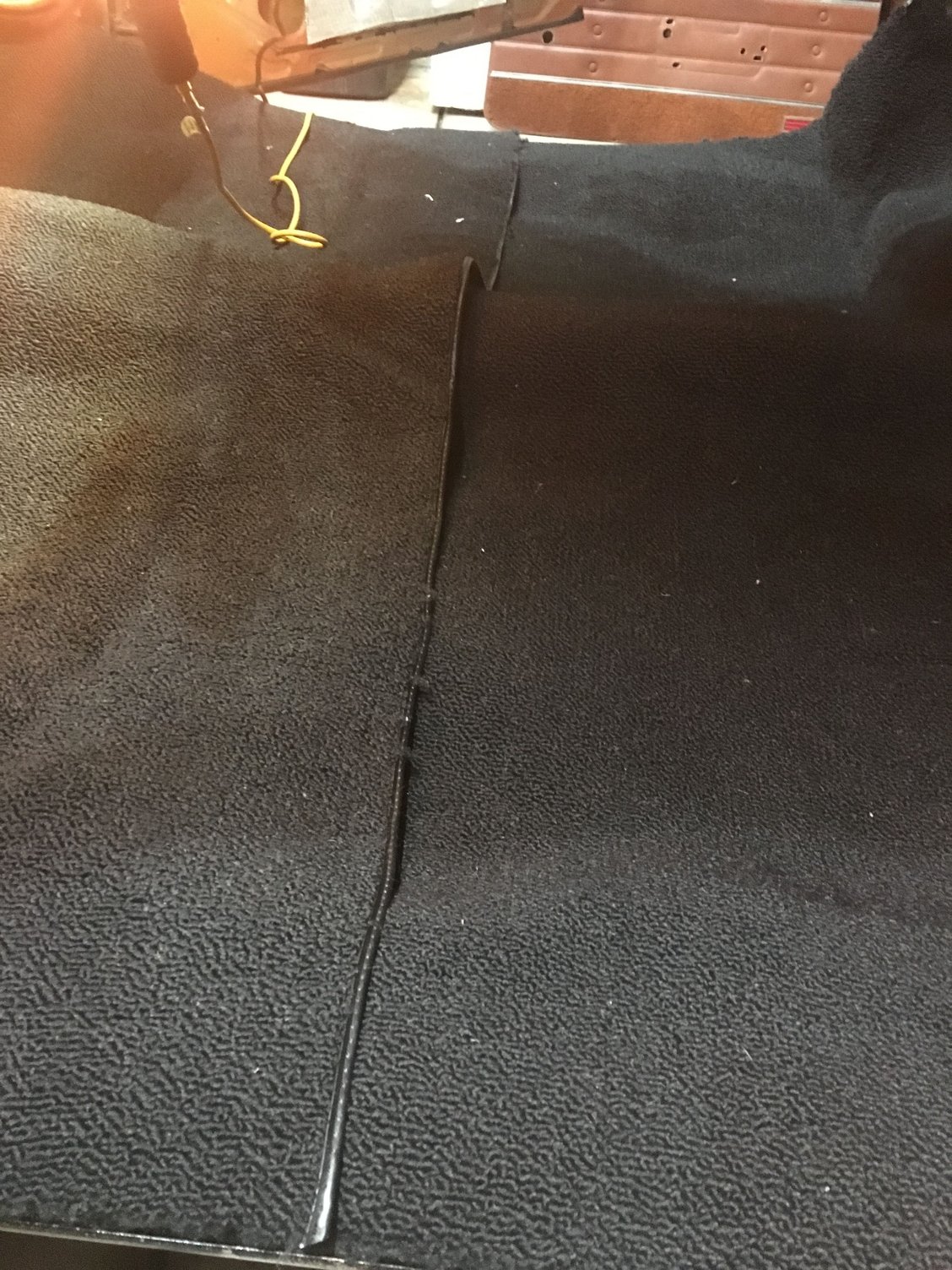

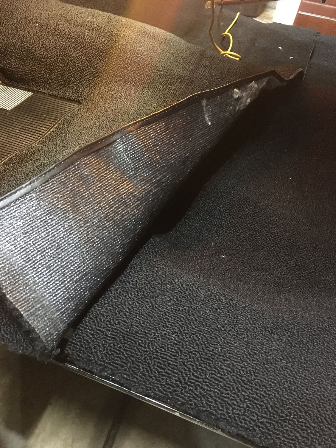

I have the 2 pieces laid in but not sure where to go from here. In the pictures you can see that the front piece overlaps the back piece around 7 inches. Does it look like the front piece needs to go forward more? If so, I think I’ll need to trim the front because it’s bottoming out at the tunnel/firewall area.
Old Mar 29, 2020 | 03:11 PM
Posts: 25,789
The front carpet overlaps the rear carpet by ~7" the entire width of the vehicle - this is normal. Don't worry if it's 5", 6", 6.5", 7" or whatever - there will remain an overlap - this is normal. You're not docking to a space ship you're installing a piece of carpet.
It does not look like the front piece needs to go forward - if it does, then move it forward - you have plenty of overlap. Make the best fit you can at the firewall and the left-hand side & right-hand side kick panels, make the cut-out for the high beam floor switch, install the driver's side firewall cover, make your holes for the seat mounts, center console mounts, seat belts, trim the carpet edges so they remain long enough to be tucked under the door/floor rocker panels & you're done.

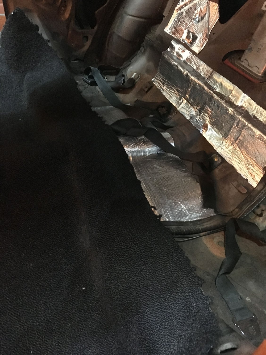

No glue needed anywhere or used. A little info...Your car looks like it has AC. I'm not positive about 71, but most AC cars had extra mats for insulation and heat resistance in the front. Those were used along with the jute backed carpet and factory asphalt paper. Now they sell bare carpets, carpets with different thicknesses of jute, and mass backed carpets. The thickest jute backed carpet now is not as thick as the original. The stuff on the floor you used looks ok, but it would be better to have more coverage, especially if you have AC and use it. At least, that's my opinion. Finally, it's good to have some extra jute, to use small pieces or strips to fill in any sags like around the sides of the tunnel. You can go to Home Depot and buy a yard or 2. If your old backing is not smelly or falling apart, you can maybe use that. As Norm mentioned the overlap is no big deal. What's on the back of the new carpet?
Old Mar 29, 2020 | 08:58 PM
Mossy's Avatar
Joined: Aug 2018
Posts: 126

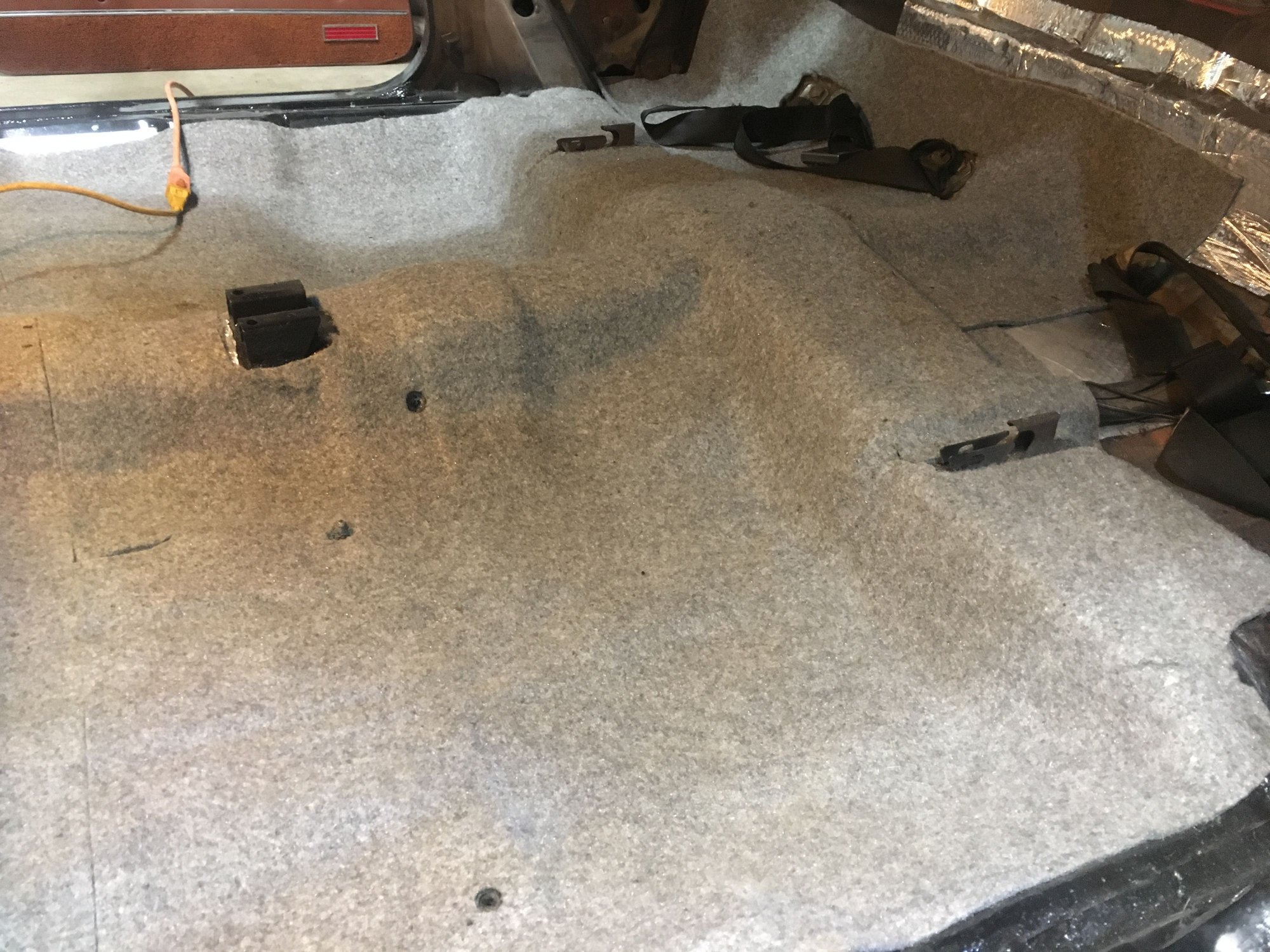

Yes it is a factory AC car but the compressor has been removed by previous owner. The new carpet is jute backed. Purchasing extra jute is a great idea because I’m having issues with the fitting around the tunnel. I have the shifter cut out dialed in as well as the grommet for the brights but it just isn’t as tight and molded as I thought it would be which is why I wondered if glue was needed. I will pick up some extra jute and see if that helps with the voids/sags.
Old Mar 29, 2020 | 09:06 PM
mrolds69's Avatar
Posts: 1,907
From: Toytown, MA
I see, what happens is all those layers add up. So if one or more are missing, then the carpet can be too short on the sides or elsewhere. All those big hardware stores have the jute. The tunnel area is always problematic. I've had to do that on many rugs before.

I may have went overkill but ended up laying down carpet pad pretty much everywhere. Almost done with the carpet
