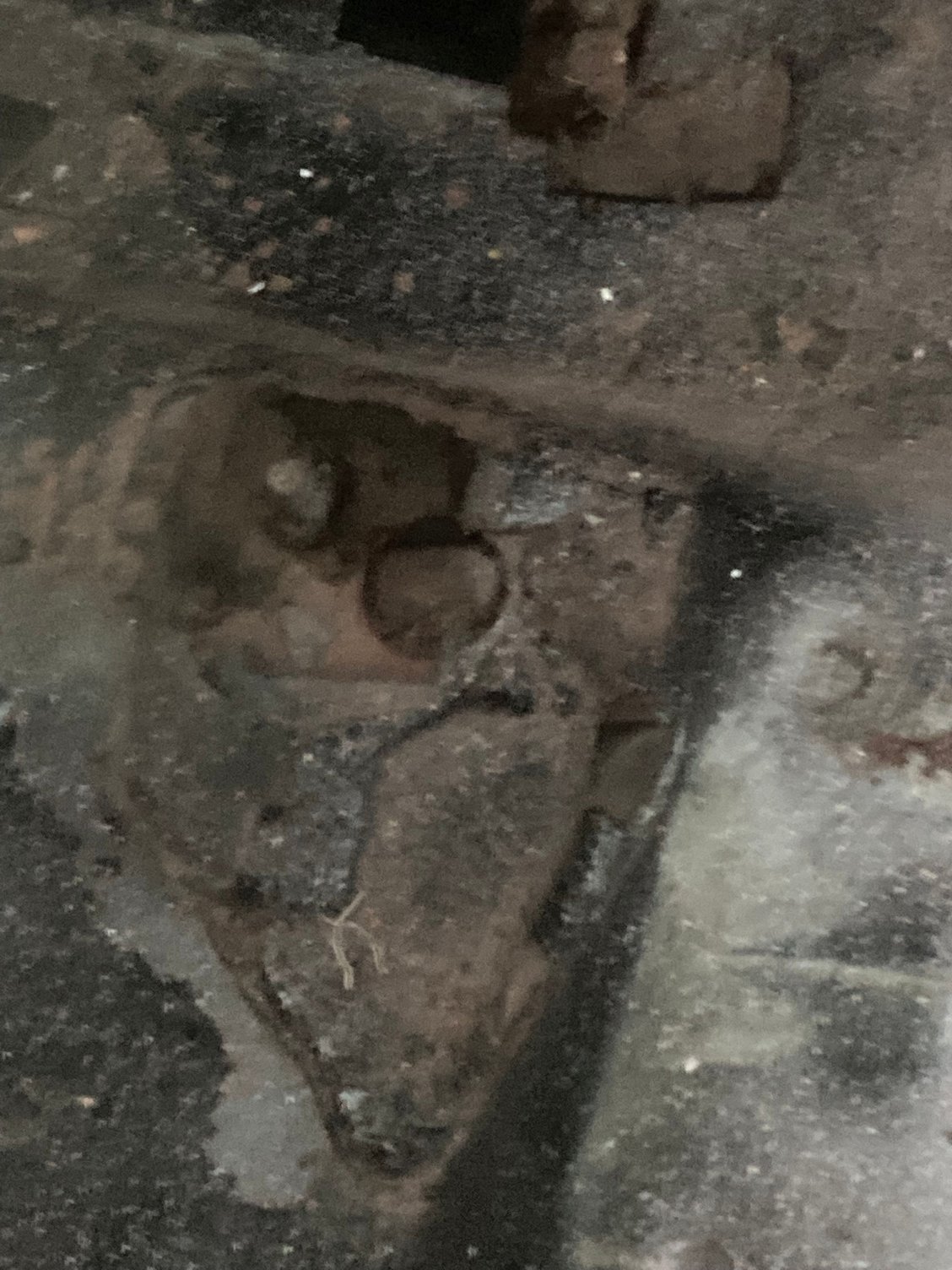

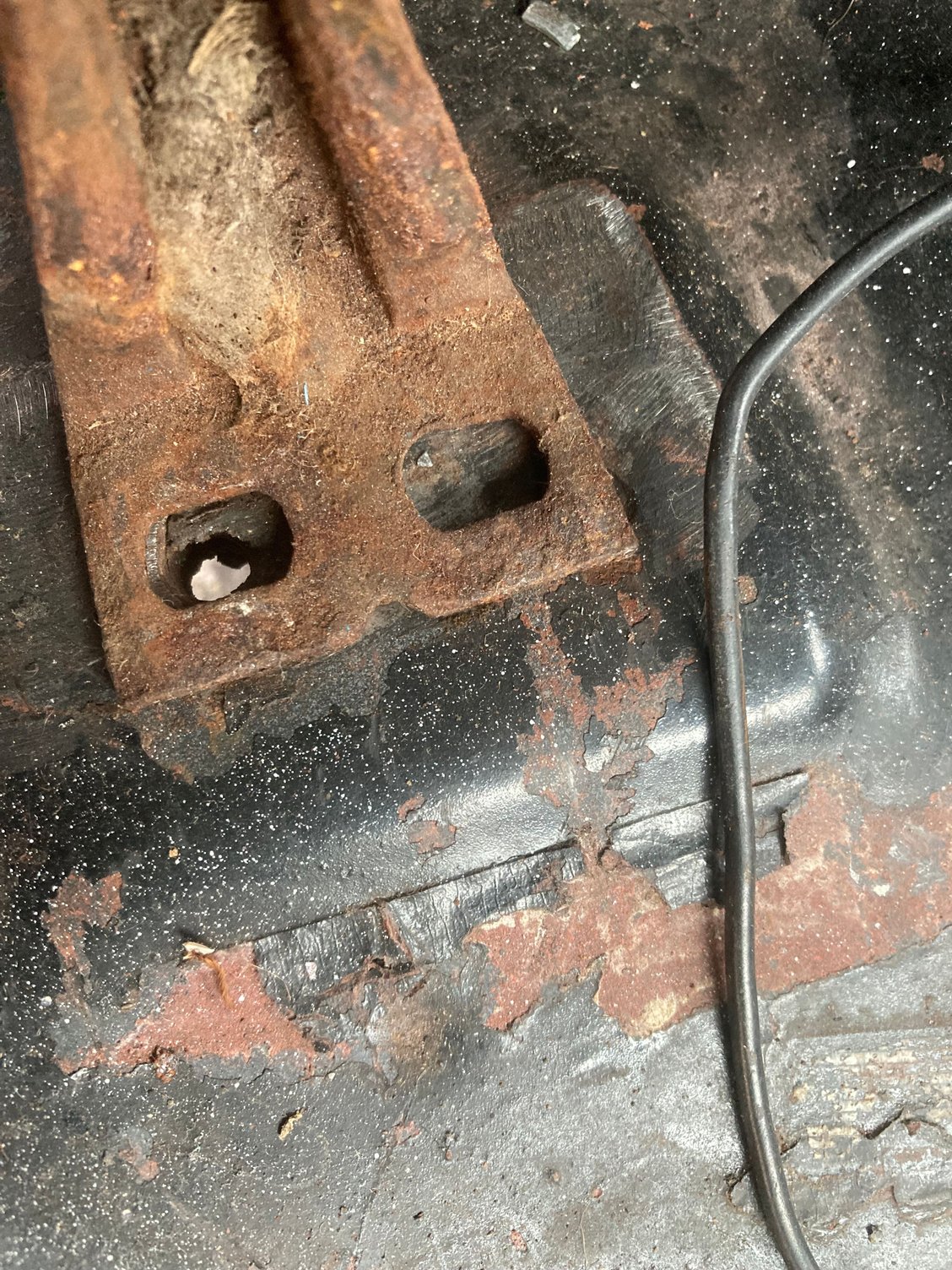

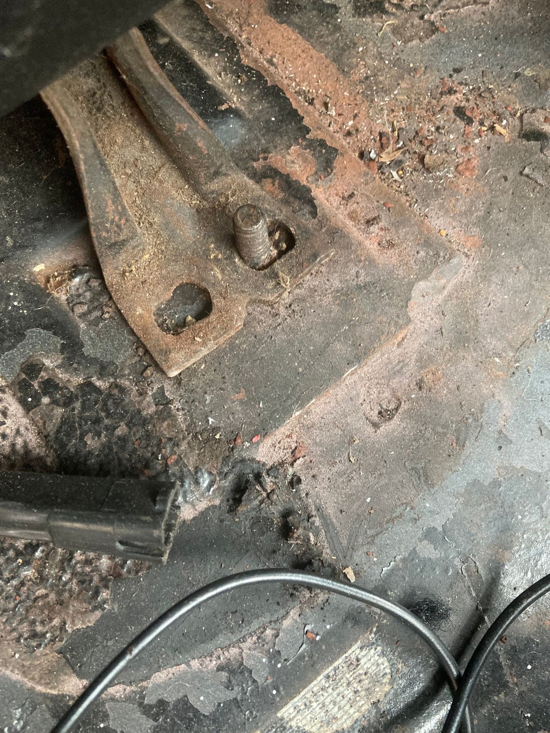

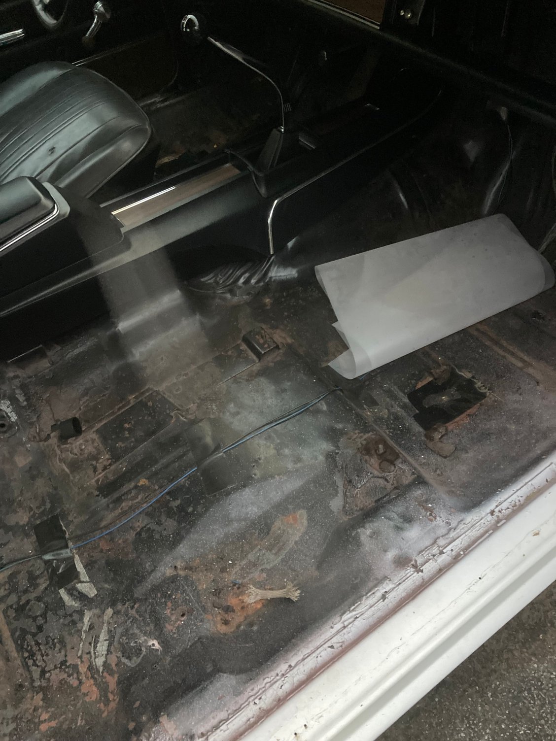

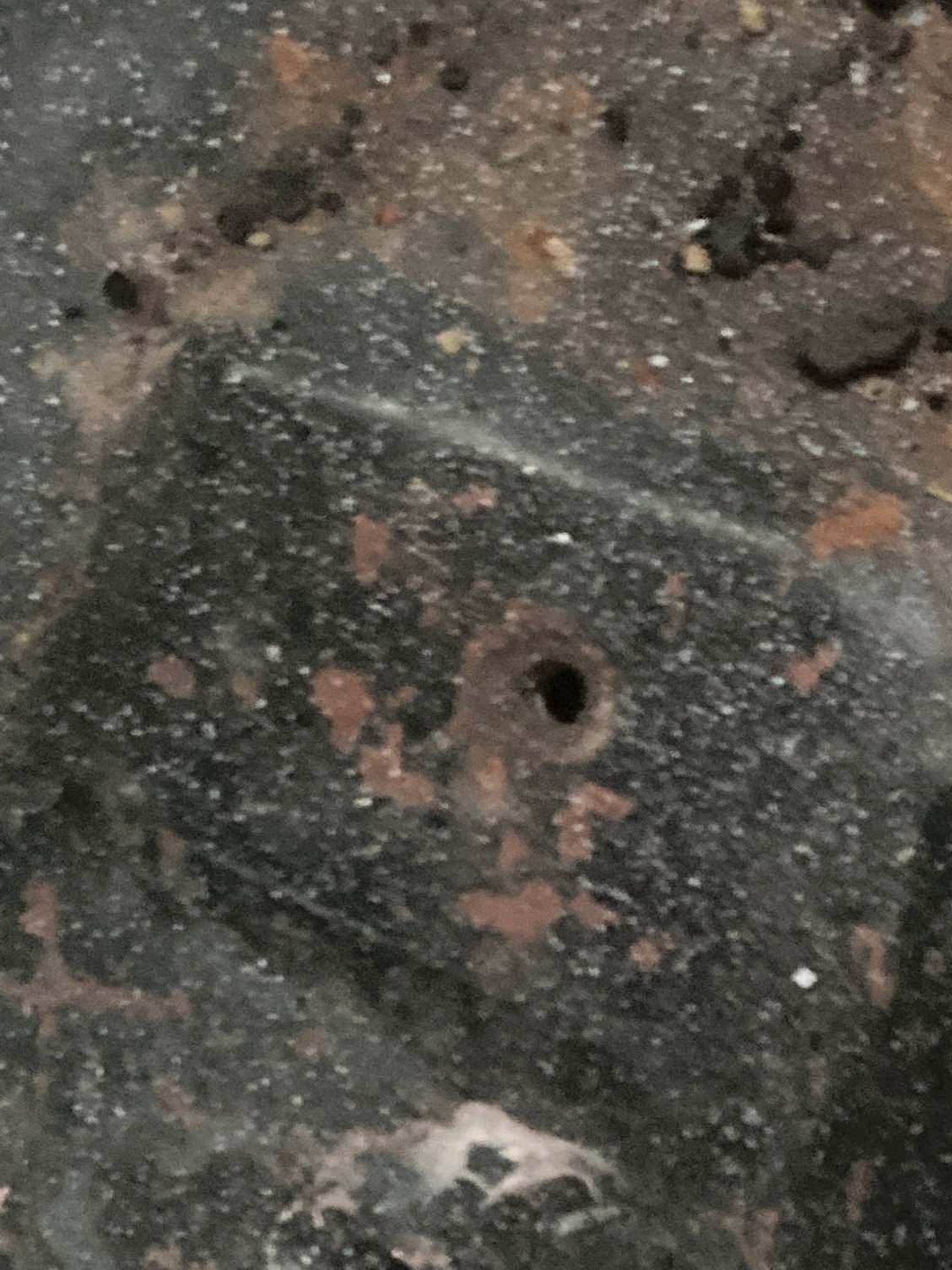

Here are some pics of my 72 cutlass floor. The photos with tracks are on the driver side.
Rear passenger outer foot mounting hole
Front passenger outer mounting stud
Rear driver outer mounting hole with track
Rear driver inner mounting stud with track
