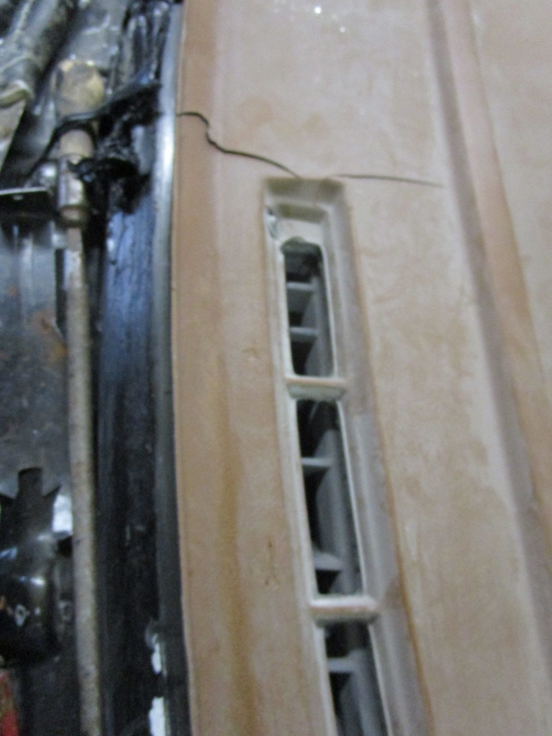

I have a 1979 Cutlass with cracks near where the dash meets the windshield. I pulled the windshield out. Just to let folks know I called Just Dashes who can repair/revinyl it close to OEM. They want $2500. This is not worth it. Like a buddy told me, you could buy a whole car with a nice dash pad for that kind of money.
So have some some research on the internet of what fixes are out there.
Would like some advice on fixes and how they held up over time..

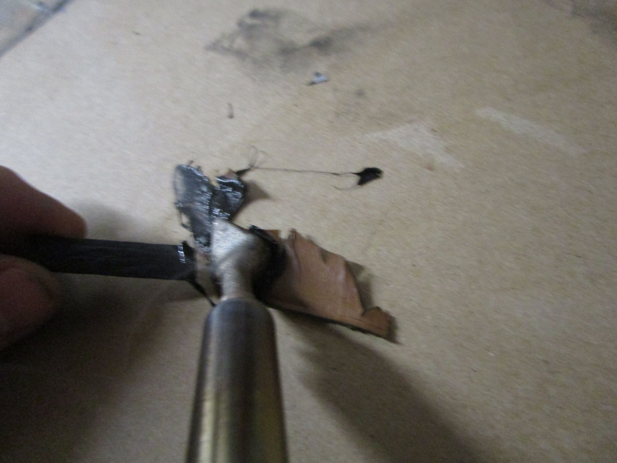

One of the questions I wondered about was how much heat should it take to set the repair vinyl compound.
So watching a lot of repair videos, etc the sellers like the hawk special tools like special heat guns and Irons. One Iron heats to 700F degree. Why question, it is needed to get that hot to cure the compound? I only saw one spec for one vinyl compound that had fiberglass in it, and they recommended 570F Deg. to cure it. I am not using compound. BUt I saw no other spec for other types of vinyl compounds.
I used a old clothes iron which got up to 232F and the Polyvance Iron got up to 314F.
I used both and they both seemed to cure the High Strength Compound OK.
The Fitz's High Strength compound is white, so I sprayed it with some black vinyl paint to see the grain better.
I do not think you need 700F degree to cure it..

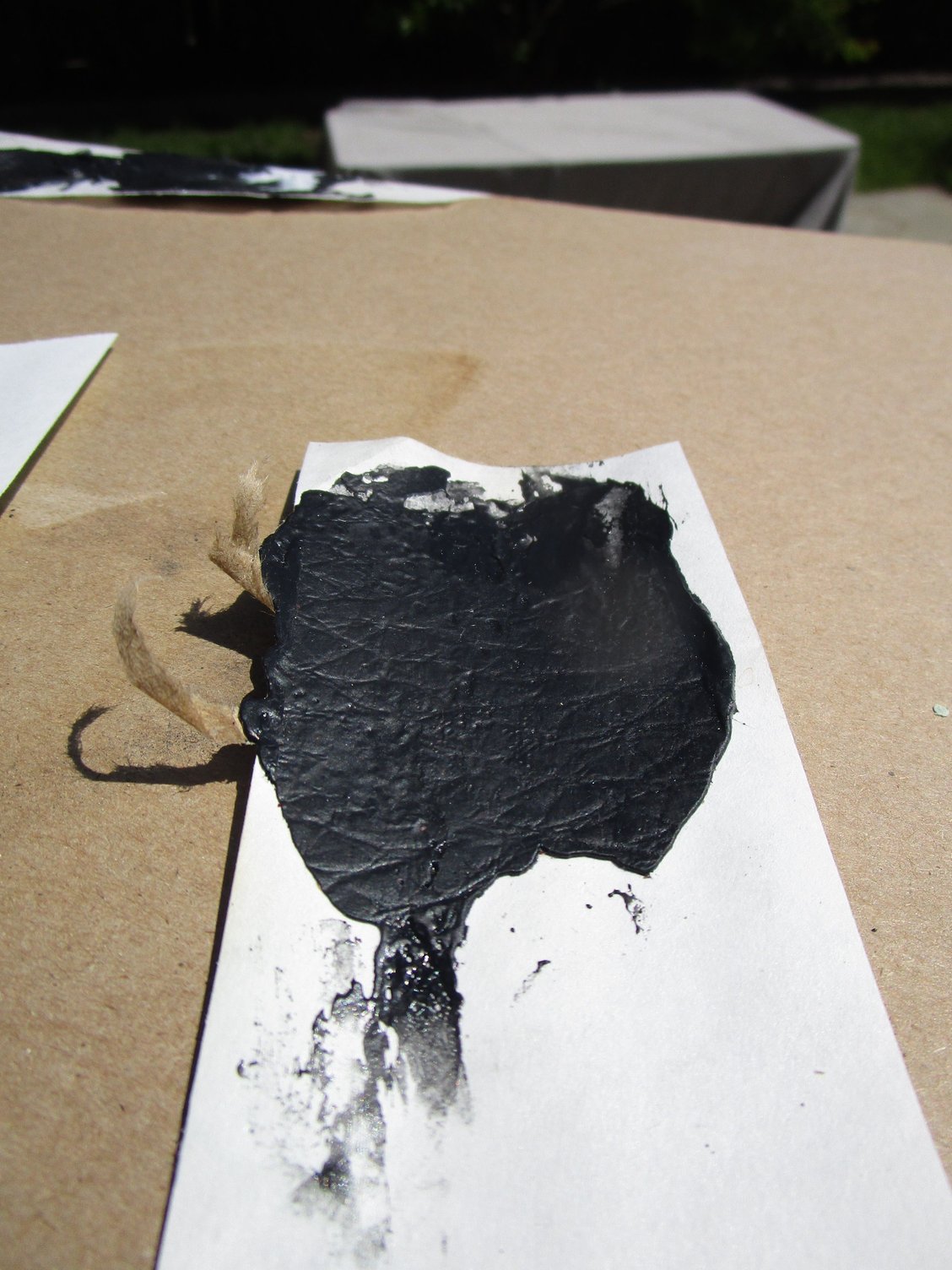

Did some more experimenting with the Polyvance FiberFlex rod
I found that even a clothes iron will melt it, as well as the Polyvance Iron.
I also found I could make a grain in the FiberFlex.
I smoothed out the FiberFlex as best I could, then used a heat gun on the flattened FiberFlex until it just gets shiney, then put the grain paper on it immediately, then put my autobody dolly on it to cool it and smooth out the area. I learned that the FiberFlex is much more sticky then the Vinyl Compound and it is hard to remove the graining paper with out it embedding to the repair. This took some practice to get the right balance of heat, pressure and cooling to get it to grain nicely. But I think the way to go is just with the FiberFlex as it has a very close feel like the original vinyl dash, and only one type of repair material to deal with. Not trying to get the vinyl compound to stick to the FiberFlex. Just using one fix material. It seems more durable and strong then the vinyl compound and hopefully will hold up in the sun. Drawbacks I see is making a nice uniform grain fix, and how well will it blend the graining into an existing dash vinyl repair edge. Blend will probably will not be as good as the vinyl compound as it is thinner. But the FiberFlex does seem to kinda melt into the existing vinyl. I also found that if the grain does not take, just reheat the area and try again.. More experimentation coming up..

OK working on the graining FiberFlex some more
I bought the large graining papers from Vinyl Pro, as with such a large area I am thinking to make a continuous graining as long as possbile without a graining break.. The papers are probably not as durable as the graining pads but could not find a graining pad with as close a match as the graining paper.
The problem with the paper is that , it is paper.
I watched a ton of videos. IT seems there are just two ways of graining with heat.
One is by placing the graining paper down on the smoothed out FiberFlex fix area and heating it by placing a heating iron on top of it, then cooling it with a dollie.. Doing it this way, the paper graining material embeds into the FiberFlex and cannot be removed nicely if at all.
The second, is to heat the smoothed out FiberFlex fix area with a heat gun until the repair area is shiney and uniform, then quickly put the graining paper down and then cooling it with a dollie. Again I found, the paper is difficult to remove and leave a nice grain.
I remembered hearing about mold release agents, did some searches and came up with using PAM cooking spray. OK lets try that. So on the graining side I sprayed some PAM, and swished it around a bit with a paper towel so I had a very thin uniform coating on the graining side of the paper. I heated the smoothed out FiberFlex fix area with a heat gun until the repair area is shiney and uniform, then quickly put the PAM oiled graining paper side down and then cooled it with a dollie. This seemed to work, but as expected there was an oily residue when the paper was removed. Before I vinyl paint it, I'll have to clean the PAM off with some type of wax and grease remover. Hopefully not too much PAM embeded into the FiberFlex so the vinyl paint can stick. YEs , there are some small bubbles in the grain, seems to happen when one is heating the FiberFlex with the heat gun to get it shiney and moldable. Again, not as nice as the vinyl compound when grained, but much more tough. Very difficult to make a dent with a fingernail after the FiberFlex is set. Very dash vinyl like hardness. Standby for more adventures...

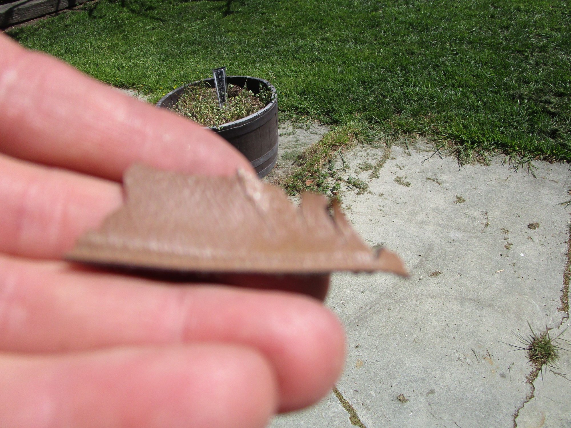

Wanted to see how well the FiberFlex would stick to the dash vinyl, got a small piece of the dash vinyl, sanded right side with 80 grit to see if it would make a difference in adhesion..
So Polyvance says to heat one side of the FiberFlex rod and then flip it over, then melt and press the FiberFlex into the repair area with the iron.. Did that. Let it cool, I tried to separate the FiberFlex from the dash vinyl, seems very stick on it. Did not see an adhesion difference between sanded verses un-sanded areas. Read " FiberFlex is not a true welding rod, but rather a thermoplastic or hot-melt adhesive" kinda like brazing..
