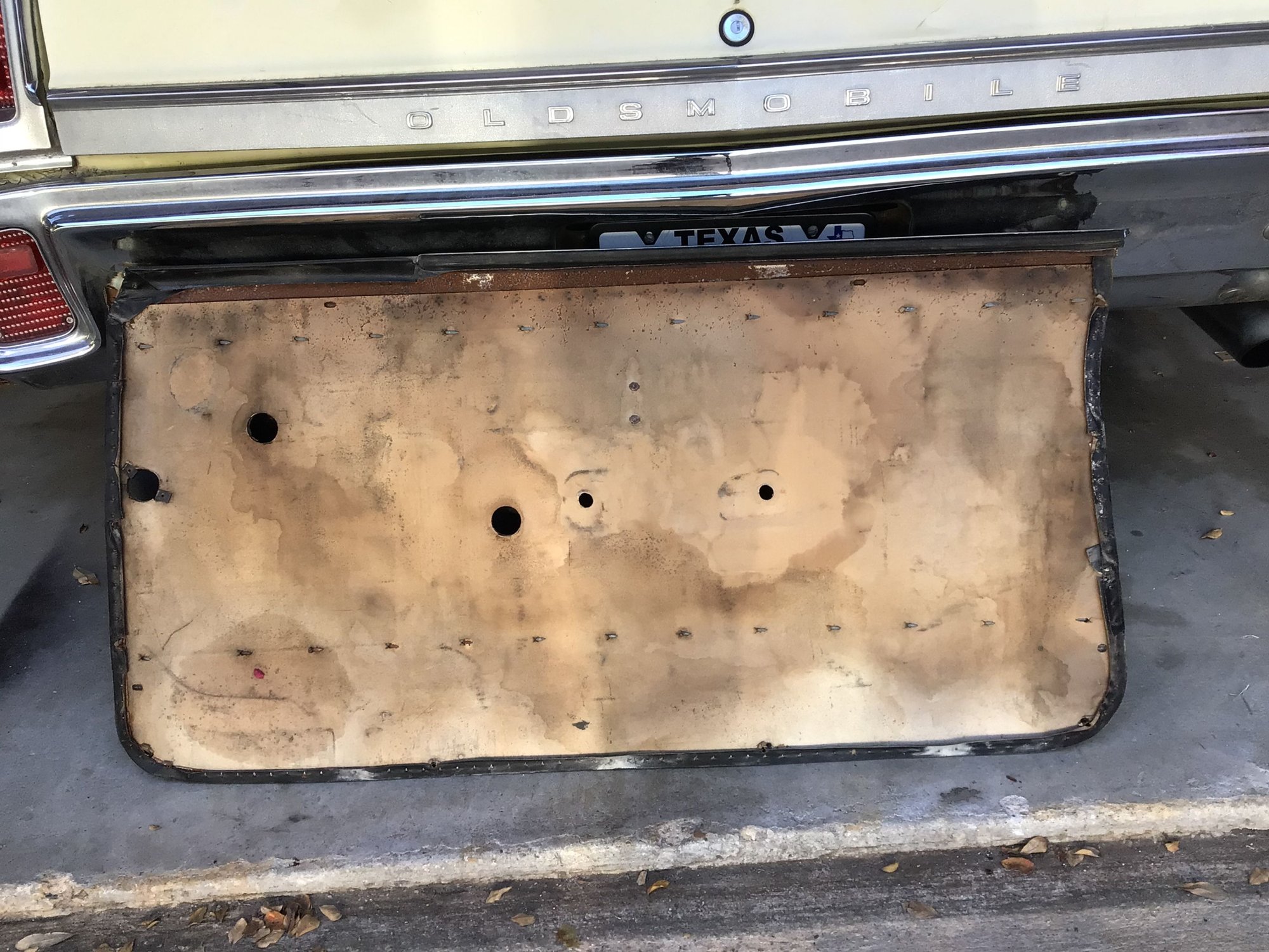

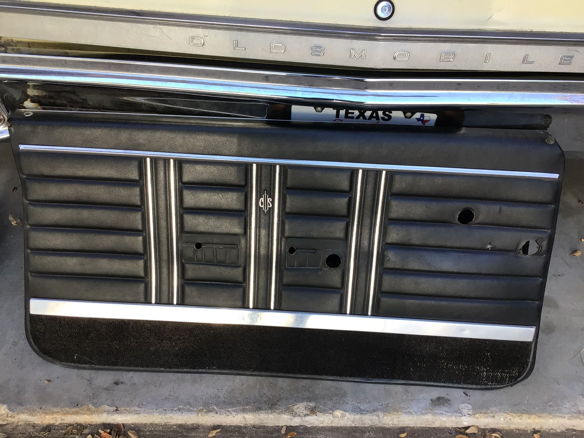

Here are some pics. Original door panels front and back.

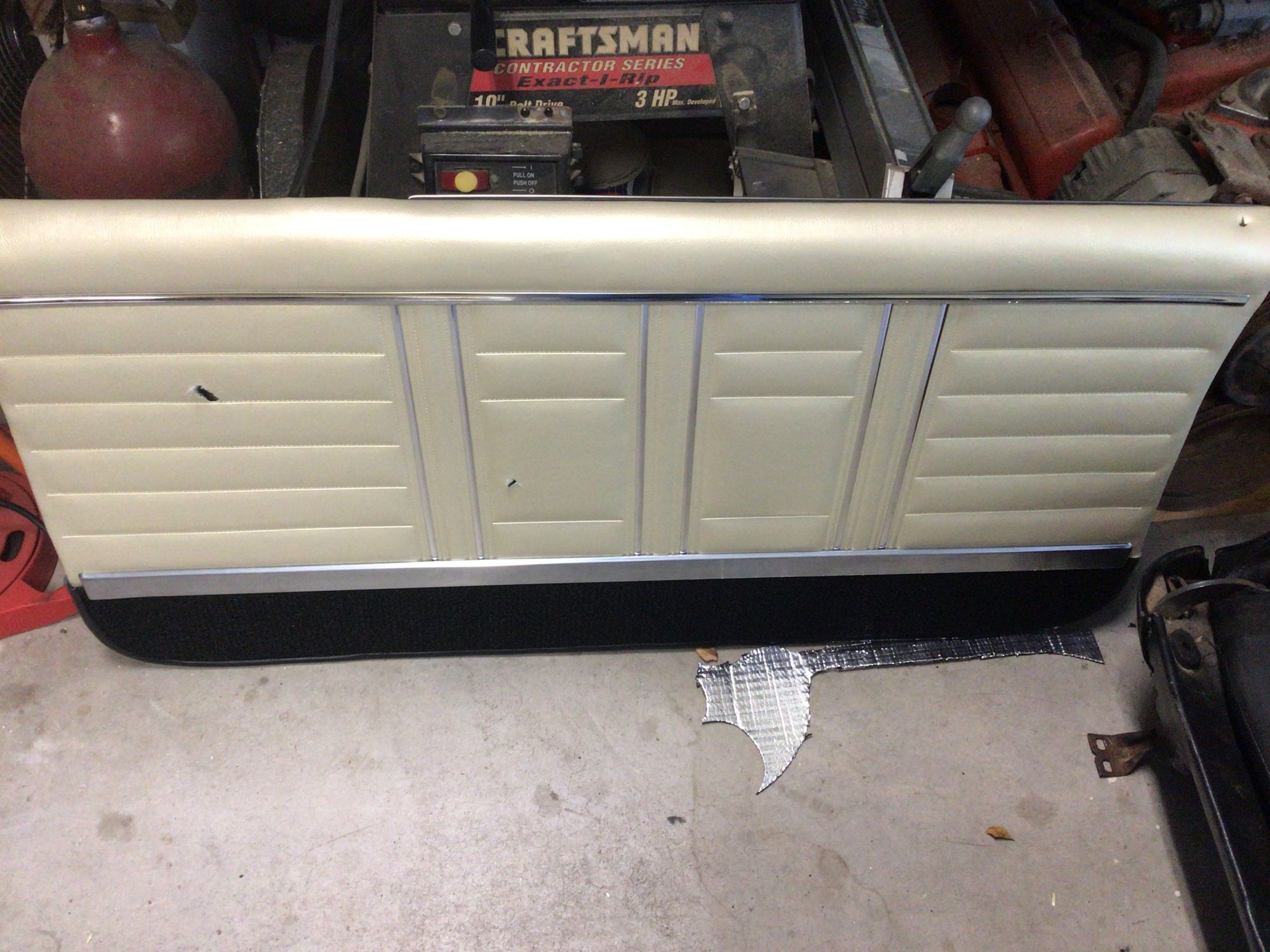

I’ve cleaned them up and painted them, I hope to get the new door panels assembled and installed tomorrow. Here is a pic of the new door panel.

I’ve gotten both door panels built up but I am having the devil of a time getting them installed where all the holes line up properly.

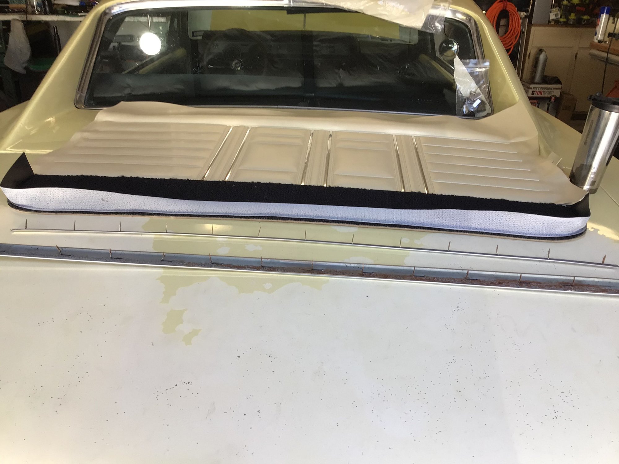

While waiting for seat covers and rear panels,I have installed a new package tray. It came with a black vinyl flap attached that should go behind the back seat. Should I attach that to the metal between the trunk and passenger compartment, or should I attach it to the decider board?
It gets glued to the metal
