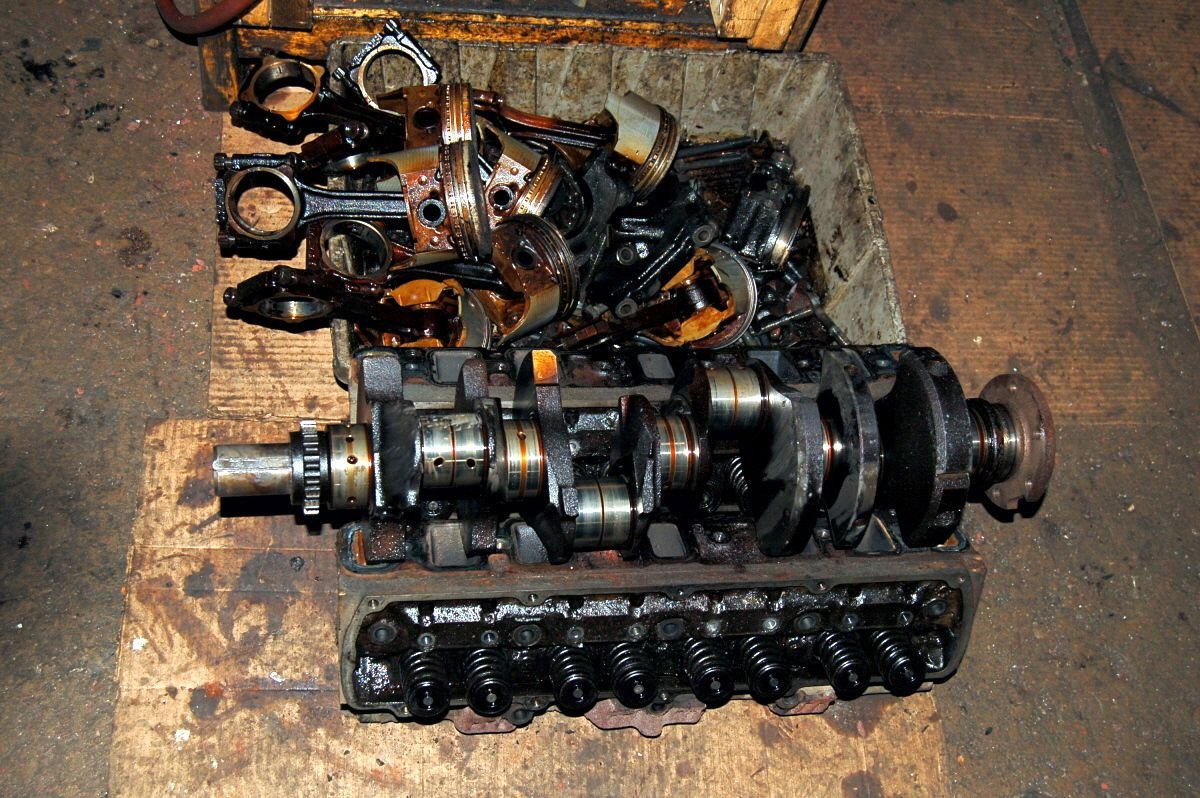

I have to locate my reciept book with the engine specs to be spacific. It is the Numbers matching 350 and was all stock before the rebuild. Car was power optioned with A/C super cool A/C with the high power switch and power windows and breaks. It was also originally a single esxuast car. and was aslo after the rebuild. I switched to the dual exhaust two years later if that helps. I will see if they noted the specifics on the rebuild info. Here are the pictures after the teardown back in 2007 before the rebuild
