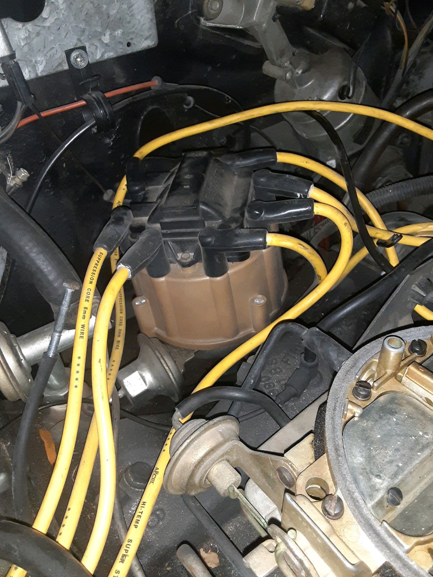

Is it a large cap hei or a stock points distributor with a pertronix installed? Post a picture of it if your not sure.

Old Dec 8, 2021 | 10:14 AM
With the HEI distributor the stock timing settings are n/a. You want to set your timing to 16/18* before tdc. It's hard to do it without a dial back timing light. Then you need to limit your vacuum advance to 10*.

While the recommended timing settings are accurate, it should be noted that in 1976 the HEI was the "stock" distributor as points had been phased out by then.
