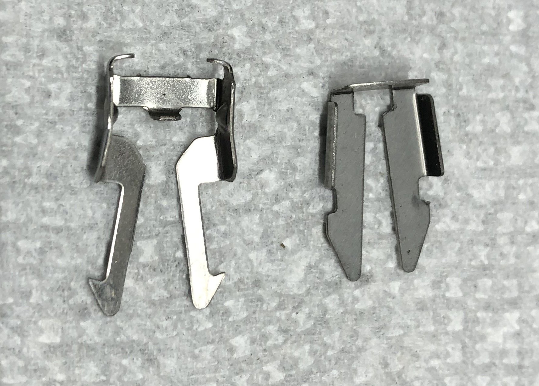

I bought a pair of these about a year ago. The slot on the clip on the refills was too small to fit my wiper frames.
Photo shows clip on last refill, left; clip on new refill, right.
I opened up the slot on the new ones with a Dremel tool and they work great. The slot didn't need to be quite as big as the previous refill was.
