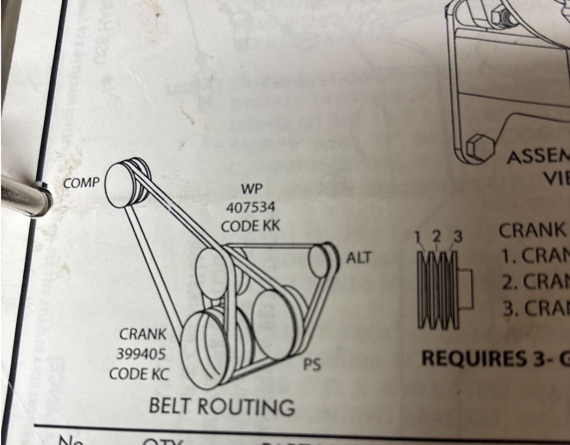

Life has slowed down enough that I can start working on Project Olds-Camino. My goal is to test fire the engine, then mock up all the accessories brackets before final paint and installation.
This car is going to have a vintage Air A/C setup. I went thru my stack of pulleys, I don’t have the correct pulleys as per the Vintage Air instructions. I called everyone’s favorite Olds pack rat Scott Winn, he has the 2 pulleys detailed, however I also need a power steering pulley.
My question: can anyone determine what letter code power steering pulley this combination would use? And based on the pulley codes, what length water pump I need to use?
Old Nov 25, 2025 | 02:04 PM
That PS pump pulley is P/N 399406 KH. I believe that the KK pulley is for a 6.1" pump. KF would be the pulley for a 5.6" pump. The other two would be the same. Note that KK is smaller in diameter than KF, so the pump would turn faster.
