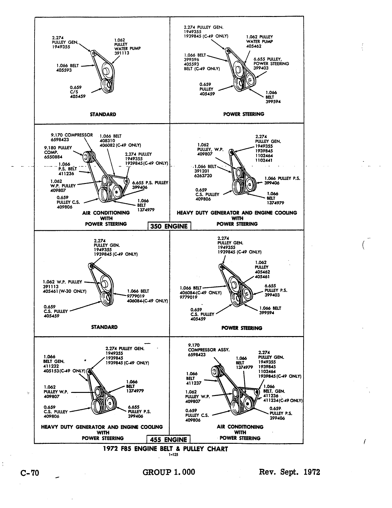

Old May 8, 2020 | 01:53 PM
Posts: 50,770
Old May 8, 2020 | 02:03 PM
Posts: 50,770
I don't know anything about what Vintage Air recommends. The factory crank and water pump pulleys you can see on that chart I posted. 409807 water pump pulley is KE. I don't have the code letters for the matching 409806 crank pulley. The 1968-71 cars with the 6.1" long pump used 399405 (KC) crank pulley and 399404 (KF) water pump pulley. These should be functionally equivalent to 409806/409807.

Sparkey:
I have a '72 442 convertible with a 350, the 409806 crank pulley should be stamped "KB".
Rodney
