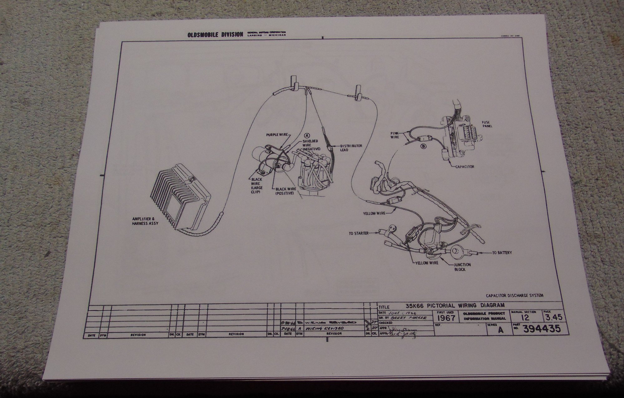

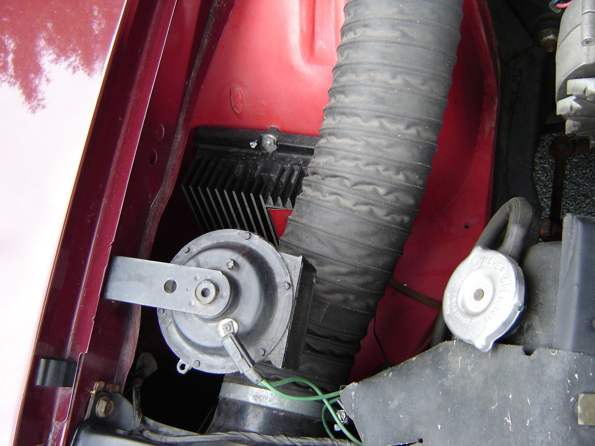

I have a 1967 Olds 442 that I want to convert to the UHV. I have all the parts to do this.
I need Photos of the amplifier in place on the car, how the wiring is routed. Also
need drawings or diagrams of the wiring and how to hook up the wires to the existing
wiring on the car.Videos, Photos, Drawings, scanned documents are needed!!!!!
Thanks
Greg

It's not in the 1967 CSM?
Old Mar 25, 2023 | 06:29 PM
Posts: 50,802
No, it's actually in the 1967 Product Information Manual. Section 12, Pages 3.45 through 3.47

Hairy posted a couple pics for you. Send me your email addy and I will send you everything scanned from the CSM and the PIM. My email addy: oai67p@gmail.com

Thanks.... This is the first actual photo I have seen of the amplifier.
