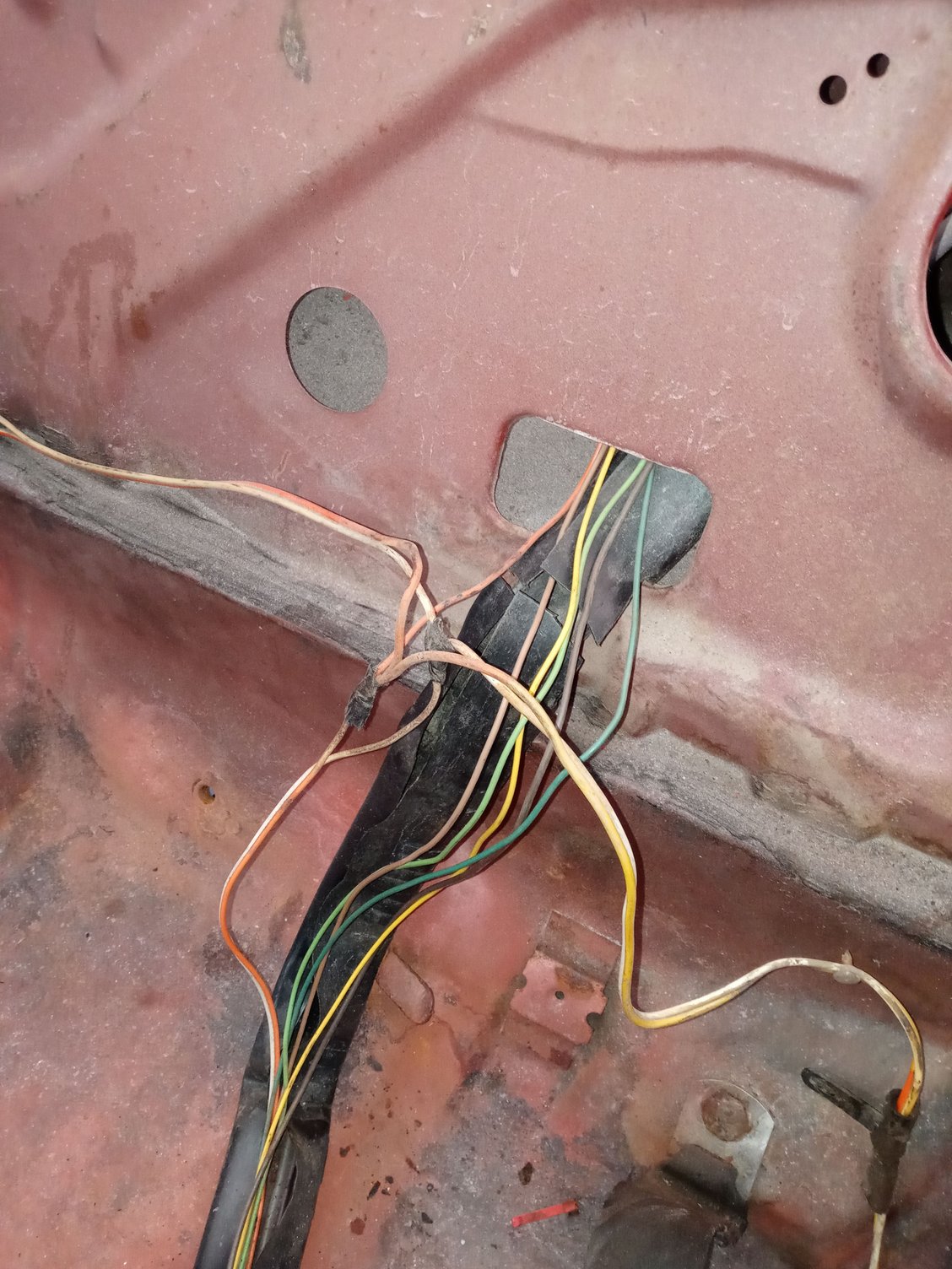

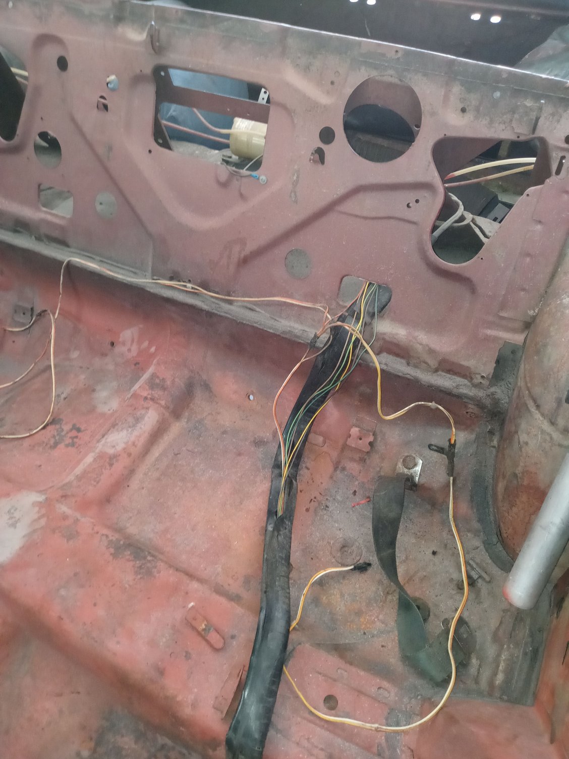

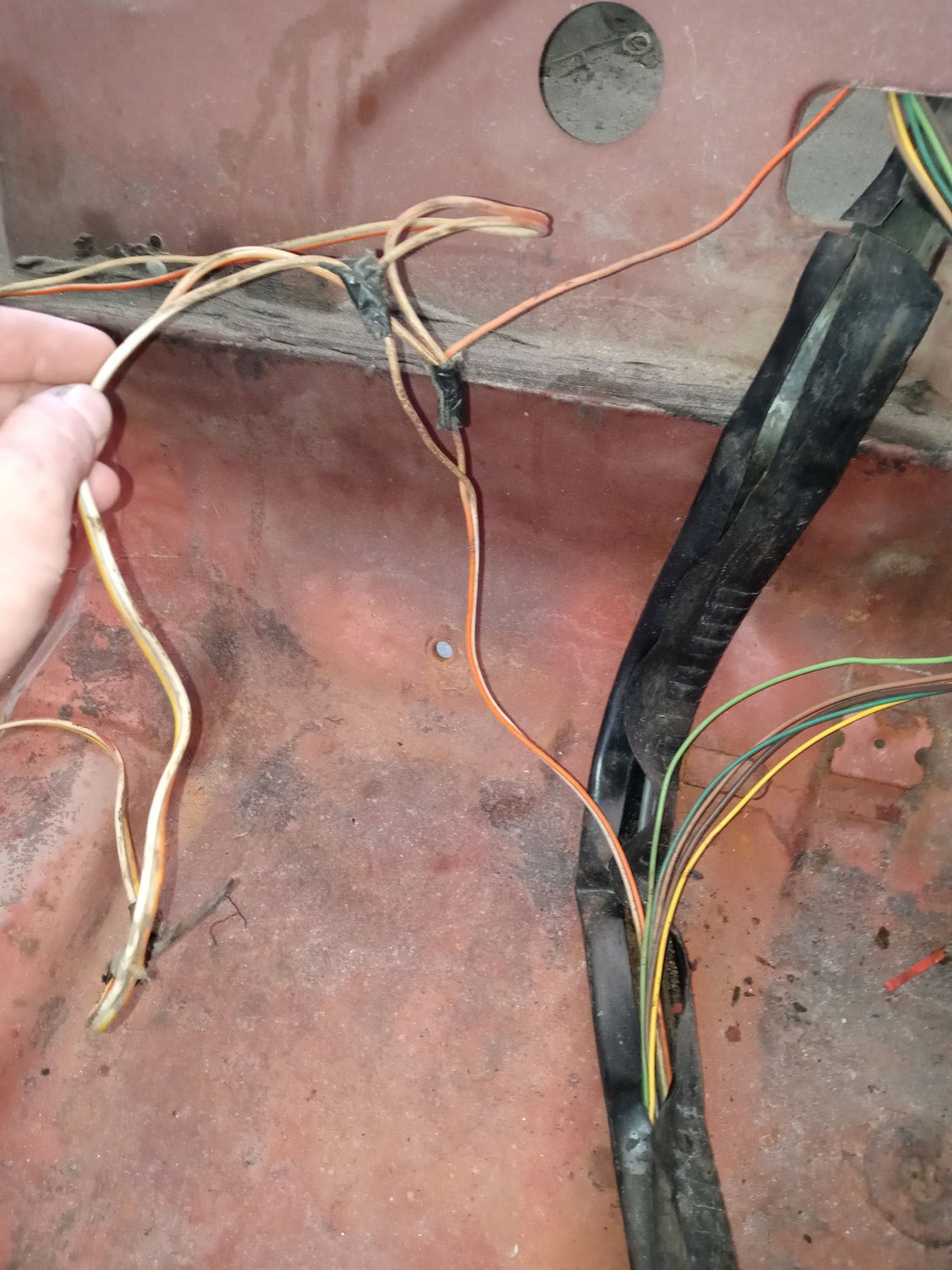

Hi guys will some1 please tell me what this wire is, it runs from under dash 2 trunk, its orange/white some1 spliced into it and ran 2 wires off it, I was thinking rear speaker wire but im not sure, thank u

Those are wires for the courtesy lights in the rear arm rests on your convertible. And the "splicing" is factory correct. One orange wire runs to the trunk courtesy light.

wow thank u!!!!!! I thought it was rigged up it looks so junky, thank u very much 4 the help
