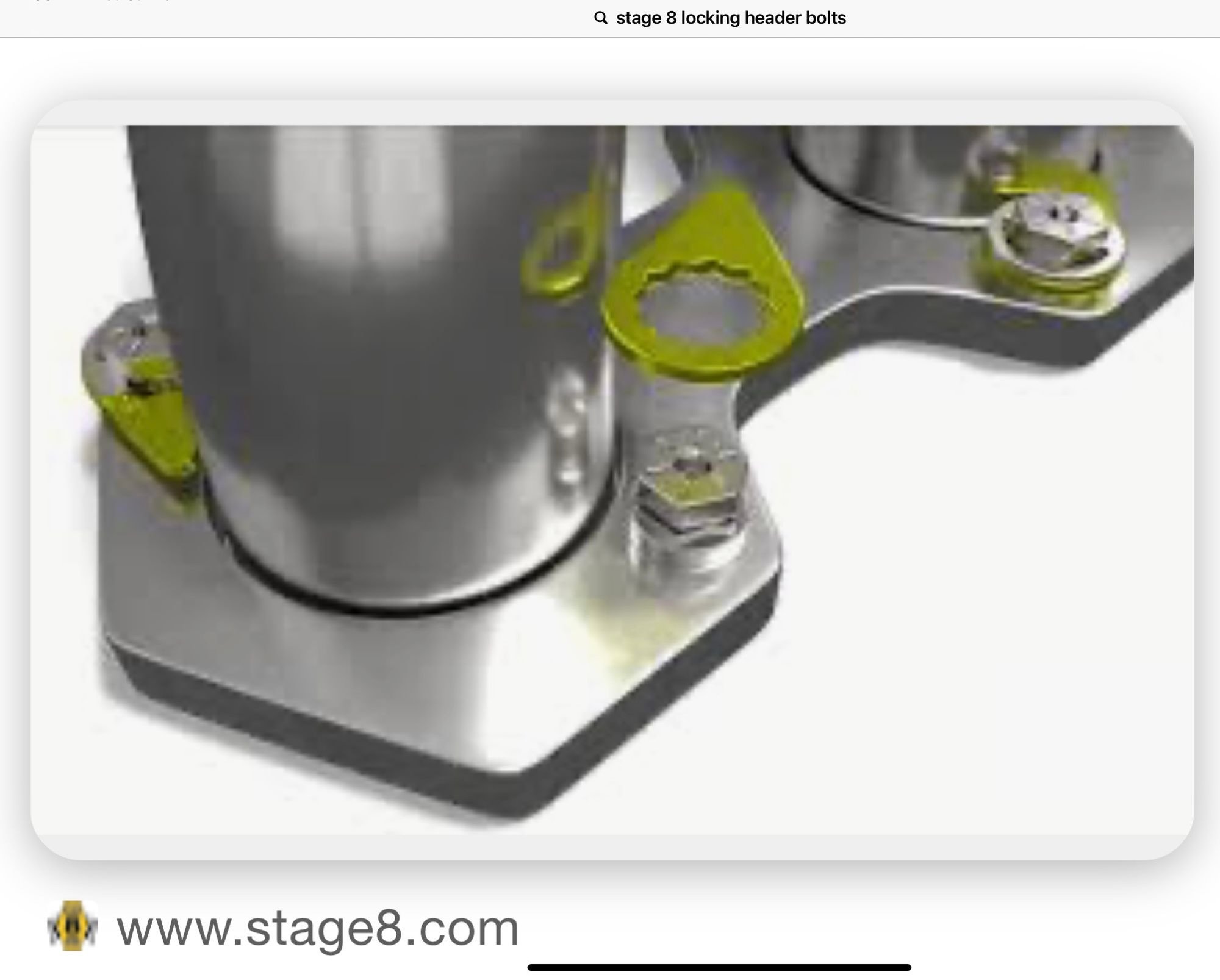

Good gaskets and stage 8 locking header bolts stop the leaking at the head, The collector if I use the 3 bolt flange I use a copper gasket. good hardware grade 8 and two nuts per bolt so it can't loosen .

How do these "locking bolts" lock ? Wouldn't lock washers work ?
yeah that

Yeah, Stage 8 hardware all the way.
