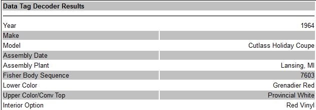

Can someone decode this tag? Thank you

This is a SWAG....looking for others to validate or invalidate.
The build date looks like 12A, if it is, that would be the first week of December (1964).
Accessory Group 2: Y-L-G
Two Tone Paint: V-C
4-speed manual transmission
Center Console
Old May 13, 2023 | 05:43 AM
First week of Dec 1963, since the car is 1964 model year.
Old May 13, 2023 | 05:52 AM
Posts: 26,056
Oooops...thanks, Joe.
Old May 13, 2023 | 05:54 AM
I'd be lying if I said that I'd never done that.

This looks like the trim tag from the faux 442 the gentleman has for sale on this forum?
https://classicoldsmobile.com/forums...2-sale-171821/
Old May 13, 2023 | 01:32 PM
harleyrules's Avatar
Joined: Oct 2007
Posts: 281
From: Pine Ridge Florida
Yes it is that vehicles trim tag.
