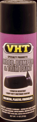

I've found 2 products that work well for plastic.
1. Duplicolor black vinyl dye
2. Bumper/trim paint - eg
Clean the plastic really well with oven cleaner, degreaser and/or light abrasives like scotch bright. It will lightly scuff the surface which is what you want to do. Make sure the surface is clean/dry/scuffed and then shoot it with a black plastic trim paint. Have a look at how it worked on my transmission inspection cover:
Gassed - Inspection cover restoration

I agree Allan. That Cherokee Black paint I rant and rave about is a SEM bumper paint.
