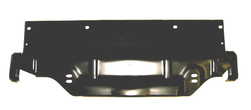

whipping a dead horse,
Just another question does anybody have a picture of a factory correct 4 core plate? I saw this at the Parts Place
is this correct for a 1969? I know I could modify the top plate as shown, but I was thinking if this is correct why now, and a picture of the shroud would be good too I know someone said they are the same, but Mine is cracked and if I can't find a reasonable used part I would grab a replacement part.
thanks in advance.

I'd be in on that also!! If it works for a '70 also that is. I'm much more comfortable just getting the parts as opposed to fabbing and all, I don't know how to weld either so this would be great to just get the items I need this way.

Only The Top portion
John it is only the top portion you will still need to get the two proper size saddles for the bottom, these could be screwed in with self tapping screws into the core support if you don't want to weld.

Please excuse my ignorance and also for whipping this dead horse, Is there a different core support for a four row radiator? I have never heard that.
And does anyone have a picture of a 1969 4 core top plate, that is original?
much appreciated.
eddie

Just to create more turmoil --
1.270 Support, Radiator Core (Complete Assembly)
68 L6, F85 350 Eng. &/or C.A.C. exc. H.D. Cool. or H.D. Rad., 400 Eng. exc C.A.C., H.D. Rad. or H.D. Cool. 402272
68 F85 350 Eng. H.D. Rad. or H.D. Cool. exc. C.A.C., 400 Eng. C.A.C., H.D. Rad. or H.D. Cool. 402274
69 3200, 3600, 4200 exc. H.D. Cool. or H.D. Rad. 402706
69 4400, 4800 exc. H.D. Cool. or H.D. Rad. 402706
69 3200, 3600, 4200, 4400, 4800 H.D. Cool. or H.D. Rad. 402707
69 4400, 4800 400 Eng. C.A.C. exc. H.D. Cool. 402707
- Eric

But as it is a complete assembly I'm assuming the difference is the bottom saddles and top plate lol

Probably. But I honestly don't know for sure.
I only ever had one Cutlass, and it was a running, driving wreck.

^^^This. The bottom saddles are spot welded to the core support, so that assembly has a different part number for a four row vs. a two or three row.
Oh, and John's car is a 70.
