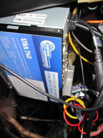

Here's my install, wrapped some duct tape around strap, edges were sharp.
direct fit into dash, no mods.
from below, lower dash is out.
support strap.
rear of radio.
