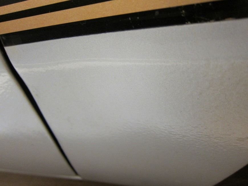

Here's a closeup picture of that factory rockguard junk on my 85 442. Note the care and perfection that they used to tape it off. Not.
Rear of wheel well on my gray 85 442 I used to have with the original rockguard. Tape lines are dismal.

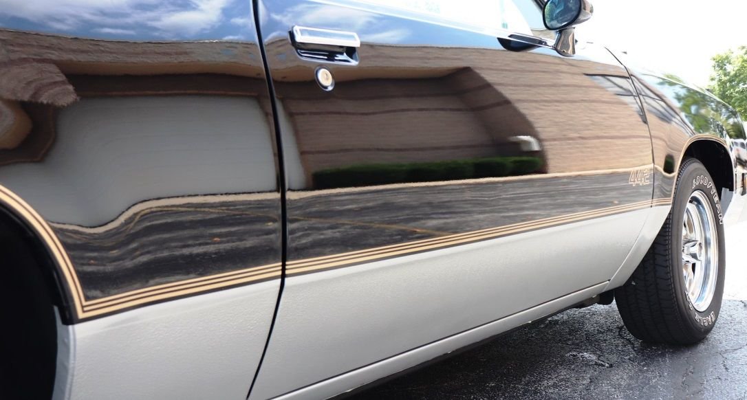

And an original paint 85 442 that is not mine between the wheel wells. Look closely for the tape line. The degree of reflection obviously depends on how rough the surface of the rockgaurd is. Again, no rockguard in front of the front wheel well.
