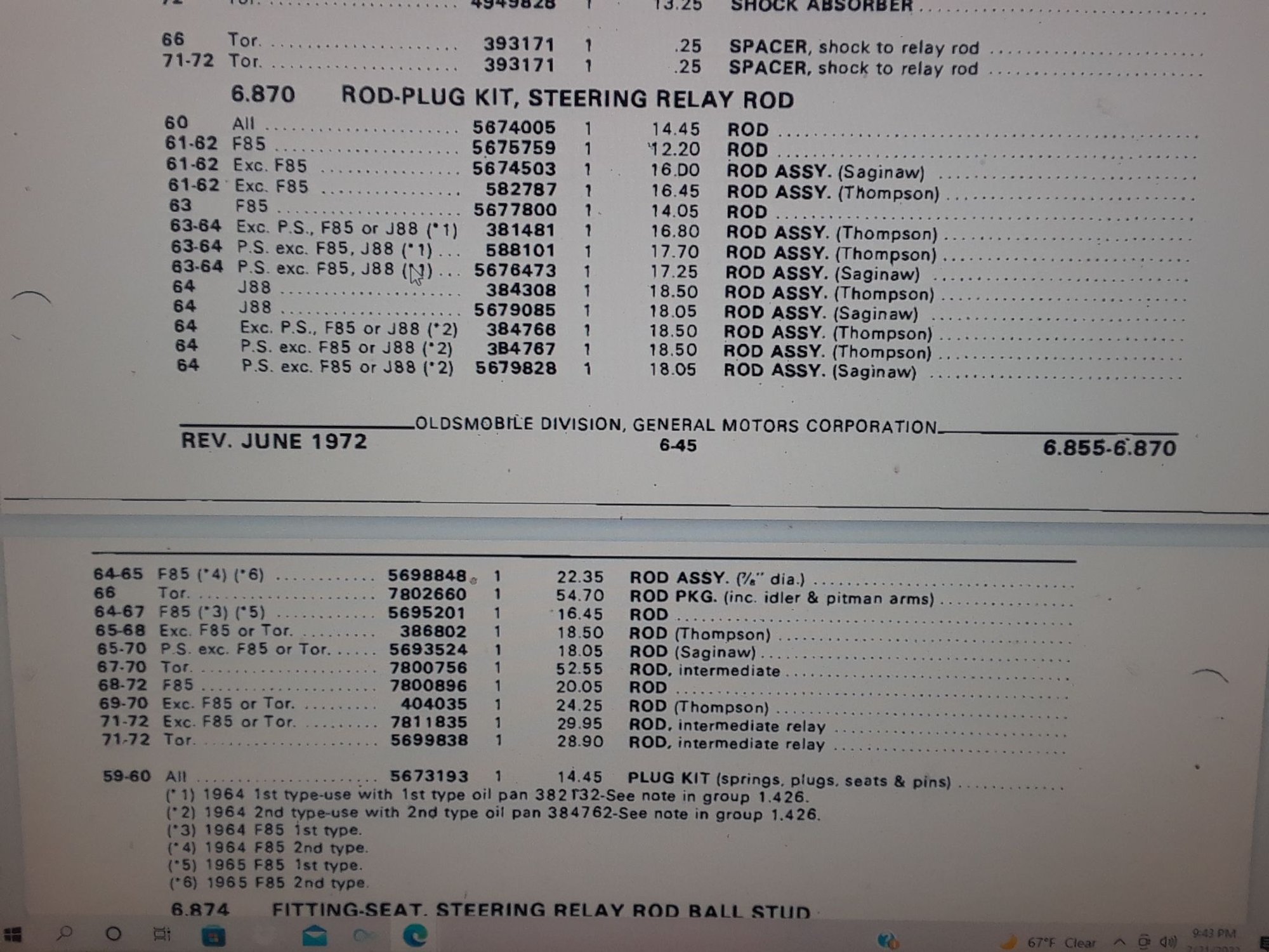

I'm going to assume this is an F-85 or cutlass.
Yes, the OP will need a power steering pitman arm.
There were two designs of pitman arm used in 1964. And the difference was in the diameter of the relay rod ( center link ).
He may need to change both the pitman arm and the relay rod

The pitman arm is different because the shaft on the power box is larger than the one on the manual box. Be sure you get a pitman arm for an Olds. The Chevelles can vary.
Yes correct I'm looking do a power steering upgrade on my 64 F-85 cutlass convertable. Thanks
