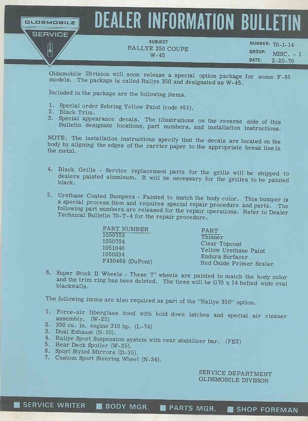

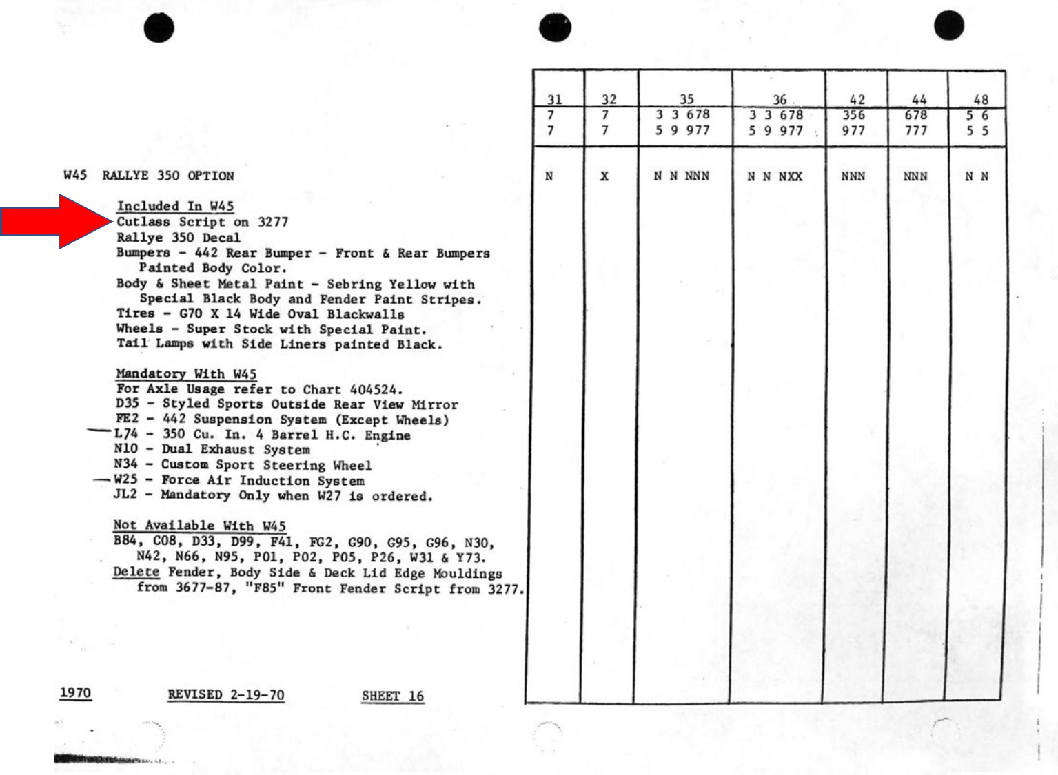

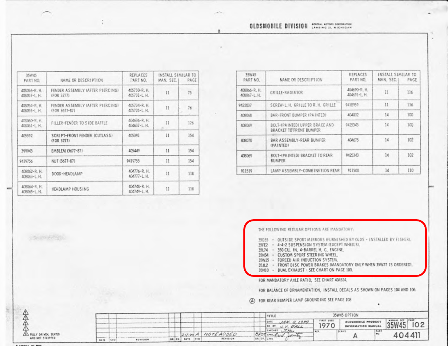

The wing was standard equipment on the 1969 H/O. The RPO W35 wing was a mandatory option on the Rallye for part of the model year. This Dealer Information Bulletin from Feb 1970 shows it.

This page from the PIM from Jan 1970 does not show it.
This page from the Info Kit dated Feb 1970 also does not show W35 as mandatory.
As far as availability on other models, RPO W35 was an available factory option for the 1970 and 1971 model years. It was also available as a dealer-installed kit.
