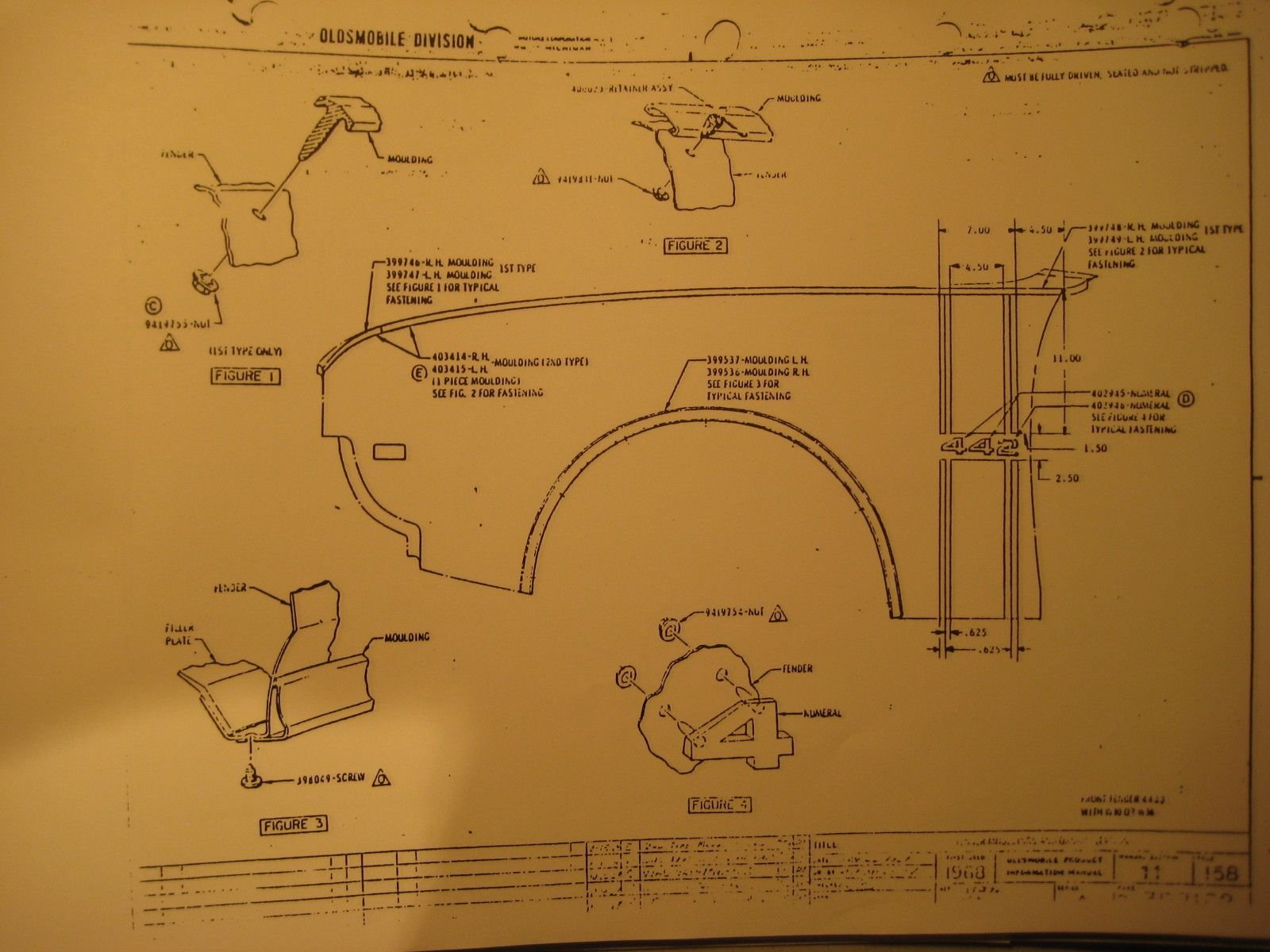

I’ve posted the assembly manual page of the correct W36 stripe placement on the OCA FB page more times than I can count and people still argue with me.
Bah, what would the factory know. You know, the one that built these cars.
