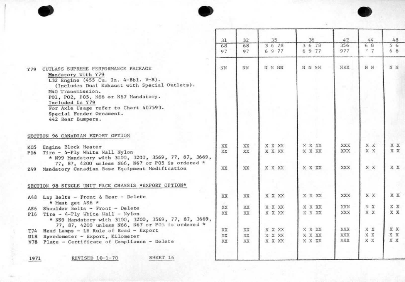

What was included in the Y79 package? 71 Cutlass Supreme SX

From the 1971 SPECS booklet:

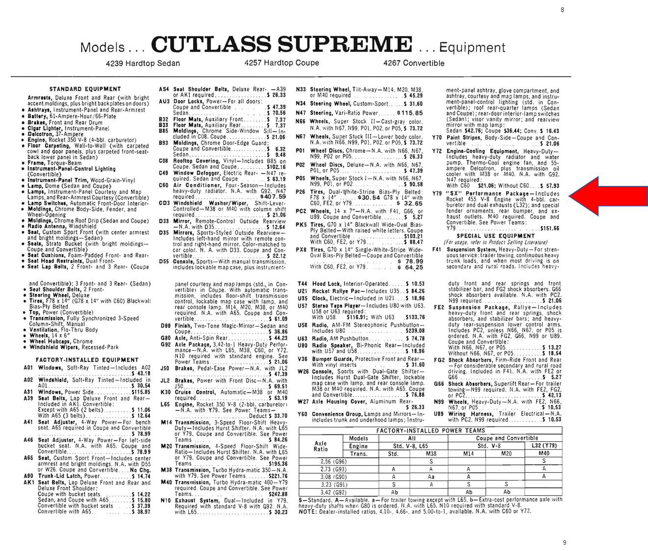

More selling info:
