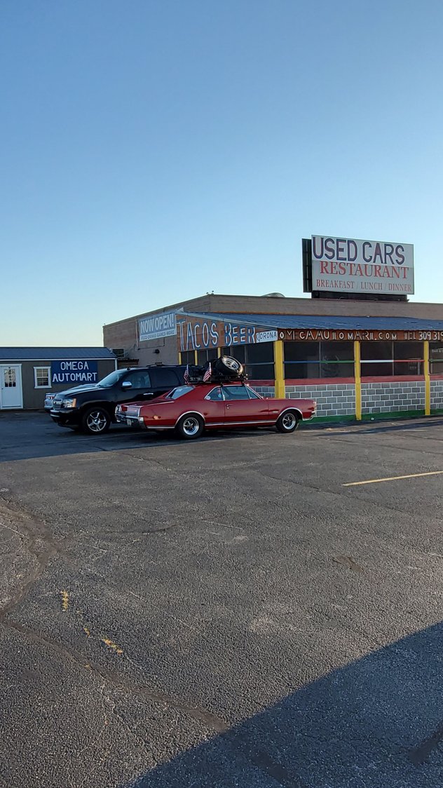

My "upgrades" just went 2400 miles in 7 days, raced 5 of the 7, and averaged 11.78@120 on Hot Rod Drag Week. Have fun with your Curved Dashes.
somewhere in Illinois

What's your point? My four wheel drum brakes, manual steering, 14" tires, and original RH5 trans went 2700 miles in 9 days for Power Tour. This one's at Norwalk.
And as I said above, if you have increased electrical draw with fans, fuel pump, EFI, 8 gigawatt stereo, etc, yeah, you need to upgrade the alternator. If not, it's frankly a waste of time and money. I'd rather spend mine on go-fast parts. Also, given the number of posts here and elsewhere by people whose "upgraded" four wheel discs stop worse than their drums, or who admit that they run screaming like little girls if electrons are involved, a poorly-executed "upgrade" really isn't.

Man, hard to argue with that! Great trip…..
