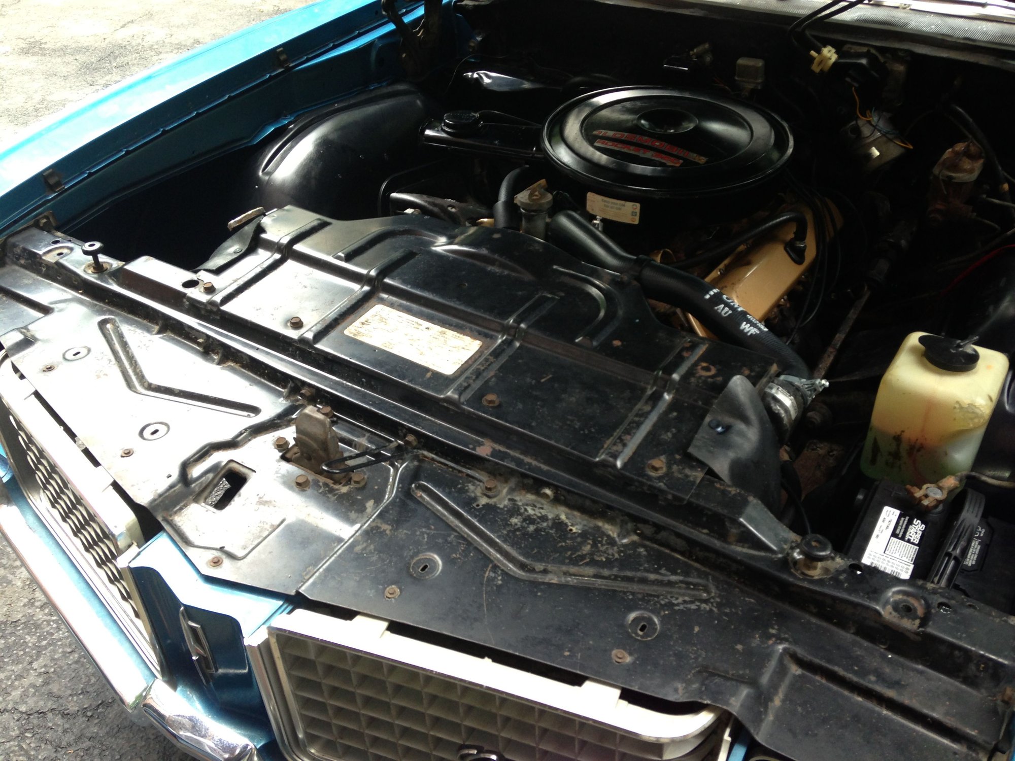

70 is unique among the three. '71 and '72 are very similar except that the '72 has small raised areas to accommodate the "outie" shape of the '72 Cutlass S and Supreme grilles. The '71 is flat in that are since the '71 S and Supreme grilles are "innies". See the raised humps above the outside of the grilles on my old '72 Supreme.
