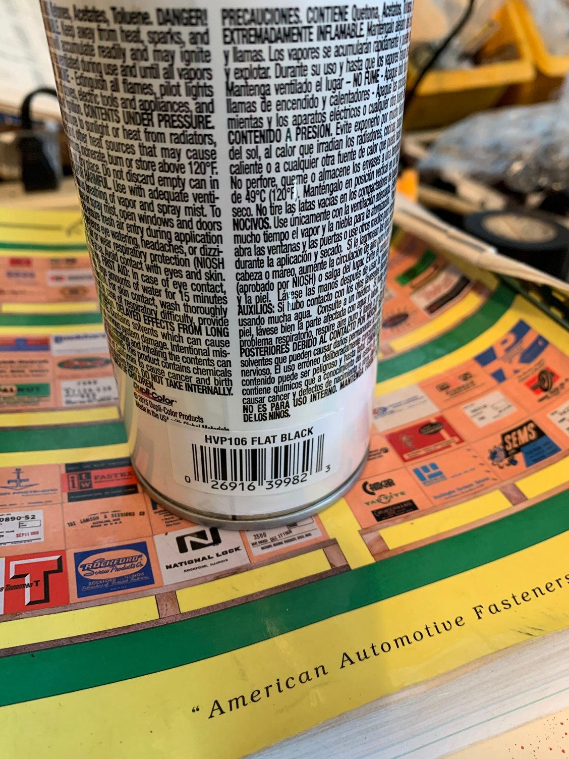

Here is another option for flat black. I had this for small parts. Never tried it on a dash however. Label says it’s for dashes.

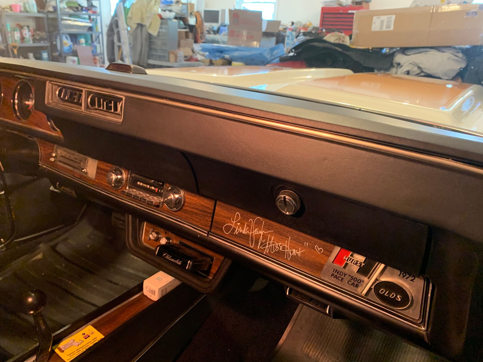

Tough to get a hood picture with light in garage but this is 72 Hurst I painted 4-5 years ago with GM method. Still looks new.
Old Feb 26, 2021 | 09:56 AM
Jungle Cat's Avatar
Joined: Jan 2021
Posts: 371
As good as it gets with the drop light.
