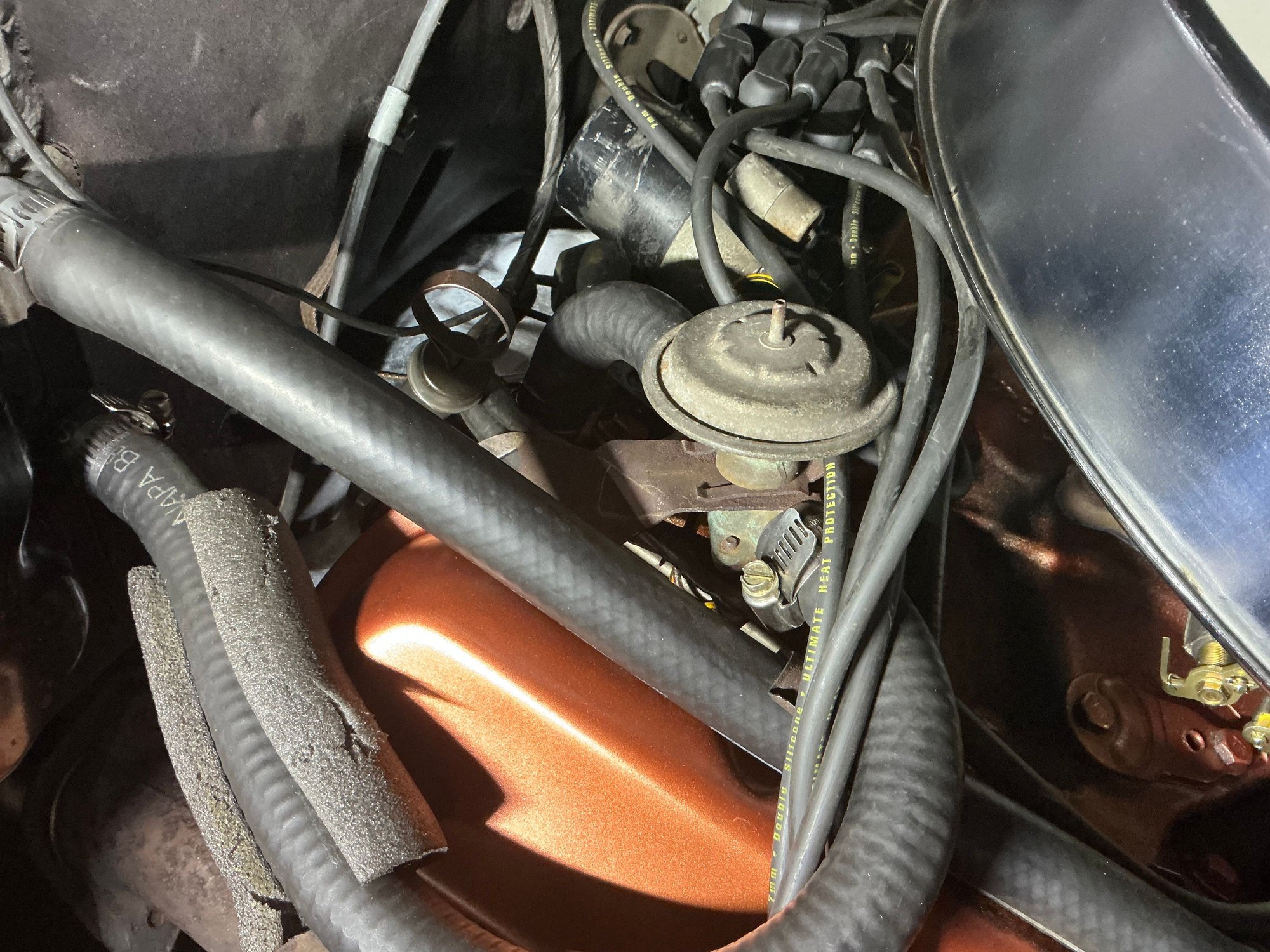

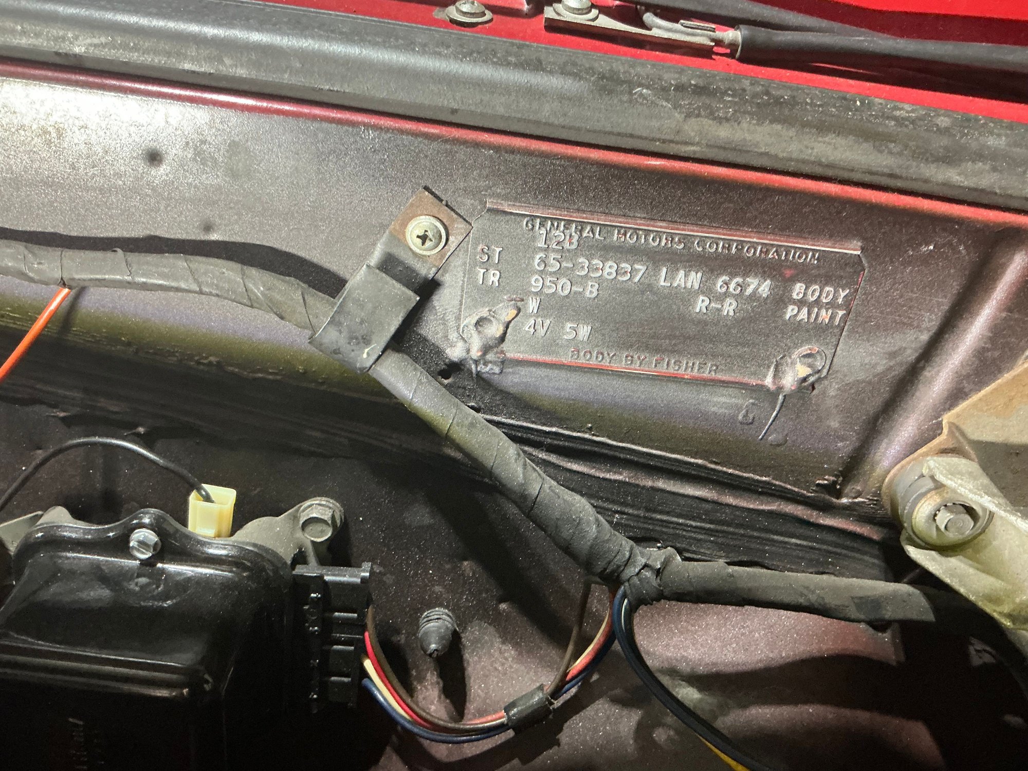

Does anyone know why I have this valve on my heater hose? It’s a 65 “442” no A/C. It’s not connected to anything. Took a pic of cowl tag, anything unusual? Thanks for your help.

Oldsmobiles used a valve on the passenger's side head for years. This restricts water flow to the heater core when it's not needed. There are plenty of threads on replacing the valve and electrical switch on our forums 👇
Even my 96 98 with a 3.8l v6 had a valve between the block and the heater core.

Called heater control valve. USUALLY this was with cars with a/c to turn off the hot coolant going into the heater core..
Old Mar 13, 2026 | 06:15 AM
The valve was used on non-A/C 1965 cars with V02 HD cooling as a restrictor. Apparently this was a stop-gap measure. Later cars used the restrictor nipple instead, which was obviously less expensive on the production line. Note in this page from the 1965 PIM that view B in the lower left showing the heater valve as a restrictor was added in Nov 1964 and applies to all V02 cars.

I was going to remove it to clean things up a bit and prevent a chance of potential leaks. If it came that way from the factory for a reason I’ll probably replace the hoses and leave it that way. I see that Fusick has a molded hose to replace the one that goes from the core to the valve. My Olds chassis service manual does not show the illustrations that Joe’s post showed. Thanks for the help guys.

So that valve was used only as a restriction, it is not hooked up to the heater controls?

The non-A/C heater controls don't have any provision for vacuum. As I said above, it is used as a restriction.

Easy enough to find an NOS or new correct part. Several restoration suppliers offer a version of this. I can't find a pic of the orifice in the ID of this nipple.
Here's a NOS restrictor mislabeled as a heater control valve...
Old Mar 13, 2026 | 06:37 PM
Posts: 15,409
Should have a 1/4” hole for the restriction, which will prevent the heater core from blowing out. Back in the 90s I went through 3 heater cores before figuring this out.

I was thinking maybe just replace the valve with a hose! Glad I asked!
