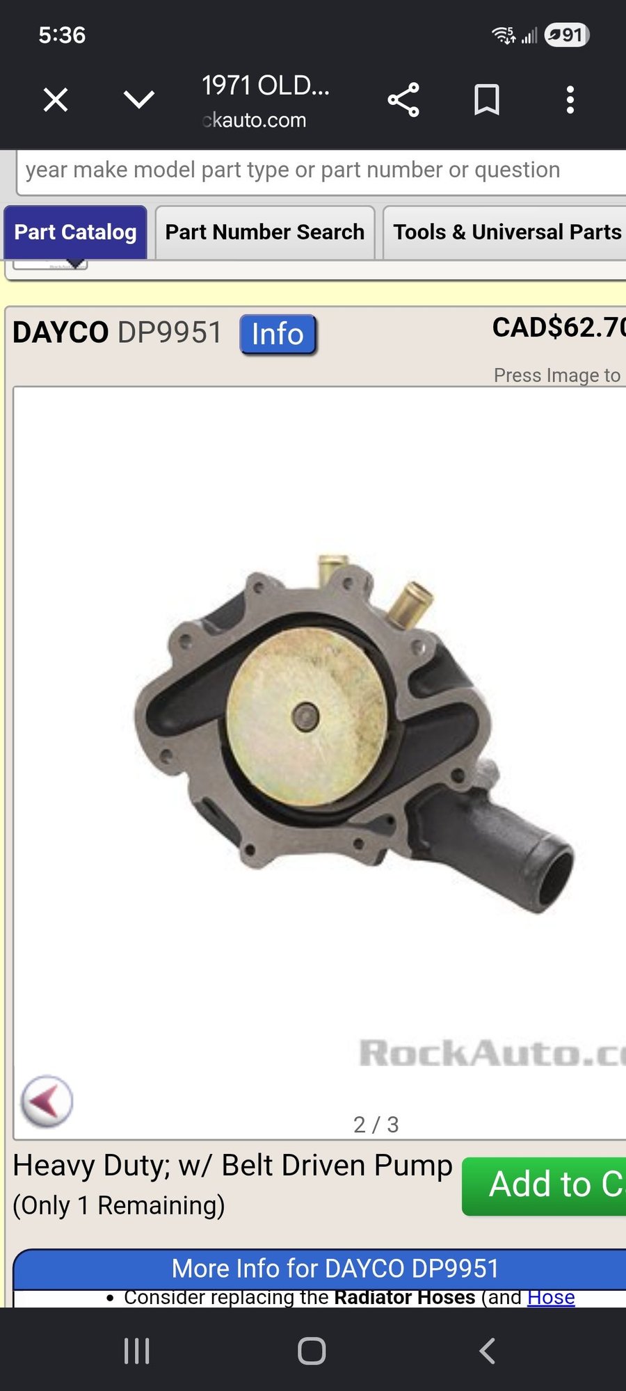

The Dayco water pump is the only with a closed impeller. Otherwise weight, some like GMB are aluminum or the best warranty is the way to go.

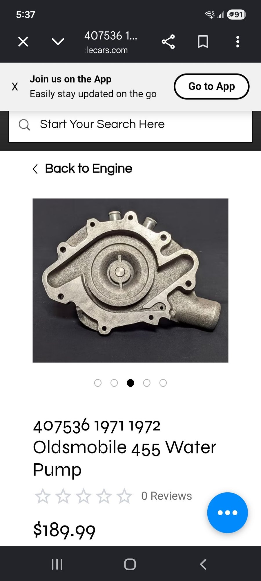

Yeah Fun 71 is one of our hot weather testers. But the 350 does run cooler than a 403 or 455 in your case. I also found nothing gained from my GMB modifed Flowkooler water pump. It is the old style with riveted plate on an open impeller. It made zero difference on my hot 403, learned a lot on my 88 Cutlass about cooling systems. The old Flowkooler plate on open impeller doesn't fit as tight as the factory closed impeller. I have the second to last made, Flowkooler reverse rotation water pump, no more cores available with their newer billet impeller looks impressive, who knows if it does anything. My understanding is the closed impeller isn't about flow, it is to help prevent cavatation. It is only the more expensive Dayco heavy duty water pump that has the closed impeller, looks like a dedicated impeller, not a riveted plate like my old GMB/Flowkooler which hasn't failed in 15 years. Here are screen shots of the Dayco heavy duty and Thornton. The stamped impeller look slightly different as well among the pumps on Rockauto. That Dayco heavy duty is only $45.75 your price in US dollars. The bottom pic is a cast iron pump that came on a 260 of all things.
