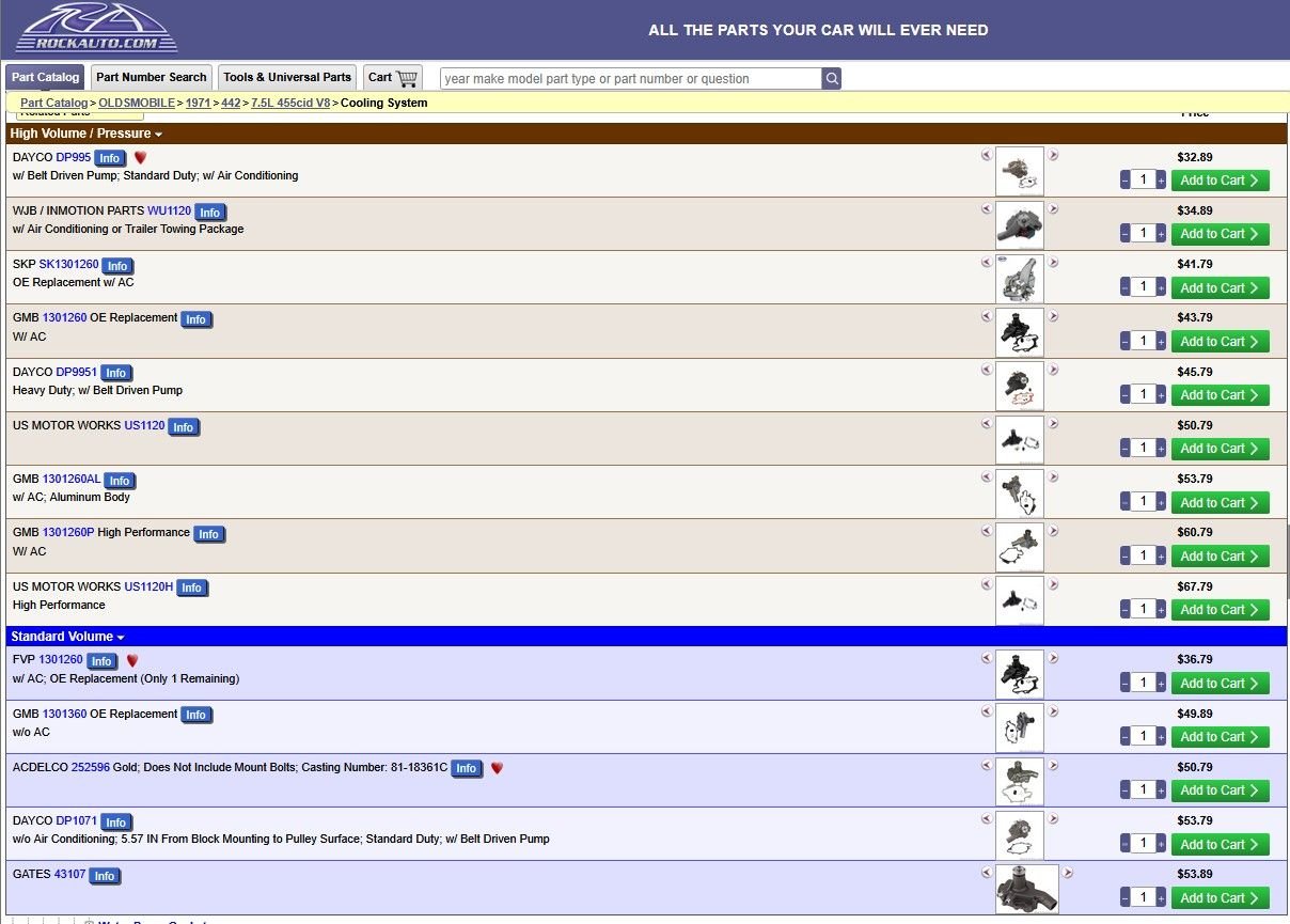

Not a restoration. Just looking for a functional water pump for a 1971 Cutlass 455 with AC.
What is your favorite brand from these Rock Auto Choices below?

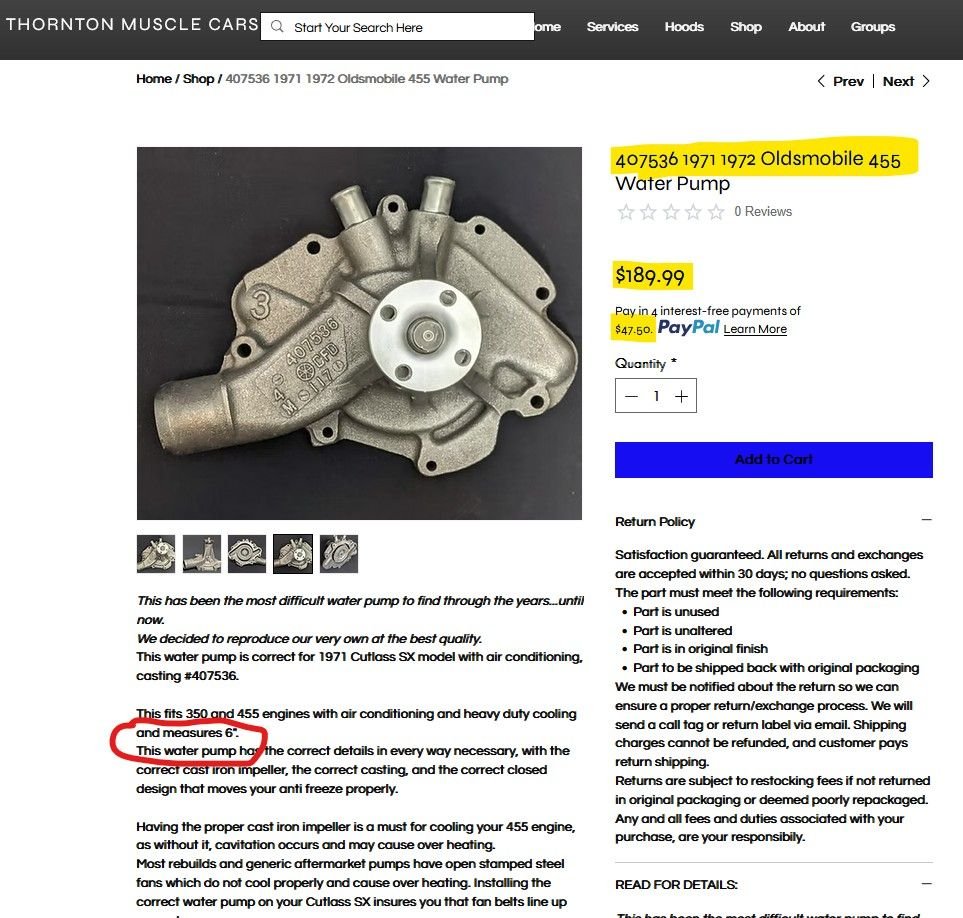

Yes, I know we all love Thornton (screenshot also below), but I am looking for something more budget friendly for this particular car.

The Dayco water pump is the only with a closed impeller. Otherwise weight, some like GMB are aluminum or the best warranty is the way to go.
Old Yesterday | 09:44 PM
Posts: 15,375
I have a parts store stamped steel open impeller water pump on my car and originally I had some concerns but it had no issues keeping the engine cool in our 110+ summer heat with the AC on.

GMB / Milodon aluminum pump (i.e. GMB apparently makes it under both their own name and Milodon) has been my choice - direct fit, great performance.
I doubt Thornton makes their own pump so they may just be selling a rebranded GMB piece stamped with part# markings to Thornton's spec... If that's the case, go with best overall pricing (i.e. check Summit / Jegs as well as Rock Auto, etc.)
