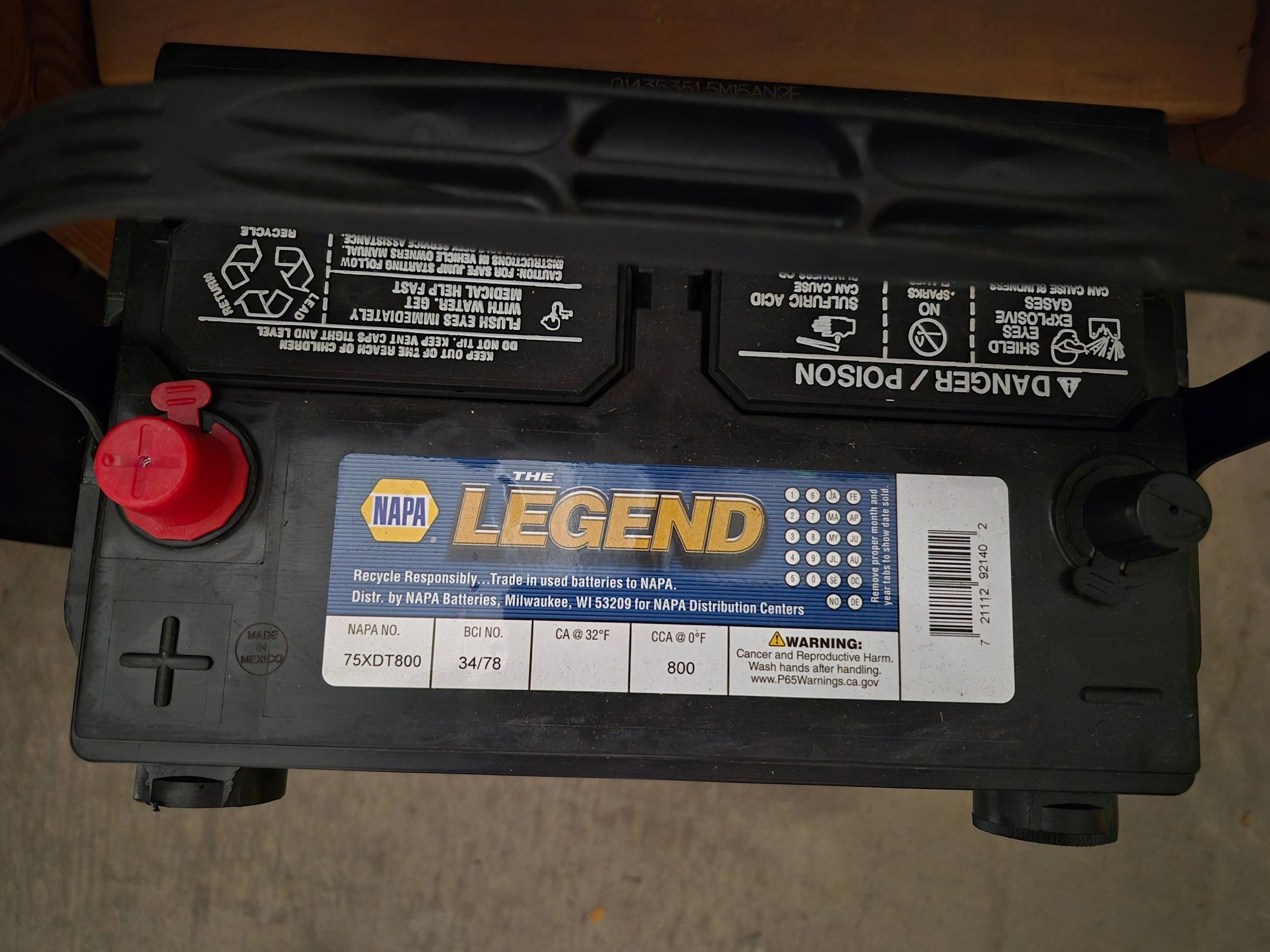

Originally Posted by Az697175
I've been having pretty good luck the past few years with the Napa Legend batteries. I just recently picked up another one for my '94 GMC. A bit pricey but some (not all) of them are made in USA.
I just had one of these NAPA batteries last less than two years in my 87 Mustang. The car probably has less than 100 miles on it in that period.
I stopped at NAPA today to see if there's anything they'd do (they didn't). I bought it in April of 2024 and it had an 18 month warranty. I got nothing except a new AAA battery with a 3 year warranty for less money than I paid for the NAPA battery.
