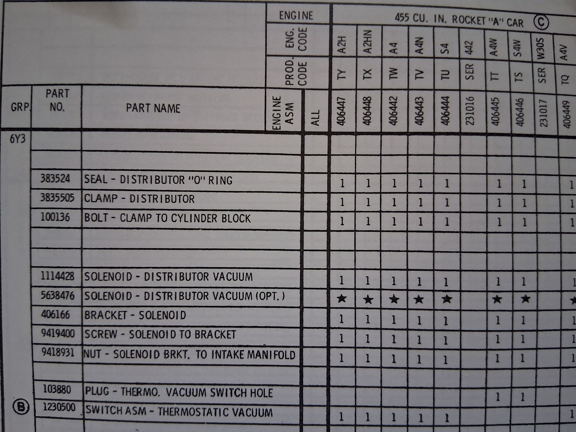

Old Today | 01:33 PM

Also in the 1970 PIM:
Near the bottom, right corner look at the four squares at the intersection of parts 103880 and 1230500 with product codes TT and TS (W-30 Auto and SM).
It shows no vacuum switch and a plug in the hole.
Elsewhere in the PIM, the plug shows as having a square head.
