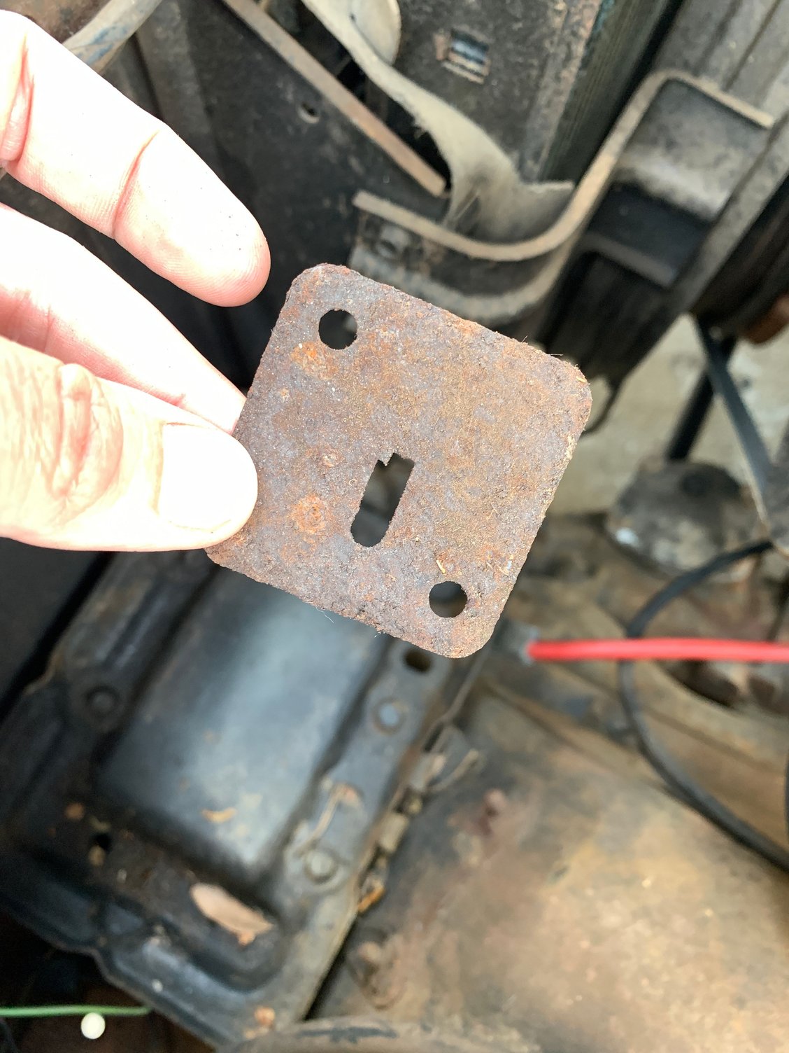

I was changing the batter on the 65 and found this floating around in the battery tray.
It's shape looks slightly familiar...but I have no clue.
-peter
Old Mar 30, 2021 | 02:13 PM
I'm thinking that's a retainer for the underhood insulation blanket. Looks like the center barb rusted off.
Old Mar 30, 2021 | 06:52 PM
Posts: 6,105

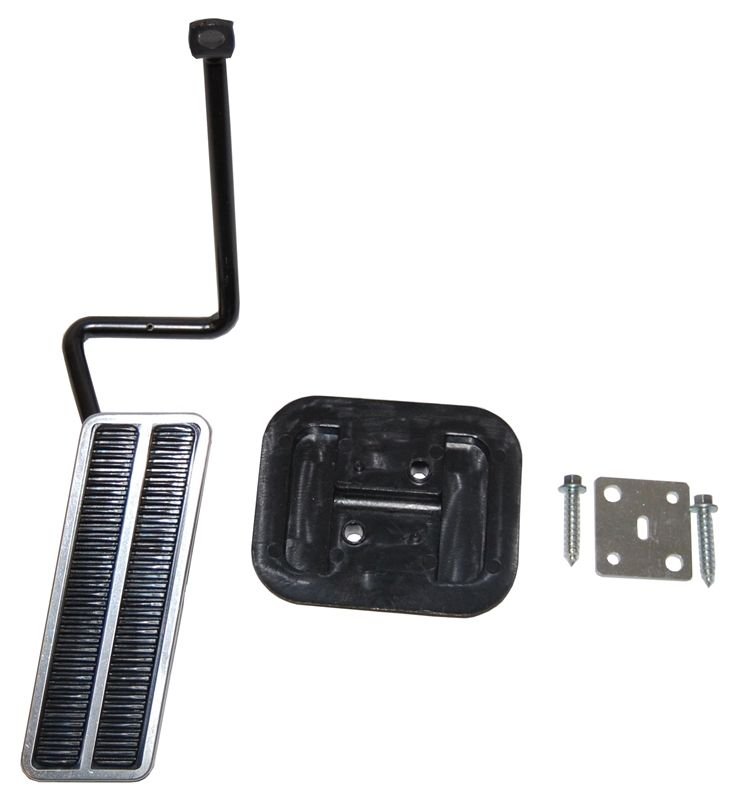

That looks like the plate that retains the gas pedal linkage to the pivot under the dash. If it is that part, its a long way from where it should be.
Old Mar 30, 2021 | 06:55 PM
It's also a long way from 1968 (the first year Olds used a cable accelerator pedal) if the OP's car is a 1965. Note that the plate has four holes, two for screws and two for the locating pins.

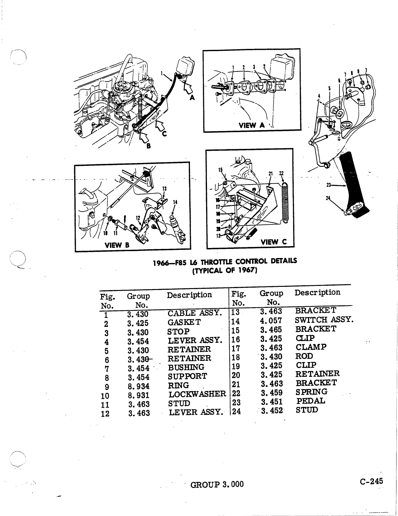

I know Joe is the king of all Olds parts application, but the 67 F85 with a six cylinder engine also used a cable accelerator.
Old Mar 31, 2021 | 08:06 AM
Still not a 1965.
Also, the 66-67 L6 cable throttle setup does not use the 68-72 style accelerator that I posted above and does not use that square plate that was being discussed.

Joe, this is what you posted. 1968 (the first year Olds used a cable accelerator pedal) This is what I based my post on.
Old Apr 1, 2021 | 05:17 AM
Ed,
I'm not arguing and I appreciate you pointing that out. My point was that the 66-67 cable throttle systems didn't use the square plate in the accelerator pedal mount that was being referred to until the 1968 model year. I could have been clearer about that.
Old Apr 1, 2021 | 05:44 AM
Posts: 6,105
I forgot the earlier cars used the throttle linkage. I knew the later cars with the plate held the throttle pedal in place by 2 screws, slipped my mind about the 2 alignment holes.
