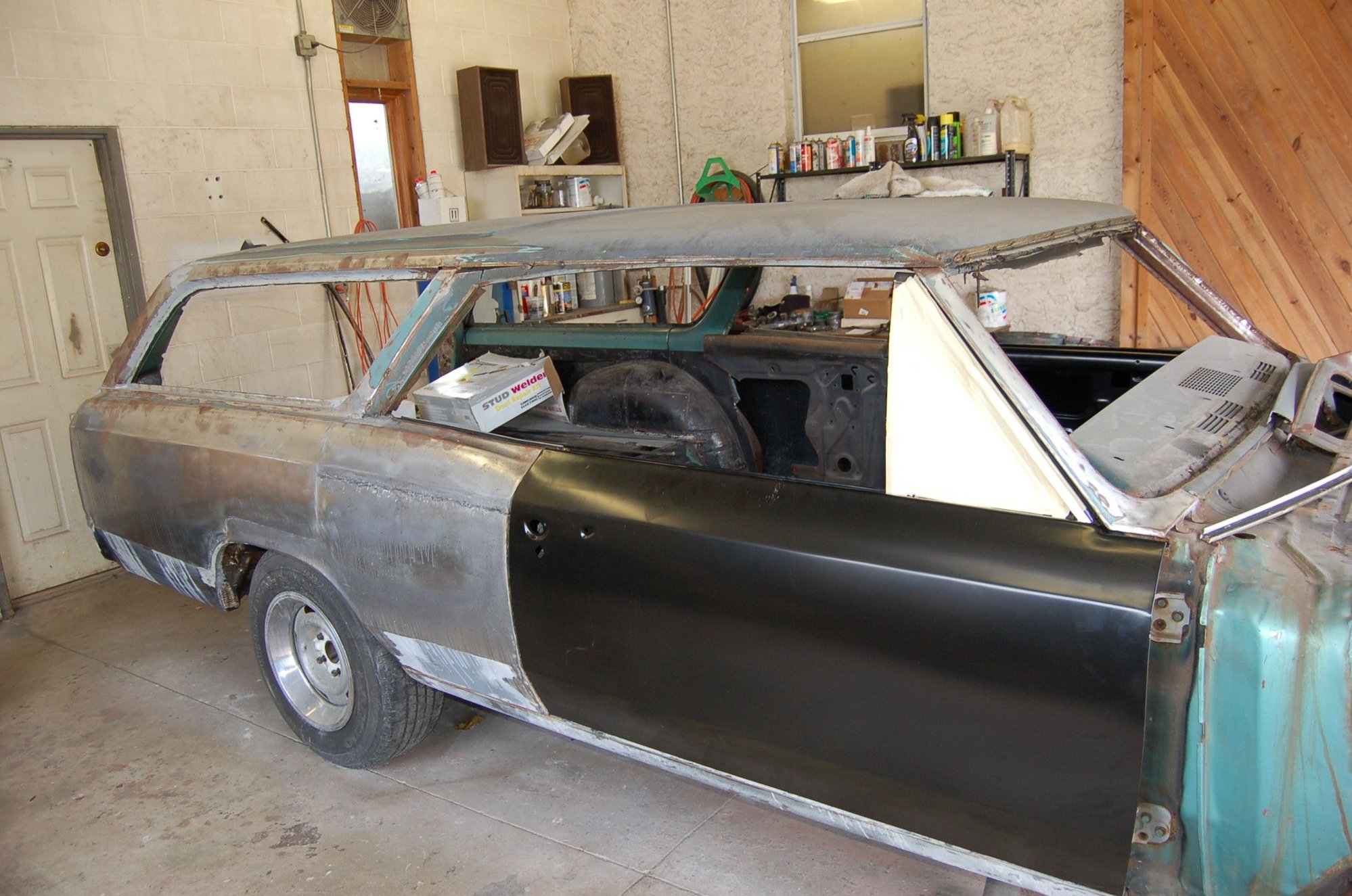

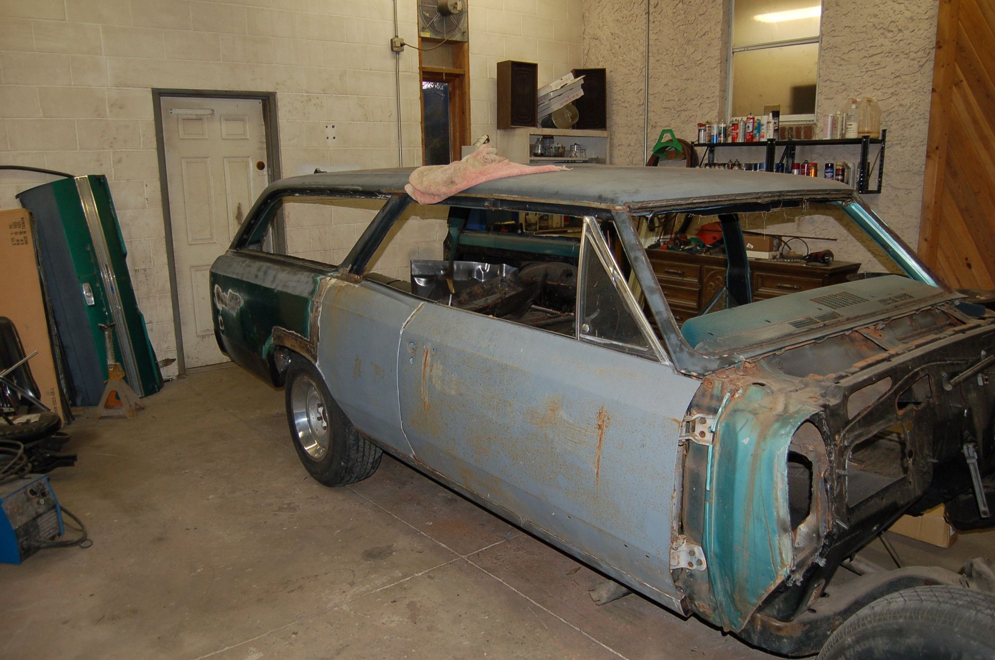

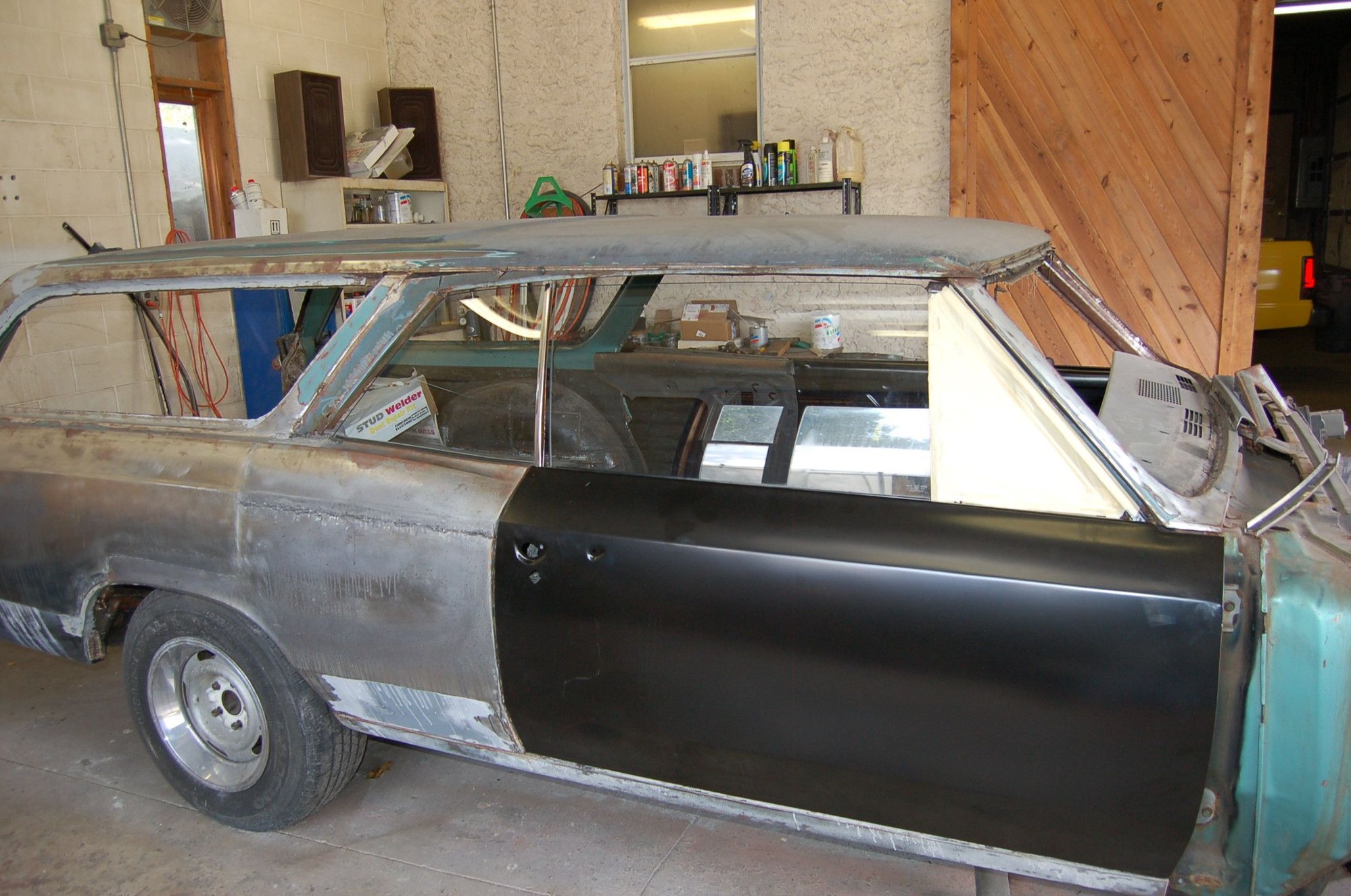

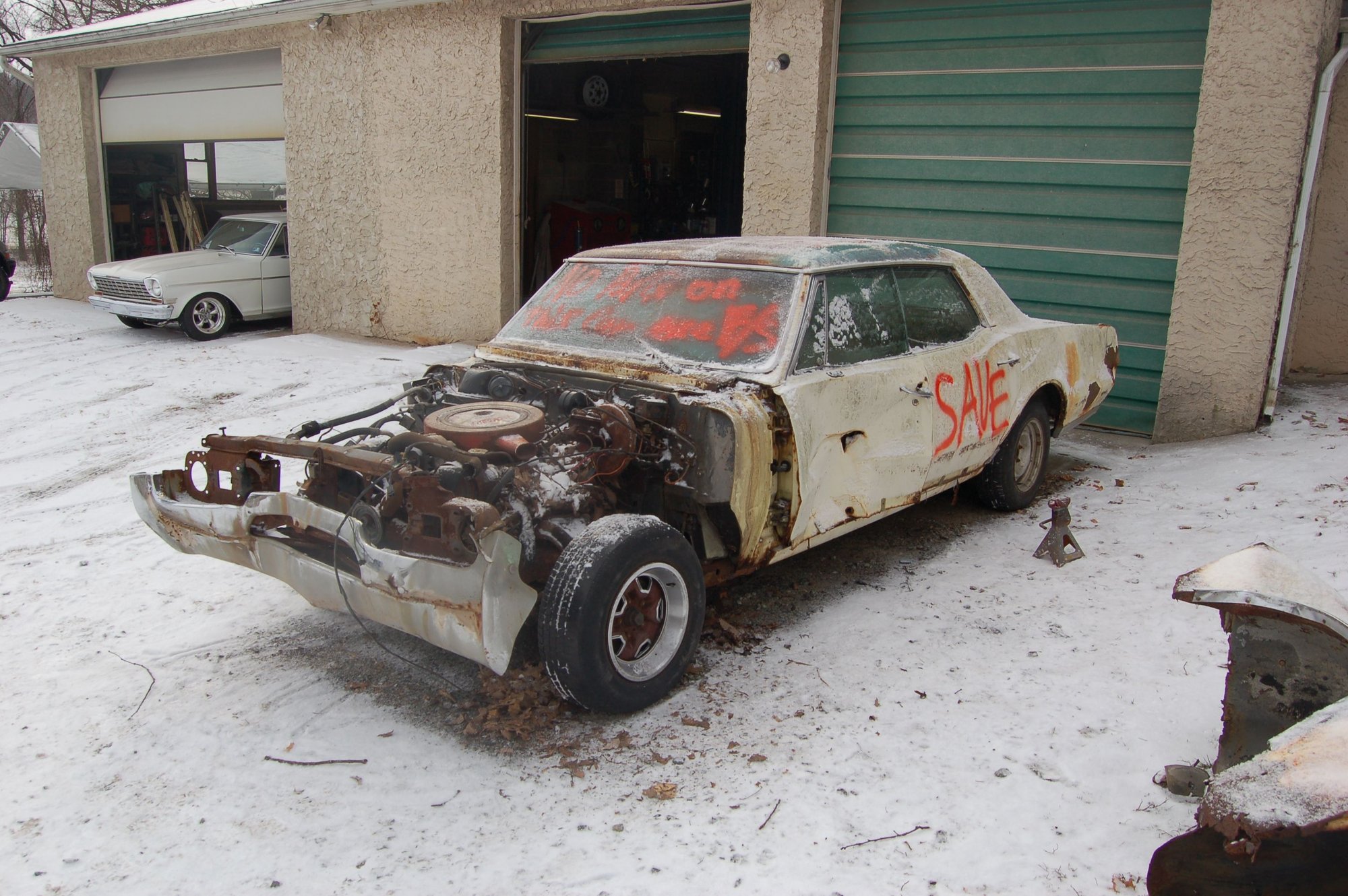

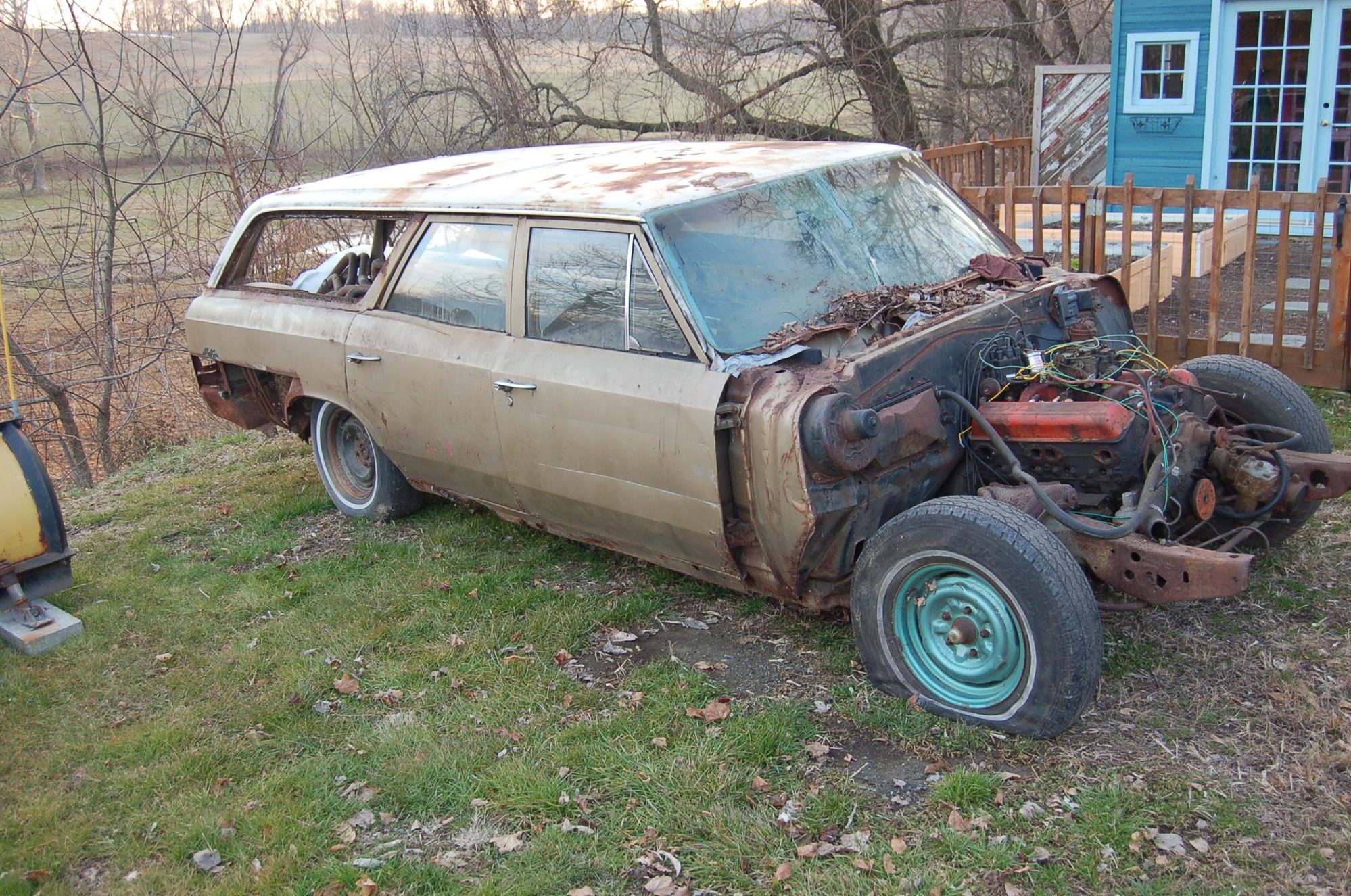

Here are some pics to help visualize:
This is a 67 4 door hardtop I bought to make a 66 chevelle 4 door hardtop wagon:
Here is a stock 66 A-body wagon roof line:
Here is a mock up of a 66/67 2 door hardtop roof line on my 66 chevelle 2 door hardtop wagon project. Notice how different the angles are. Originally, I planned to use the 66/67 roof line, but decided even after all the work of changing the front roof area, the C-pillar would never look right. So, I decided to use a 64/65 hardtop roof line and glass instead.
The windshield angle was the same across all 65 body styles so the angles were not a problem.
This might be more info than you needed, but the simple answer is no. 2 door hardtop and 4 door hardtop are not the same. Both due to the windshield angle and the fact that that the 4 door hardtop wing window does not go as far back along the door.
